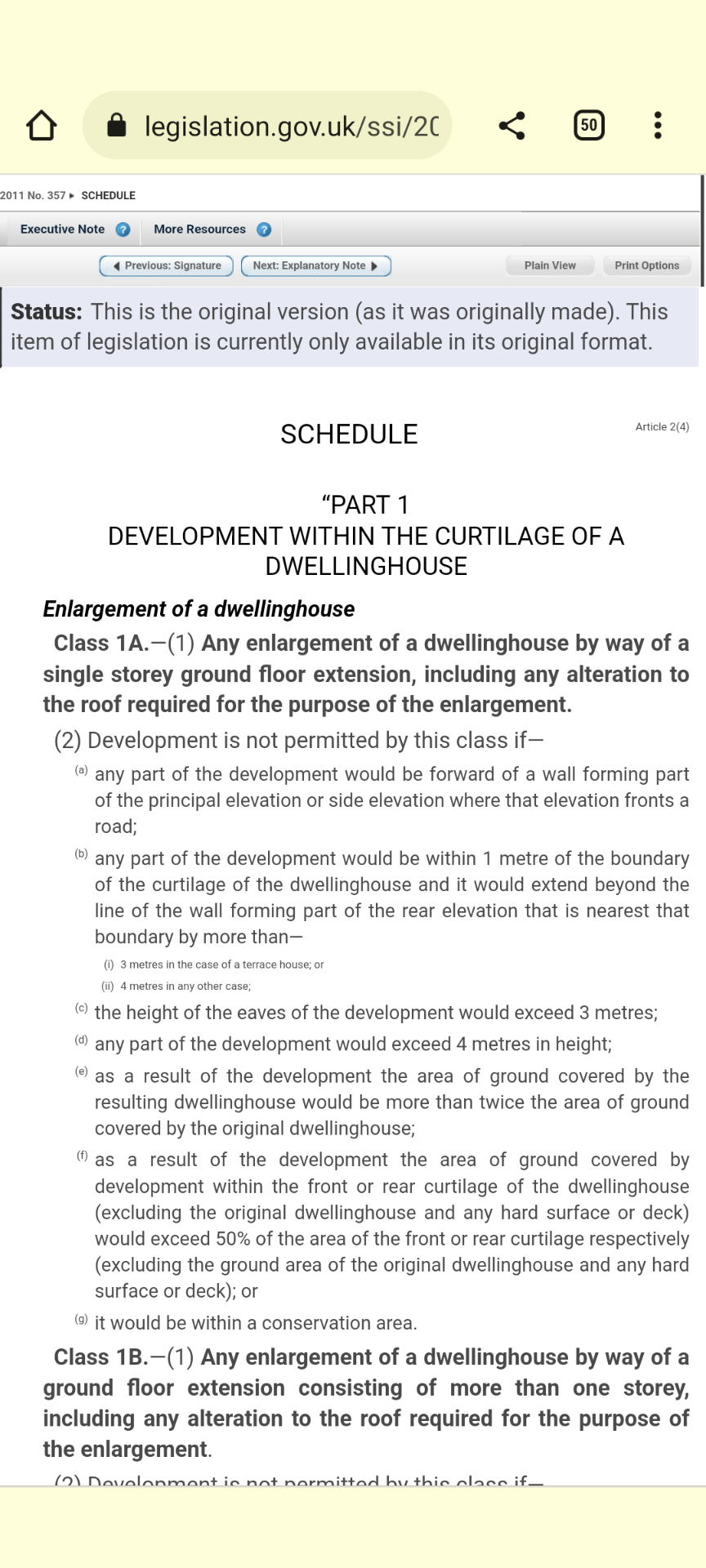

Y555SLD Posted October 20, 2022 Share Posted October 20, 2022 I've always had it in my head that the maximum distance from the existing rear elevation for an extension within PD was 4m for detached houses and 3m for semis/terraced across the board. However reading the guidance in more detail, it appears that these limits are only applicable when building within 1m of the boundary: Does this mean, that as long as I am more than 1m from the boundary and meet all other criteria points (floor area, curtilage area, heights etc.) I can extend back from the rear elevation an unlimited distance? Thanks Link to comment Share on other sites More sharing options...
ash_scotland88 Posted October 21, 2022 Share Posted October 21, 2022 What it is saying is its 4m if you're semi or detached (the any other case), but only 3m if terraced and the extension is within 1m of the boundary. Now I think there's a 10m (or 5m) boundary rule too. Link to comment Share on other sites More sharing options...
Temp Posted October 21, 2022 Share Posted October 21, 2022 I've just read the rules here.. https://www.gov.scot/publications/guidance-householder-permitted-development-rights-9781780456836/pages/6/#SingleStoreyGroundFloorExtension and there are two sections that explain this.. Quote 4.11 snip if the extension is on, or within 1 metre of the boundary, it cannot project, from the rear wall of the existing dwellinghouse, by more than 3 metres in the case of terraced house, or 4 metres in all other cases Quote 4.17 If any part of the extension is within 1 metre of the boundary of the curtilage, it can only project from the line of the rear elevation nearest to the boundary by 3 metres if a terraced house or 4 metres in any other case. It certainly appear to be the case that the 3 and 4m limits only apply to extensions that are within 1 meter of the boundary. There is also a rule limiting the area of the garden that can be built on which might come into play. Quote the footprint of the extension is no larger than the original dwellinghouse or covering more than half the curtilage Link to comment Share on other sites More sharing options...

Temp Posted October 25, 2022 Share Posted October 25, 2022 (edited) I questioned the appearance and disappearance of the 1m rule... My email to.. Chief.Planner@gov.scot Quote Dear Sir, On this page (https://www.gov.scot/publications/householder-permitted-development-rights-guidance-updated-2021/pages/6/#EnlargingADwellinghouse) dated April 2021.. Section 4.11 states.. "if the extension is on, or within 1 metre of the boundary, it cannot project, from the rear wall of the existing dwellinghouse, by more than 3 metres in the case of terraced house, or 4 metres in all other cases". When was the 1 meter rule reintroduced? On this page (https://www.mygov.scot/add-extension-house) dated Sept 2020 it doesnt mention the 1 meter rule, only the 3m or 4m rule. On this page https://www.gov.scot/publications/guidance-householder-permitted-development-rights-9781780456836/pages/6/#SingleStoreyGroundFloorExtension dated June 2016 it does mention the 1m rule. Which one is correct/current? The reply.. Quote Dear Colin Thank you for your enquiry. Thanks for drawing this to our attention. The short answer is that the 1m rule was never removed or re-introduced. The guidance in the Circular and on the Scottish Government website dated June 2016 is correct. I agree that the information on the mygov.scot website omits the reference to the 1m rule. My apologies for this, I will contact the mygov.scot website and arrange for this to be corrected. Kind regards (Name Redacted) Policy Manager, Development Management Planning, Architecture and Regeneration Division Scottish Government If anyone wants to ask the more important question thats the email to write to. Edited October 25, 2022 by Temp Link to comment Share on other sites More sharing options...

andyscotland Posted October 25, 2022 Share Posted October 25, 2022 5 hours ago, Temp said: But that's not quite what this says... https://www.edinburgh.gov.uk/downloads/file/25402/quick-guide-to-house-extensions And as far as I can see that matches the legislation (I'm pretty sure https://www.legislation.gov.uk/ssi/2011/357/schedule/made is the current rules for extensions): The projection limit is only specified in clause 2b, and would appear fairly definitely only to apply if the boundary condition is triggered. I guess that does make some sort of logical sense : you can put an outbuilding at any distance from the house, and there is no limit to the length of it so long as it doesn't cover 50% of the curtilage. So if legally you'd be allowed a long thin shed all the way to 1m before the back fence, there wouldn't be much difference putting an extension on that footprint. Link to comment Share on other sites More sharing options...
