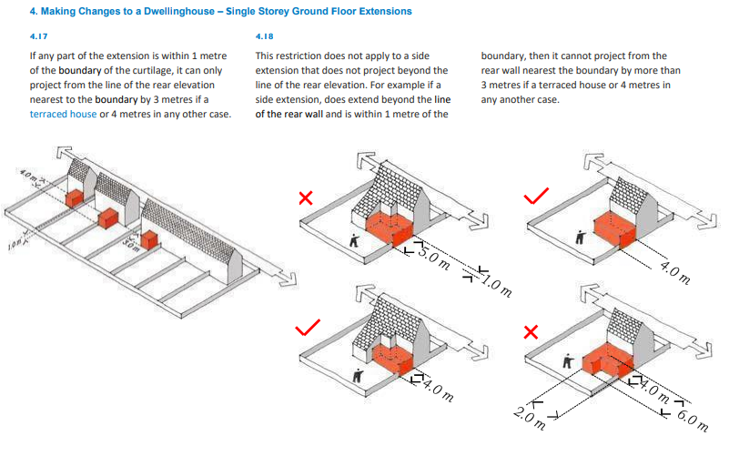

  1. I've always had it in my head that the maximum distance from the existing rear elevation for an extension within PD was 4m for detached houses and 3m for semis/terraced across the board. However reading the guidance in more detail, it appears that these limits are only applicable when building within 1m of the boundary: Does this mean, that as long as I am more than 1m from the boundary and meet all other criteria points (floor area, curtilage area, heights etc.) I can extend back from the rear elevation an unlimited distance? Thanks
