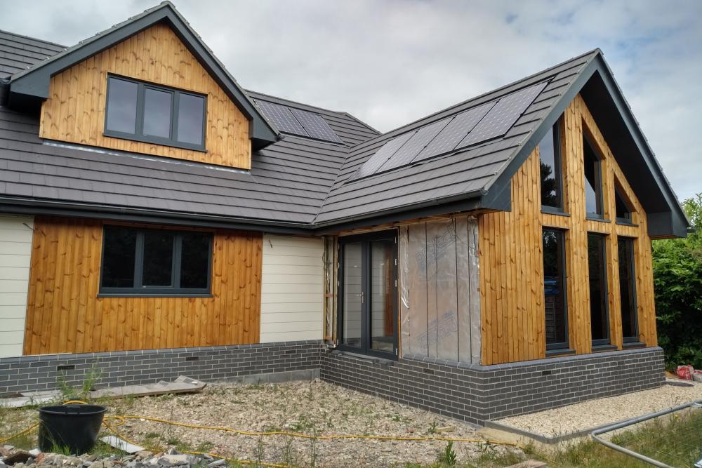

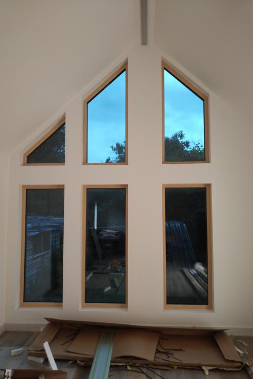

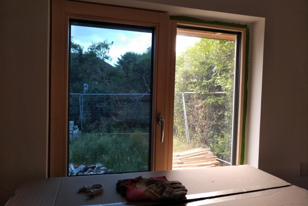

Tim Alsop Posted July 24, 2021 Posted July 24, 2021 On 23/06/2017 at 21:02, NSS said: Full price at the time of ordering was circa ₤1k/m2 for the rectangular IGUs and double that for the shaped ones, plus about ₤2k for the control panel, switching, etc, and another ₤2.3k for shipping and commissioning, but I hasten to add I paid nothing like those numbers and you have also to deduct the cost of the glass that would have been supplied by Internorm. I am also in Hampshire (Basingstoke) and considering SageGlass. Can you let me know which glass thickness you used for fitting in Internorm frame ? Also, did your Internorm UK partner fit the glass or did you have to get glass fitted by a different company after frame is installed ? Would love to hear more details. Thanks in advance, Tim.
NSS Posted July 25, 2021 Author Posted July 25, 2021 Hi Tim This is the makeup of our IGUs. 4mm heat strengthened SR2.0 + 0.9mm SentryGlas® lonoplast interlayer + 2.2 mm SageGlass® coated outboard lite 15.5mm black stainless steel spacer, black silicone, black PIB, argon filled 4mm heat strengthened 15.5mm black stainless steel spacer, black silicone, black PIB, argon filled 6mm heat strengthened inboard lite Total Thickness = 48.1mm Glass was installed by the same crew from Ecohaus Internorm that installed the frames. Hope that helps and feel free to ask if you have any further queries.
NSS Posted July 26, 2021 Author Posted July 26, 2021 On 24/07/2021 at 14:38, Tim Alsop said: I am also in Hampshire (Basingstoke) and considering SageGlass. Can you let me know which glass thickness you used for fitting in Internorm frame ? Also, did your Internorm UK partner fit the glass or did you have to get glass fitted by a different company after frame is installed ? Would love to hear more details. Thanks in advance, Tim. Hi Tim This is the makeup of our IGUs. 4mm heat strengthened SR2.0 + 0.9mm SentryGlas® lonoplast interlayer + 2.2 mm SageGlass® coated outboard lite 15.5mm black stainless steel spacer, black silicone, black PIB, argon filled 4mm heat strengthened 15.5mm black stainless steel spacer, black silicone, black PIB, argon filled 6mm heat strengthened inboard lite Total Thickness = 48.1mm Glass was installed by the same crew from Ecohaus Internorm that installed the frames. Hope that helps and feel free to ask if you have any further queries. NB. Posted again quoting Tim's post in case not seen. Mods, please feel free to delete previous post.
