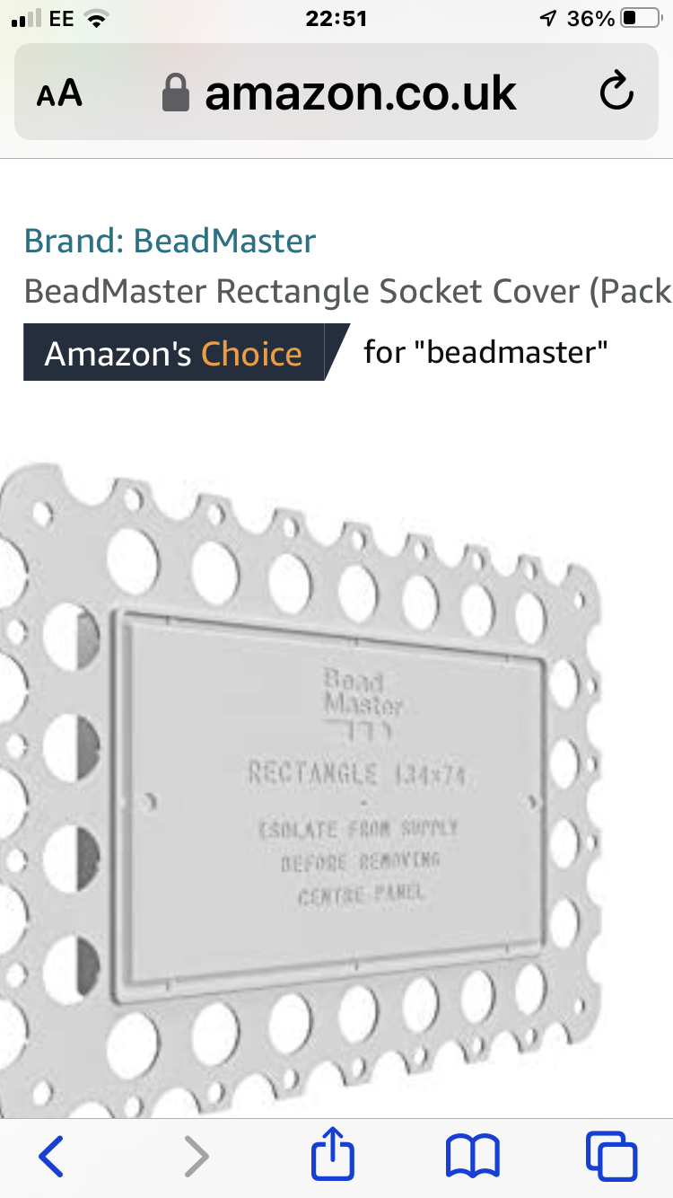

Posted
I buy these by the thousand
Some companies won’t pay the extra most do 0 patching very tidy finish
Simply skim over them 30 minutes per house to fit
Boarders are happy everything tooled into boxes Electricians love them
