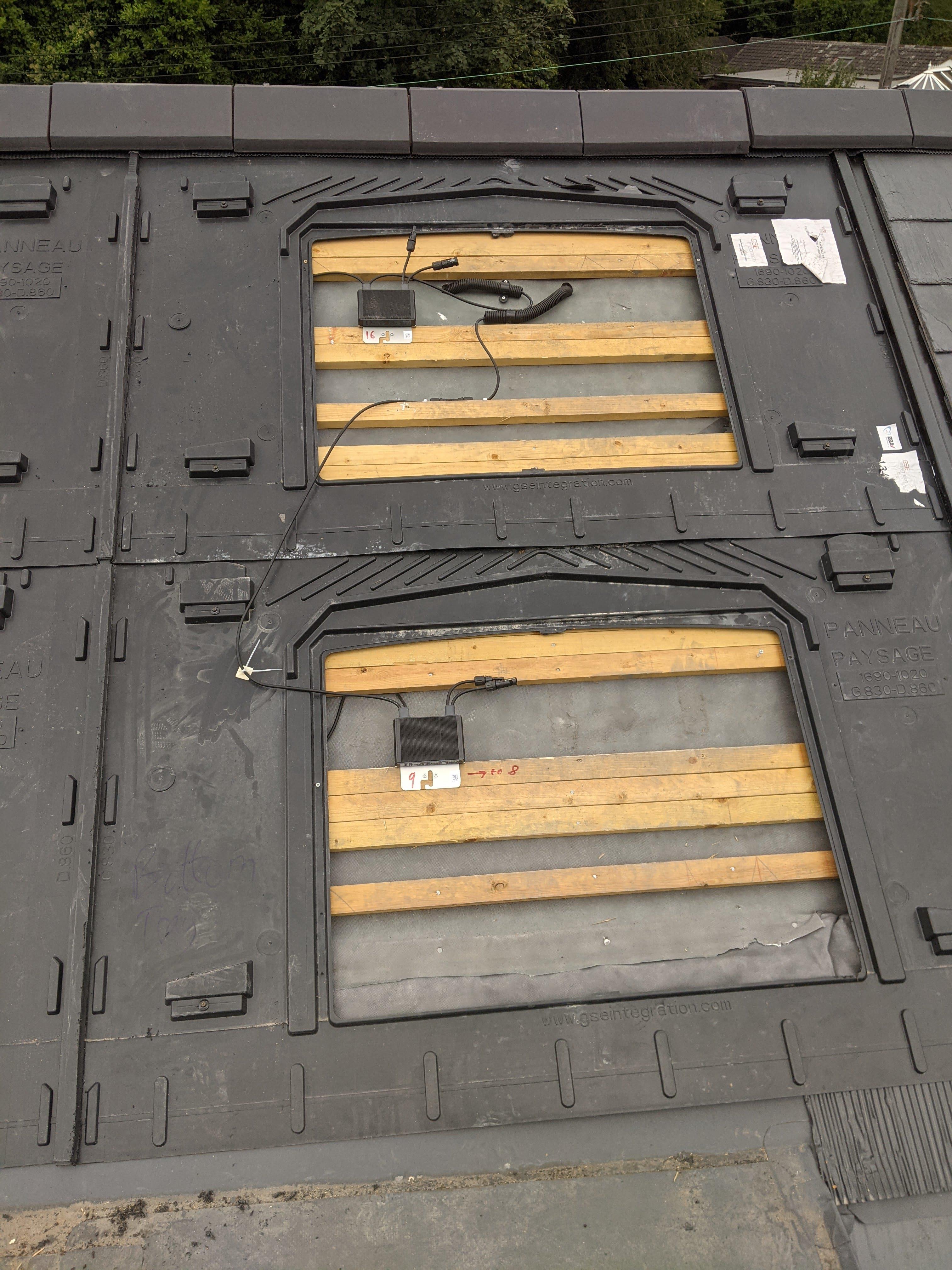

On the 25mm roofing battens. My roof though is a thermohouse panel system and is counter-battened, so I've a 25mm void under the felt as well as over.
The drainage ridges in the trays are about 10mm high or so and that keeps the panels off the plastic and provides the ventilation gap. Plus whatever airflow come from under/over the roofing felt - I've continuous soffit vents and dry ridge. Image below is an unusual section where the trays met a flat roof (flashed 300mm under) but again, the flat roof is counter-battened and vented.
Edited by Conor
  • Like 1
Posted
Picture paints... thanks for that Conor

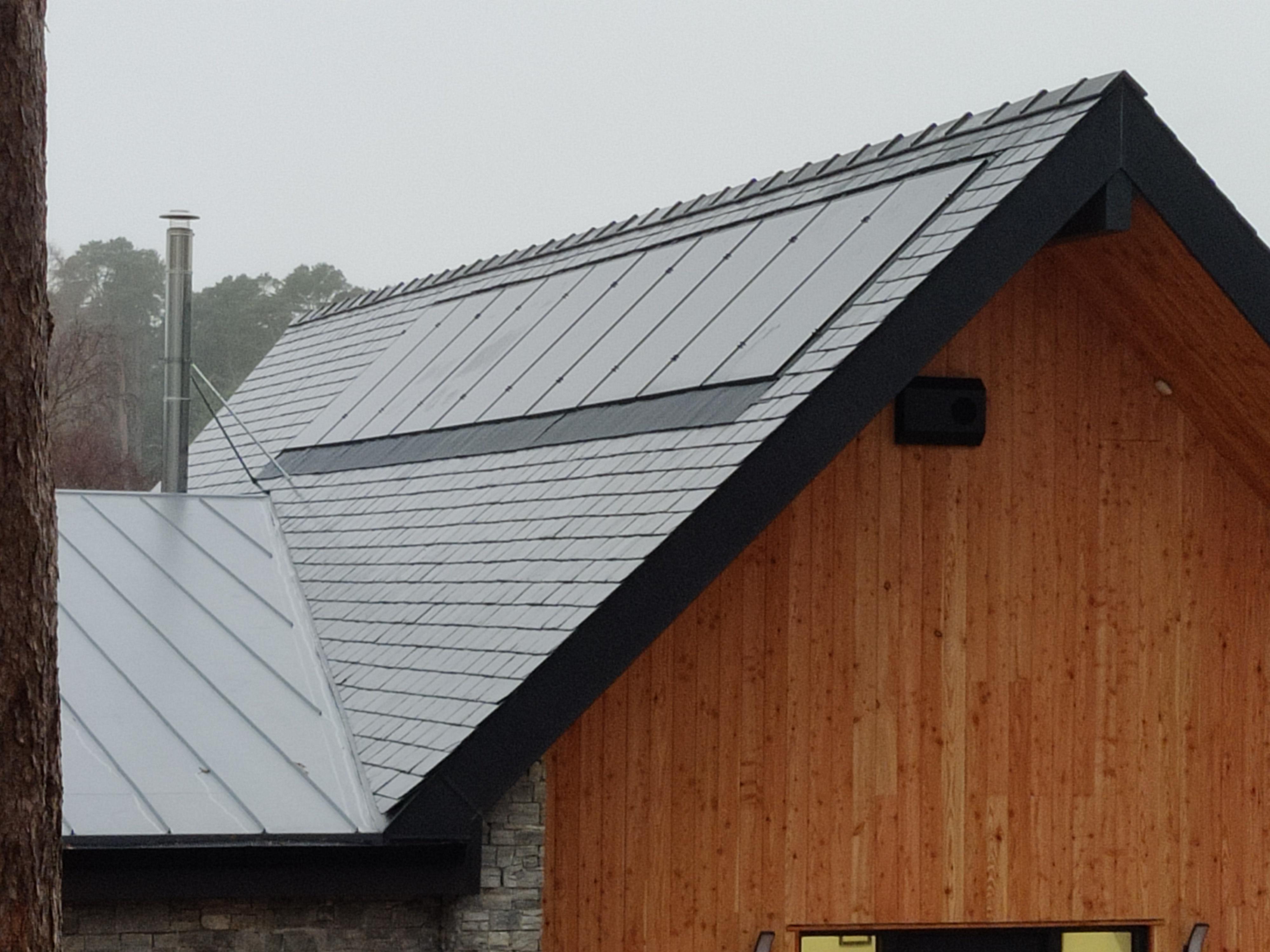

No battens under mine, but the membrane has sarking boards below it.  Scottish roof design with slate is different from the rest of the UK, due wind loading being higher.
Still managed to get just over 3.1kW recorded at the hieght of summer from a 3.1kW system.
IMG_20210303_155056.thumb.jpg.650f6d849c8283b67d5d2b72d7b00c87.jpgIMG_20220114_085531.thumb.jpg.dfffc2013963b1ee3fa1ca2c988b24d3.jpg
  • Like 2
Posted
Panels look tidy John also where both roof coverings meet.
