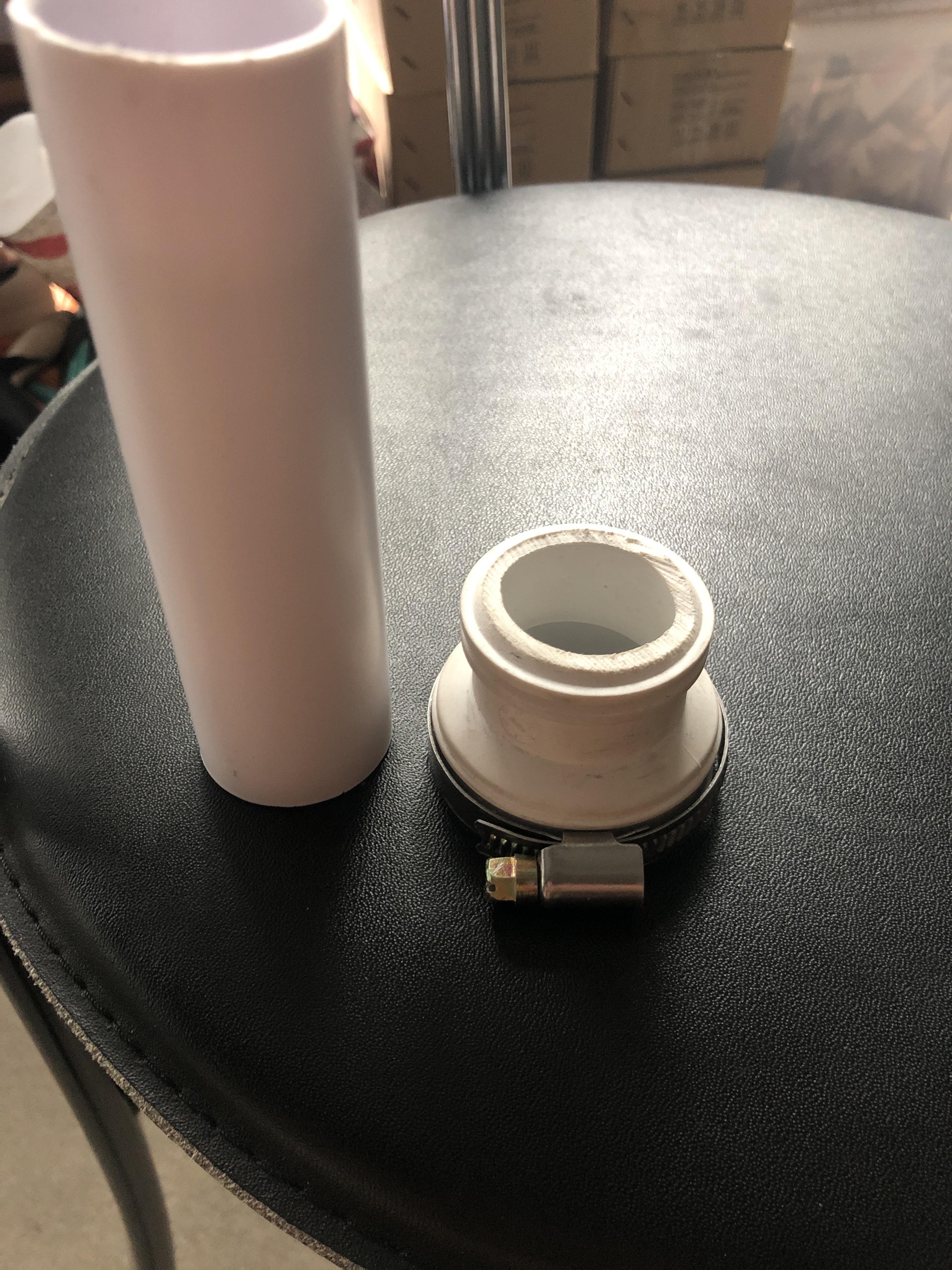

Pocster Posted October 6, 2022 Posted October 6, 2022 (edited) Grrr 😡  32mm pipework everywhere ( 36mm outer ) . Saniflo fitting ; pipe too large I.e needs to be 32mm internal . Saniflo phone call confirms this . So I need a very short length of 32mm external . Any brands where this is true ? - floplast it certainly isn’t .  Or is this a push fit pipe v’s solvent weld size difference ?? Edited October 6, 2022 by pocster
Carrerahill Posted October 6, 2022 Posted October 6, 2022 (edited) What is the coupling on the sani? Compression? Â I think solvent weld is 36mm OD but push fit pipe is smaller... Â Edited October 6, 2022 by Carrerahill
Pocster Posted October 6, 2022 Author Posted October 6, 2022 Just now, Carrerahill said: What is the coupling on the sani? Compression?  Yes Â
Carrerahill Posted October 6, 2022 Posted October 6, 2022 1 minute ago, pocster said: Yes  I'd have thought it would have taken the 36mm as the compression is often the open used when going from solvent to pushfit change over.  I think you will find pushfit pipe will fit.Â
Pocster Posted October 6, 2022 Author Posted October 6, 2022 Found this  https://www.ondemandsupplies.co.uk/plumbing-blog-on-demand-supplies/why-does-waste-pipe-come-in-different-sizes-32mm-and-36mm-40mm-and-43mm/  So still must find presumably 32mm (external )push fit pipeÂ
Carrerahill Posted October 6, 2022 Posted October 6, 2022 (edited) Just now, pocster said: Found this  https://www.ondemandsupplies.co.uk/plumbing-blog-on-demand-supplies/why-does-waste-pipe-come-in-different-sizes-32mm-and-36mm-40mm-and-43mm/  So still must find presumably 32mm (external )push fit pipe https://www.screwfix.com/p/floplast-push-fit-pipe-white-32mm-x-3m/26334 that must fit - surely Sani don't make it so damn awkward?!? Edited October 6, 2022 by Carrerahill
Pocster Posted October 6, 2022 Author Posted October 6, 2022 (edited) 2 minutes ago, Carrerahill said: https://www.screwfix.com/p/floplast-push-fit-pipe-white-32mm-x-3m/26334 that must fit - surely Sani don't make it so damn awkward?!? Funnily enough the saniflo guy checked exactly that . It just says 32mm so internal / external ? . its floplast so assume 36mm external - which is too large .. Edited October 6, 2022 by pocster
Carrerahill Posted October 6, 2022 Posted October 6, 2022 (edited) 5 minutes ago, pocster said: Funnily enough the saniflo guy checked exactly that . It just says 32mm so internal / external ? . its floplast so assume 36mm external - which is too large .. Floplast solvent is 36mm but pushfit is smaller.  From floplast:   32mm is a nominal size. There is a tolerance allowed within the pipe dimensions so the internal diameter is between 29.6mm - 31.2mm and the outside diameter is between 34.4mm - 34.8mm. Edited October 6, 2022 by Carrerahill
Pocster Posted October 6, 2022 Author Posted October 6, 2022 No (expletive deleted)ing plumbers on this forum are there . I put the rubber fitting in boiling water . It’s the tightest rubber I’ve ever put on but does fit 😉 1

Pocster Posted October 6, 2022 Author Posted October 6, 2022 Whilst rummaging through my plumbing box ( not a euphemism ) I found 2 other poly pipe segments . No markings on them but a few mm difference on all of them .
joe90 Posted October 6, 2022 Posted October 6, 2022 I think I remember using an odd size pipe (push fit??) with difficulty into a compression fitting and needing a thinner rubber seal ring 🤔
