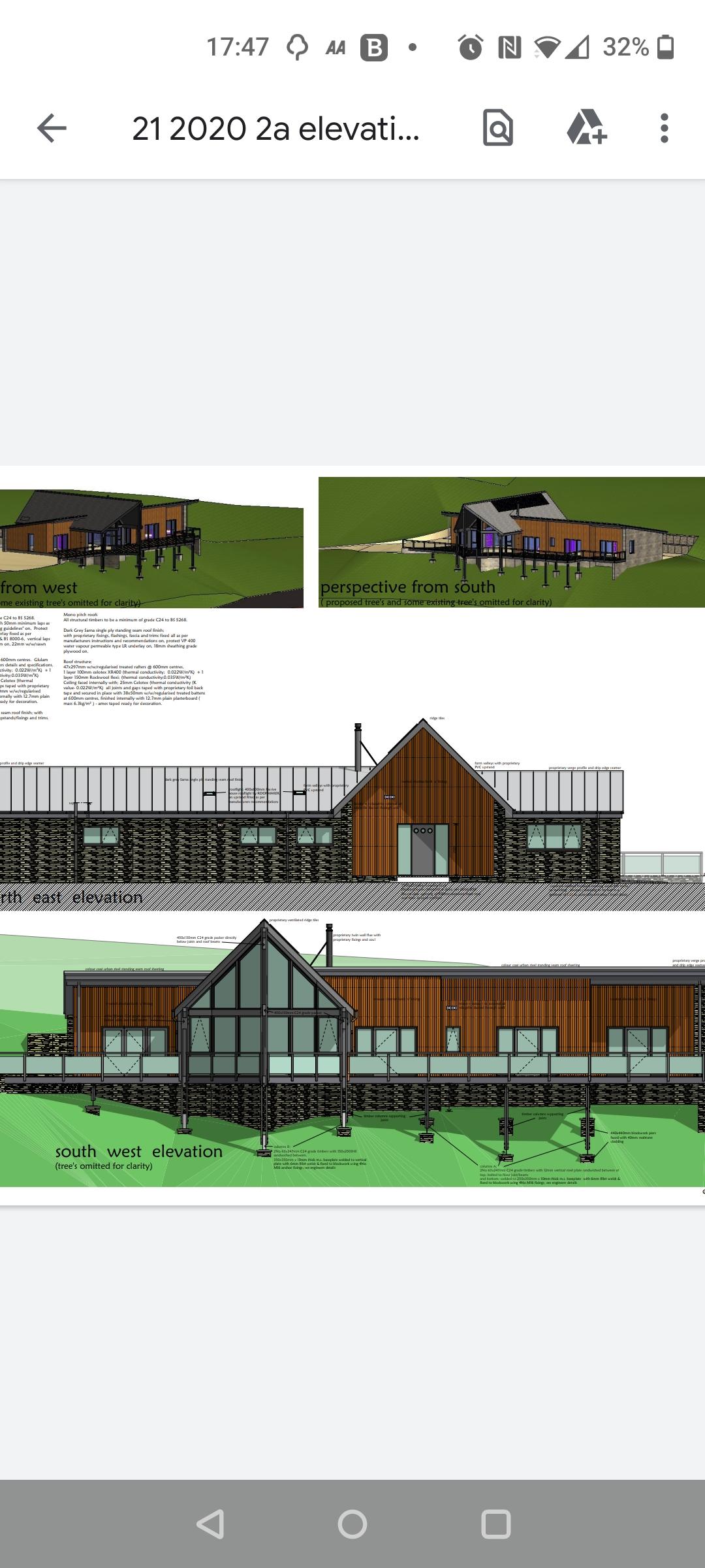

JohnMo Posted September 22, 2022 Posted September 22, 2022 I have just ordered glass balastrade, 26.5m long, that's is just under £9k that will give you a starter for ten. Photo of our planning drawing. Uprights are basically steel at top and bottom, sandwiched between wooden upright. Then lots of wood to build the structure.
JohnMo Posted September 22, 2022 Posted September 22, 2022 (edited) Why? Not in contact with soil, well ventilated, treated for external use. Top of wood will be further treated. Our 70s (sold in 2012) house had a wood balcony and 40 years later I had to repair a decking board. Edited September 22, 2022 by JohnMo More details

Ferdinand Posted September 22, 2022 Posted September 22, 2022 2 hours ago, JohnMo said: I have just ordered glass balastrade, 26.5m long, that's is just under £9k that will give you a starter for ten. Photo of our planning drawing. Uprights are basically steel at top and bottom, sandwiched between wooden upright. Then lots of wood to build the structure. That's a stilt village, not a balcony.

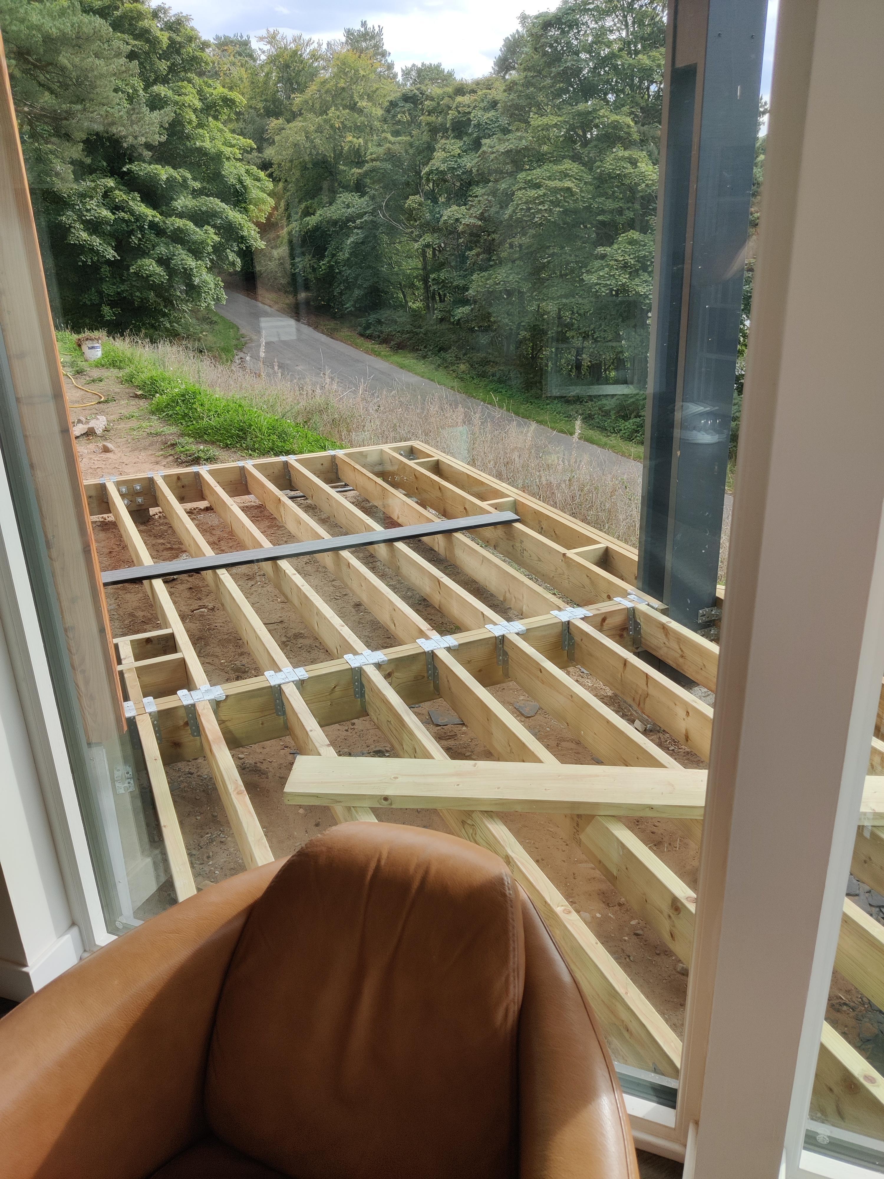

JohnMo Posted September 22, 2022 Posted September 22, 2022 It is big, keeping me busy. Roof overhangs most of it. Unfortunately as the sun moves west it still gets in during the summer. Structural work just about finished. Bitumen paint coating on top of the structural wood next week, if it's dry enough, then a big stack (210) of composite decking boards to install.

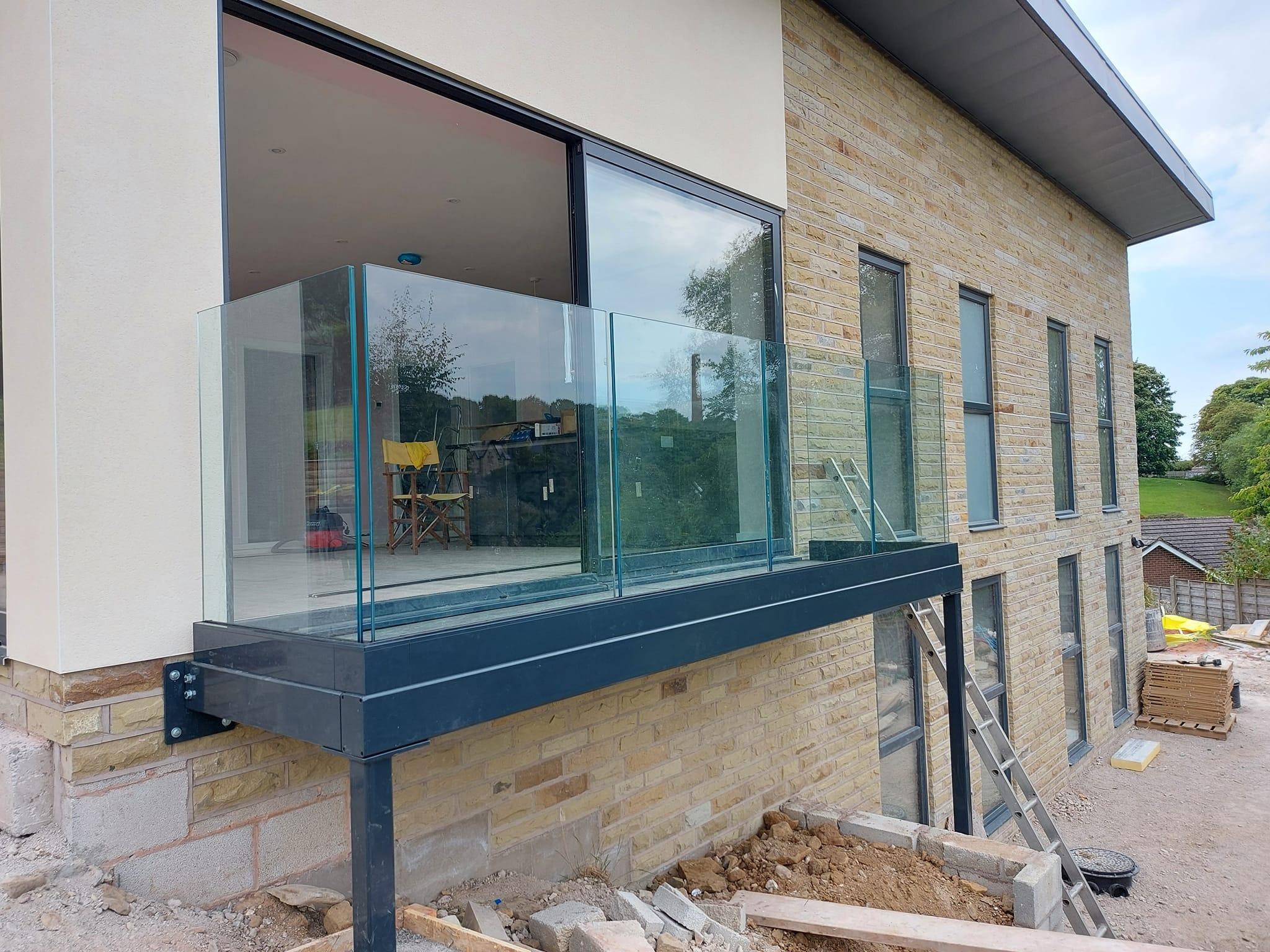

Happy Valley Posted September 22, 2022 Posted September 22, 2022 (edited) We have a "miserly" 4m x 1m balcony in steels with plastic anthracite cladding deck and bottom hung glass. Came from Diomet in Sheffield - who do many other sizes but maybe not to what you require. Ours cost around £5000 ex VAT excluding the labour to fit. Edited September 22, 2022 by Happy Valley
