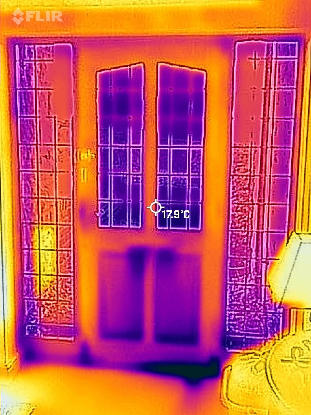

Radian Posted September 20, 2022 Posted September 20, 2022 How do timber doors perform thermally compared to UPVC or composite? I imaged our timber front door back in early February while trying to remedy drafts and was surprised at how well the thicker parts were performing: Only the thinner infill panels and letterbox were letting it down badly - and especially the gaps at the bottom. These are areas that I could do with improving. It was 19oC indoors and -2oC outdoors.

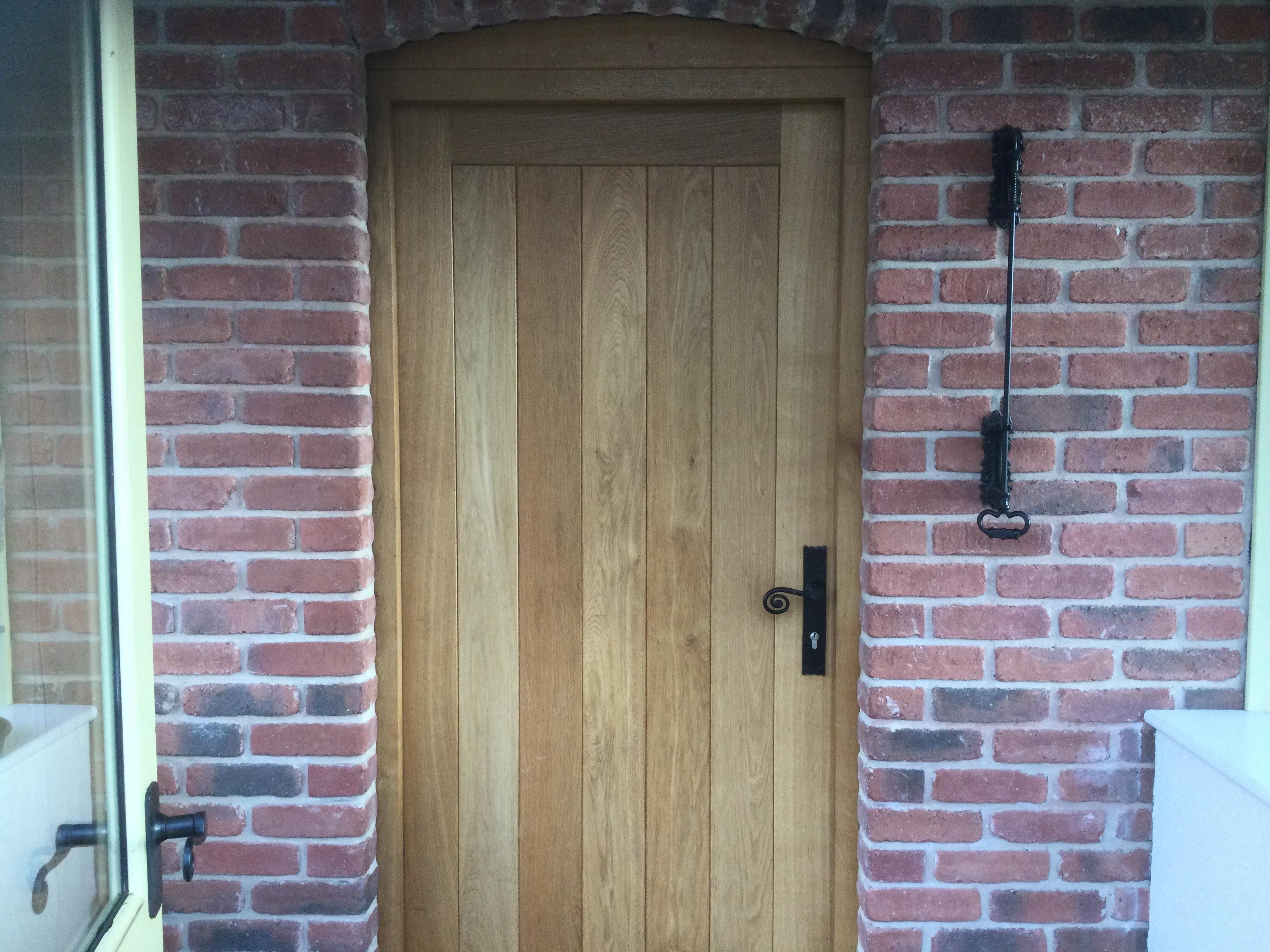

joe90 Posted September 20, 2022 Posted September 20, 2022 On my build I had an oak front door made, thicker than normal with insulation inside. Door frame with compression seals all round, very draught proof and thermally efficient. Wood is quite a good insulator.
Radian Posted September 20, 2022 Posted September 20, 2022 1 hour ago, joe90 said: I had an oak front door made, thicker than normal with insulation inside How was the insulation on the inside done?
joe90 Posted September 20, 2022 Posted September 20, 2022 1 hour ago, Radian said: How was the insulation on the inside done? Oak planks front and back and slab insulation between all in an oak surround. 2
JohnMo Posted September 20, 2022 Posted September 20, 2022 Our door is made a similar way, I think the insulation is 15mm PIR and has a certified U value of 1.0

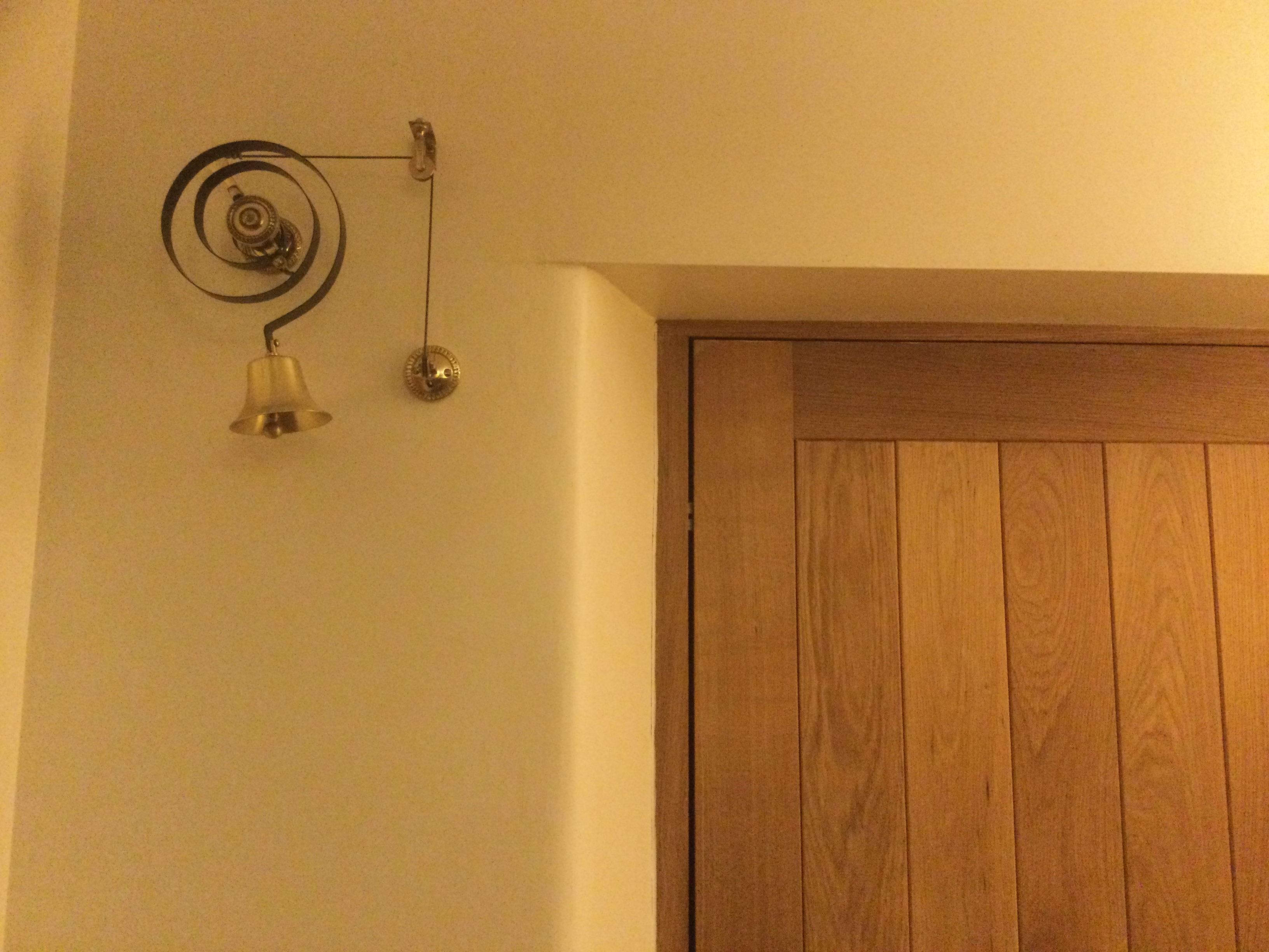

Susie Posted October 22, 2022 Posted October 22, 2022 1 hour ago, joe90 said: This was made for me locally Looks lovely how does it cope with our weather or is that in a porch room I also see a wonderful door bell pulley. Care to share who made both. PS we got PP on Thursday 😀 1
joe90 Posted October 22, 2022 Posted October 22, 2022 (edited) 36 minutes ago, Susie said: Looks lovely how does it cope with our weather or is that in a porch room I also see a wonderful door bell pulley. Care to share who made both. PS we got PP on Thursday 😀 It faces North so no UV damage, yes a porch with outer door (air lock). Local timber company made all my windows and doors, also the oak conservatory. Just outside Bude, Devon. I don’t do “tech” and love my doorbell. (Ebay). https://www.ebay.co.uk/itm/115205937618?hash well done on getting your PP 👍 Edited October 22, 2022 by joe90 1
Ferdinand Posted October 22, 2022 Posted October 22, 2022 3 hours ago, joe90 said: It faces North so no UV damage, yes a porch with outer door (air lock). Local timber company made all my windows and doors, also the oak conservatory. Just outside Bude, Devon. I don’t do “tech” and love my doorbell. (Ebay). https://www.ebay.co.uk/itm/115205937618?hash well done on getting your PP 👍 Where have you put the bell? Like the look of that.
joe90 Posted October 22, 2022 Posted October 22, 2022 24 minutes ago, Ferdinand said: Where have you put the bell? Like the look of that. Just the other side of the wall, I ran the string through a section of hollow tent pole drilled through the wall, I even stained the string black to match. No wires, no batteries, nothing to go wrong (except the string breaking 🤣) remember I hate “tech”. 2
