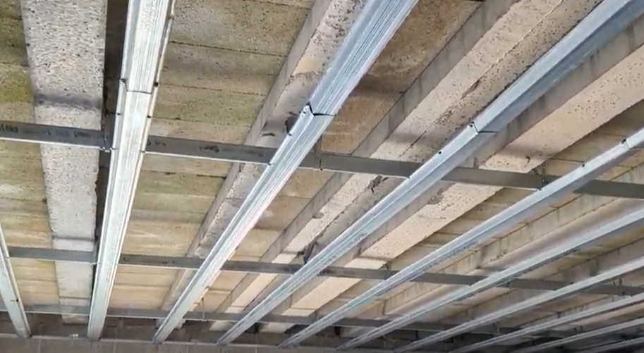

iMCaan Posted September 10, 2022 Share Posted September 10, 2022 Hii We just layed beam and block first floor. Just wondering what would be best method to hang the plasterboards to the ceiling? We do have ceiling clips to screw wood to and then to screw plasterboard to the wood. However, the ceiling clips seem flimsy. Is there an alternative method to hang the plasterboards to the ceiling? Thanks Link to comment Share on other sites More sharing options...
nod Posted September 10, 2022 Share Posted September 10, 2022 MF framing is easier and better You can ether hang a standard Top hat system Or a gypliner I prefer to use the gypliner clips rather than brackets Or if you don’t need or want a void You can plaster directly onto the block and beam Old School Link to comment Share on other sites More sharing options...
Temp Posted September 10, 2022 Share Posted September 10, 2022 Our b&b company provided clips for fixing battens to and they worked out OK. Unfortunately I dont remember what they looked like. The battens run 90 degrees to the conc beams so dead easy to run services. Link to comment Share on other sites More sharing options...
iMCaan Posted September 10, 2022 Author Share Posted September 10, 2022 Thanks. I will look into MF framing. We already have some clips, attached, provided by beam and block company. But I'm not sure if they're the best option. Link to comment Share on other sites More sharing options...

iMCaan Posted November 8, 2023 Author Share Posted November 8, 2023 (edited) Will the MF framing be screwed into the beam or blocks? The beam and block company has advised not to drill into the beams as that would undermine the strength of the beams. Is the attached gyplyner clip that @nod is referring to? Does it get screwed to the block or beam? Thank you Edited November 8, 2023 by iMCaan Link to comment Share on other sites More sharing options...
nod Posted November 8, 2023 Share Posted November 8, 2023 We normally use metal knock ins or Tek screws Shot firing can work loose if the block is the underside of a floor Link to comment Share on other sites More sharing options...
iMCaan Posted December 5, 2023 Author Share Posted December 5, 2023 (edited) I want to achieve a minimal hanging ceiling void (none if possible between concrete beam and plasterboard). I'm considering MF but I'm still confused how metal framing is fitted to a block and beam ceiling. The MF ends are screwed to the wall but how is the middle supported? Is it screwed to the beam or some type of clips are used? Please can someone share some product images. Does anyone have any picts of MF on block and beam ceiling that they can share? Thank you Edited December 5, 2023 by iMCaan Link to comment Share on other sites More sharing options...
