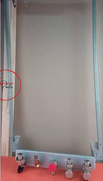

DamonHD Posted September 12, 2022 Author Posted September 12, 2022 For a while now the pressure reported by the combi has been swinging between 0 and 3 bar. When it gets low I gently top it up, but I suspect a failed expansion vessel. Rgds Damon
markocosic Posted September 13, 2022 Posted September 13, 2022 Got a bicycle pump? Drop the water out of a radiator; refill the expansion vessel precharge; then refill the system. If the vessel were totally dead then as the system comes up to temperature the pressure would spike and it would pee out of the relief valve before dropping to zero. The fact it doesn't do that immediately says there's still some charge left even if it is leaking out slowly. If the leak is slow enough recharging it will keep it alive longer. A more ghetto option, assuming bottom entry and exit, is to crack the bleed valve on a radiator and then drain down air air bubble in the top of the radiator. Repeat in other rooms preferring the ones that you don't use much / need much heat. That'll keep the system running long enough to sell the house when it becomes an exercise for the next helpful soul that decided to bleed the radiators to fix. None of this gives you an excuse to bin the thing though. 😉
Nickfromwales Posted September 13, 2022 Posted September 13, 2022 On the potterton there should be a jig under the boiler which lets you isolate the heating circuit, and then an integral service drain ( small one not like the type you fit a garden hose to ) to drip pressure off without losing all the inhibitor / primary water out. You may need to remove the cover to find the service drain, can’t remember exactly where that is sorry. MI’s will prob show these instructions, just need to know exactly which appliance it is.
DamonHD Posted September 13, 2022 Author Posted September 13, 2022 It's a Potterton Performa 24. Rgds Damon
SteamyTea Posted September 13, 2022 Posted September 13, 2022 26 minutes ago, DamonHD said: Potterton Performa Non performa 2
markocosic Posted September 13, 2022 Posted September 13, 2022 Even easier @Nickfromwales Damon you can isolate the space heating there, drop some water out of the boiler service drain, and recharge the expansion vessel with a bicycle pump. I'd fill it to a slightly lower level as your system pressure when cold (e.g. 0.7 bar for 1 bar cold and 1.3 bar hot) so that when cold the rubber inside is slightly to one side of centre, and when hot it's slightly to the other side of centre. Take advice from an actual plumber though rather than the bodger perpetually recharging a slightly dog eared expansion vessel. 😉 1
Nickfromwales Posted September 13, 2022 Posted September 13, 2022 11 hours ago, DamonHD said: It's a Potterton Performa 24. Rgds Damon Says service drain off resides behind the PRV. Are you going to tackle this, or delegate?
