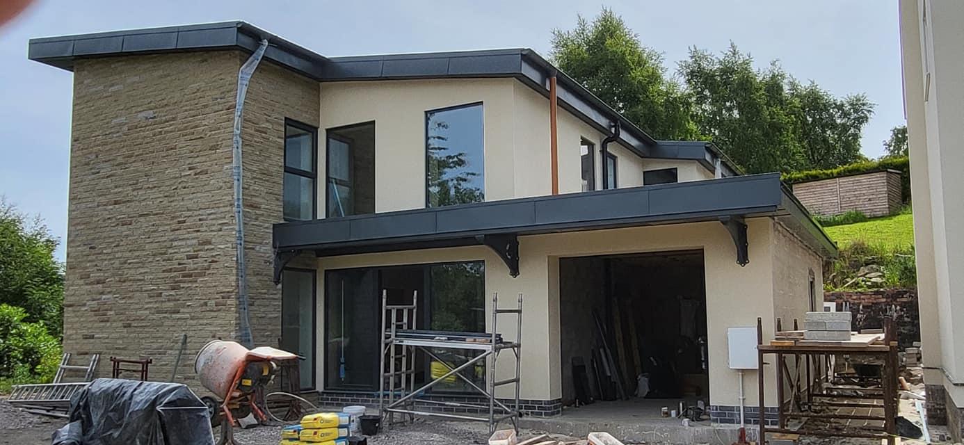

Happy Valley Posted September 7, 2022 Share Posted September 7, 2022 We have a 10 degree monopitch warm roof (not the garage). It's steel. There is no noise at all inside. It is very well insulated and there is a void between the roof and the ceilings. BTW you'll need oversized gutters/downpipes. 2 Link to comment Share on other sites More sharing options...
smart51 Posted September 7, 2022 Author Share Posted September 7, 2022 14 minutes ago, Happy Valley said: We have a 10 degree monopitch warm roof (not the garage). It's steel. There is no noise at all inside. It is very well insulated and there is a void between the roof and the ceilings. BTW you'll need oversized gutters/downpipes. I suspect it is the void between the roof and the ceiling that silences the rain. Nice looking house BTW. 1 Link to comment Share on other sites More sharing options...

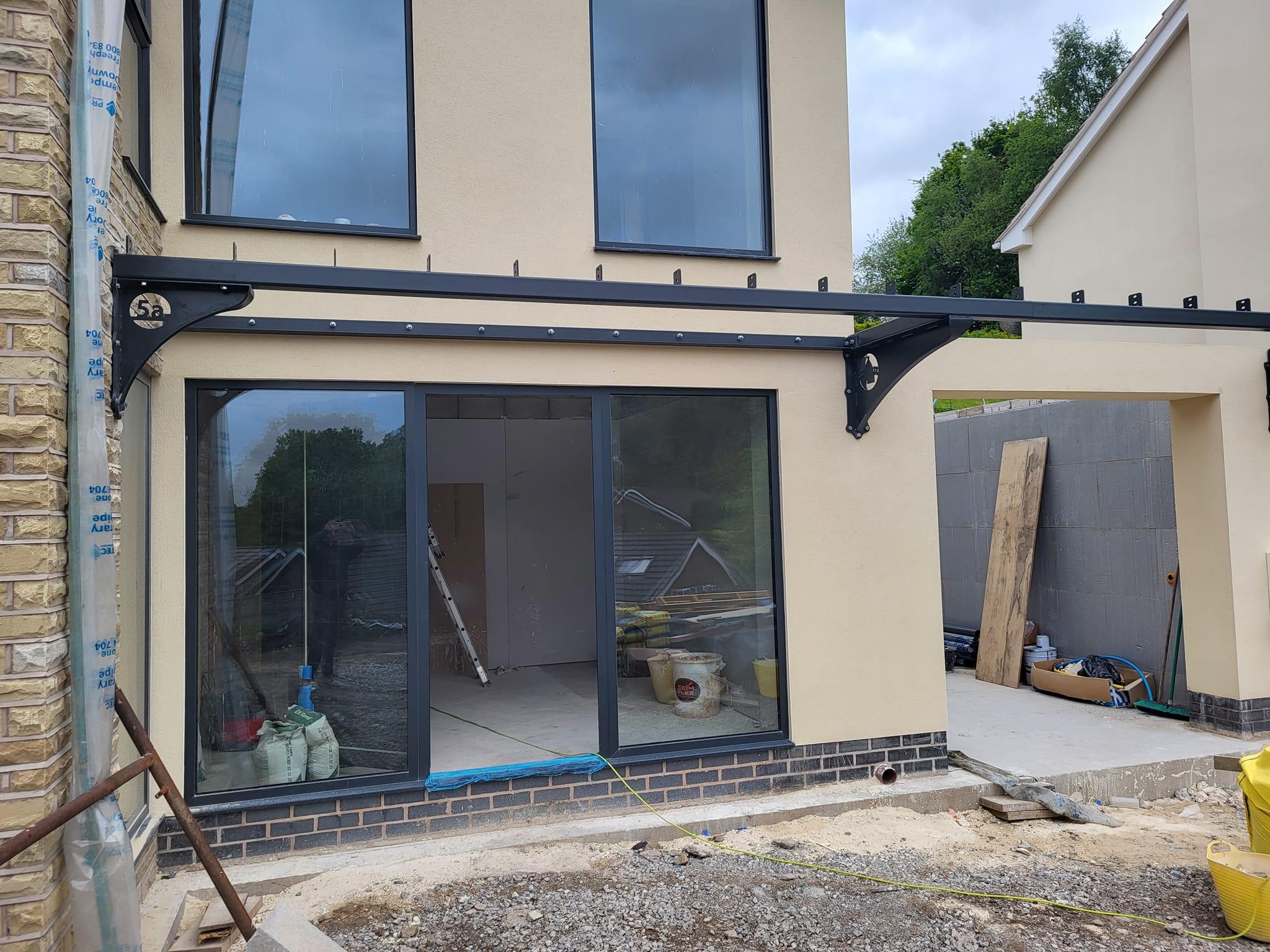

Gus Potter Posted September 7, 2022 Share Posted September 7, 2022 1 hour ago, Happy Valley said: We have a 10 degree monopitch warm roof (not the garage). It's steel. There is no noise at all inside. It is very well insulated and there is a void between the roof and the ceilings. BTW you'll need oversized gutters/downpipes. Cool. Are the gallows brackets structural? Link to comment Share on other sites More sharing options...
Happy Valley Posted September 7, 2022 Share Posted September 7, 2022 3 minutes ago, Gus Potter said: Cool. Are the gallows brackets structural? Yes, they hold up a warm flat roof of about 1 meter. There's a hidden steel box section on top of the gallows running the full length along the front. 1 Link to comment Share on other sites More sharing options...
Gus Potter Posted September 7, 2022 Share Posted September 7, 2022 Like it! Some pretty smart lazer cutting there in the webs. Can I be rude and ask what the brackets cost? 1 Link to comment Share on other sites More sharing options...

Happy Valley Posted September 8, 2022 Share Posted September 8, 2022 (edited) 10 hours ago, Gus Potter said: Like it! Some pretty smart lazer cutting there in the webs. Can I be rude and ask what the brackets cost? The 3 brackets (all with different cut outs) together with hidden stainless fixing points behind and all the box work (everything galvanised) was in the region of £3000 Edited September 8, 2022 by Happy Valley Link to comment Share on other sites More sharing options...
