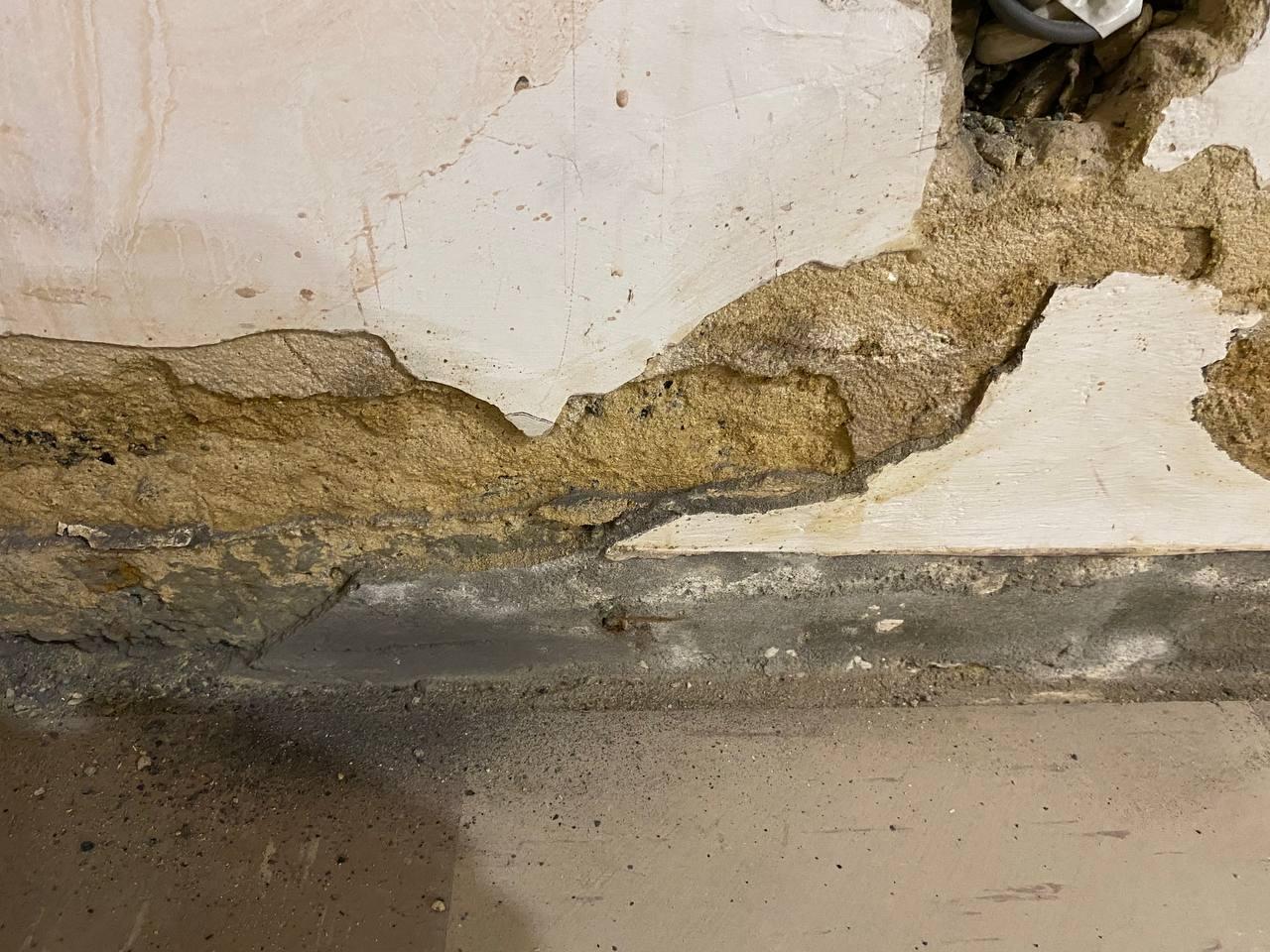

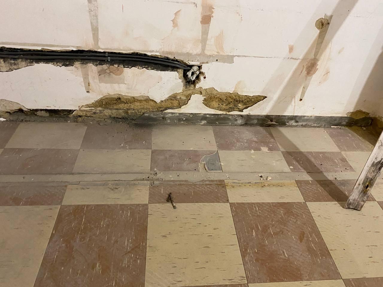

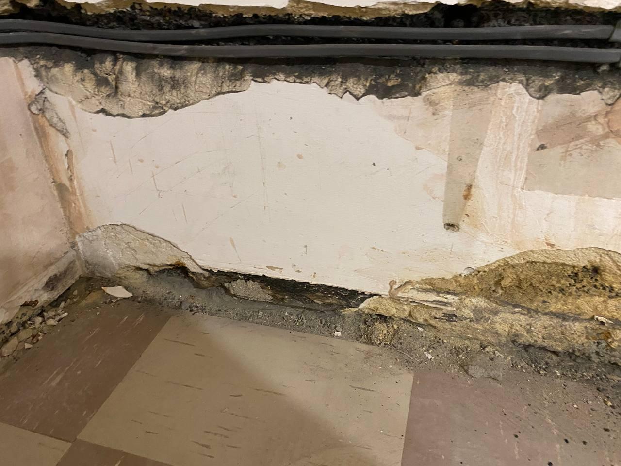

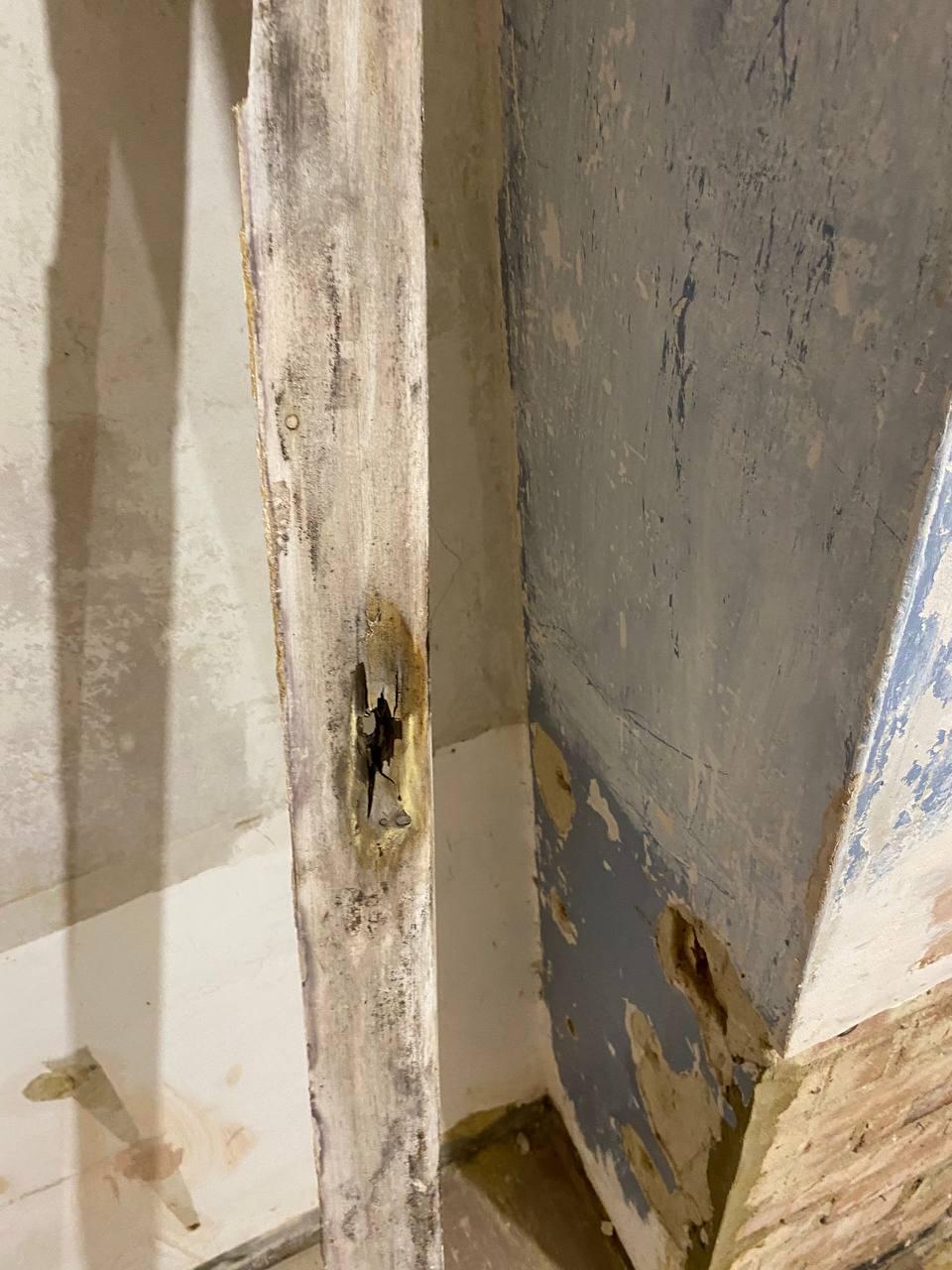

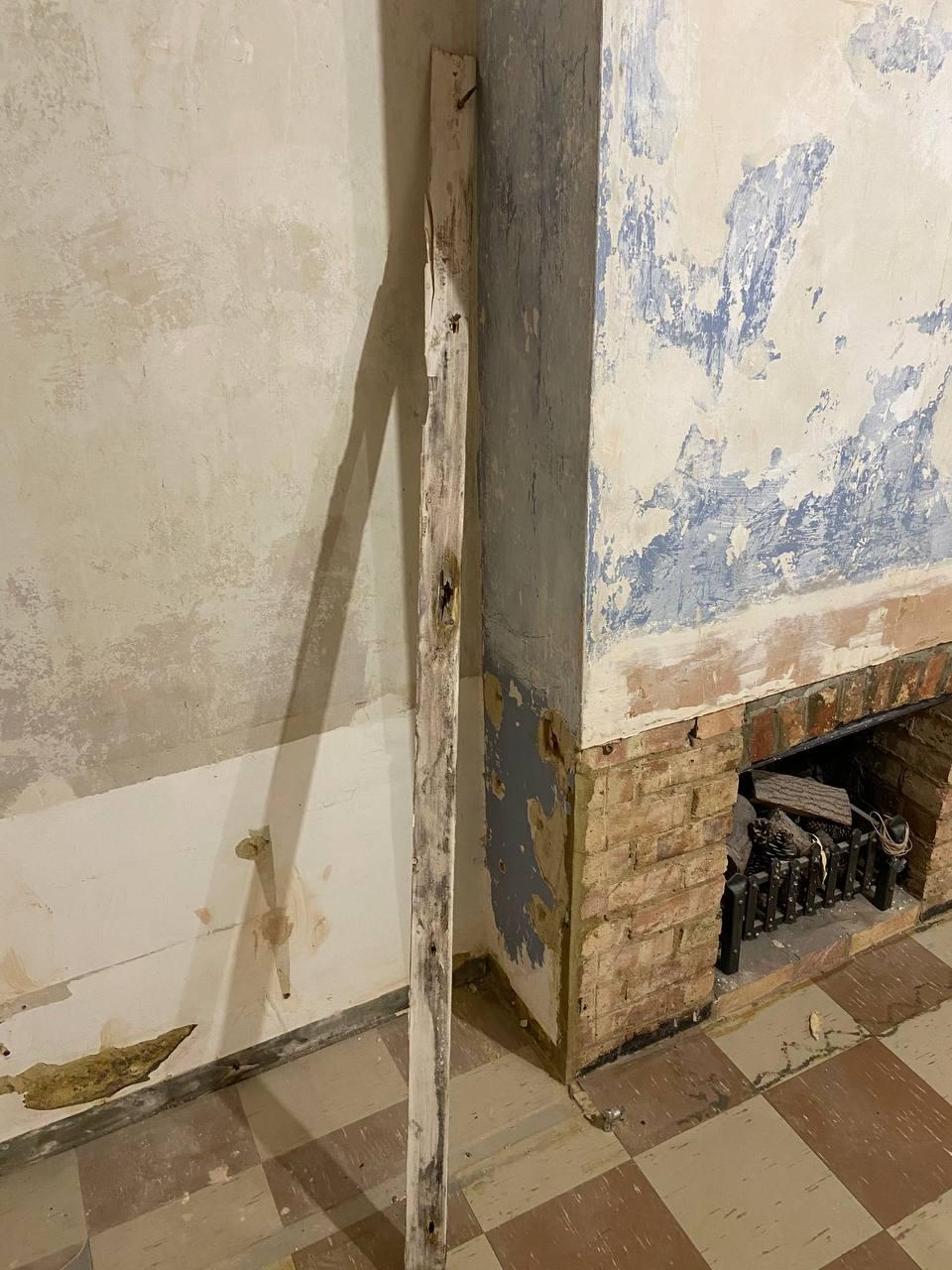

agamemnon Posted August 30, 2022 Posted August 30, 2022 Hello, We recently moved into a 1960s semi bungalow, we stripped the wallpaper and removed some of the outdated skirting boards, interestingly enough one of the skirting board was completely rotten and had some mould on it. The living room shares a party wall with the neighbouring house, their layout is mirrored, hence they also have a living room on the other side of the party wall. We had someone come in with a protimeter and the reading were at least 11%, we aren't sure what the cause for the dampness is, and want to have it investigate further, there is a chimney on the same side, but the chimney plaster is in generally good condition without any sign of flaking or loose plaster. The floor has marley tiles, with no issues of them becoming loose. The DPM is bitumen and the marley tiles level the whole floor. All the waterworks runs on the other side of the property, so none of the pipework is theoretically close, however, I can't confirm this, because when I tried to turn off the main water supply, the stop valve started leaking, so reverted it to the original position and need to get that replaced to check for any leaking. Any advise would be appreciated. Including some pictures.

Radian Posted August 30, 2022 Posted August 30, 2022 1 hour ago, agamemnon said: but the chimney plaster is in generally good condition without any sign of flaking or loose plaster. Is it possible that rainwater has been making its way down the chimney and is collecting/spreading out at floor level? I'd be looking at the condition of the chimney exit outside.
agamemnon Posted August 30, 2022 Author Posted August 30, 2022 (edited) 29 minutes ago, joe90 said: I had a similar thing, turned out to be a blocked rainwater drain on the boundary just outside, unblocked and the wall dried out. So none of the walls are external, one was historically but there is a conservatory on one side of the living room, then kitchen & hallway, third wall next to a bedroom, fourth and final is the party wall. @Radian So I had two wood burner installers after the handyman with the potrimeter, the handy man also said it could be the chimney, both chimney sweepers/stove installers said it’s likely coming from the floor or other side. Handyman went to the neighbours and their walls are in good condition. Edited August 30, 2022 by agamemnon Merged into one post

agamemnon Posted September 6, 2022 Author Posted September 6, 2022 (edited) So everyone who is a damp surveyor went to a secret conference/holiday and can't get anyone closeby booked until at least next week. One of my questions, does it matter if a dedicated "damp survey" needs to be undertaken, where you pay £100-150 for the survey, they then give you a quote for the work and if you go ahead you pay the additional difference. Or would you get a damp proofer, who looks at it and says "likely problems with damp proof course, this is the price...", from the sounds noone is going to go up to the roof to check, or do anything intrusive beyond visual inspection and moisture meter reading. Or am I missing something about "damp surveys" and there is more to it? For an update anywhere near the socket the moisture meter readings were 20-22% I took an hammer and chisel and removed all the cement and just above the floor level, moisture is more increased below and close to the socket instead of the chimney area. Edited September 6, 2022 by agamemnon

agamemnon Posted November 27, 2022 Author Posted November 27, 2022 The problem overall was the render bridging the bricks above dpm with below dpm and the concrete floor. 1” wide chase along the walls solved the issue.
