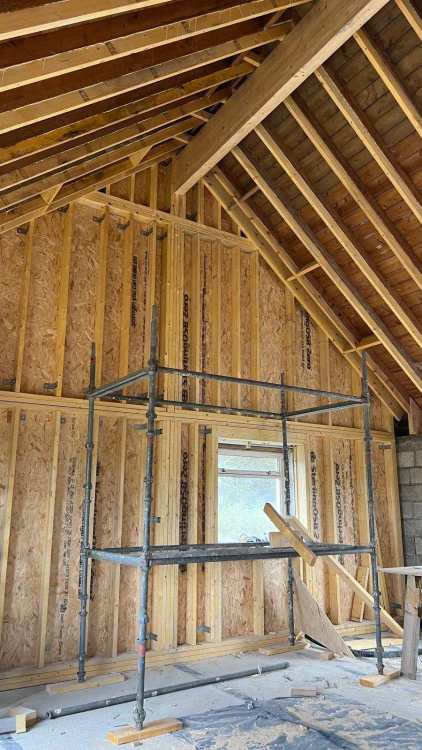

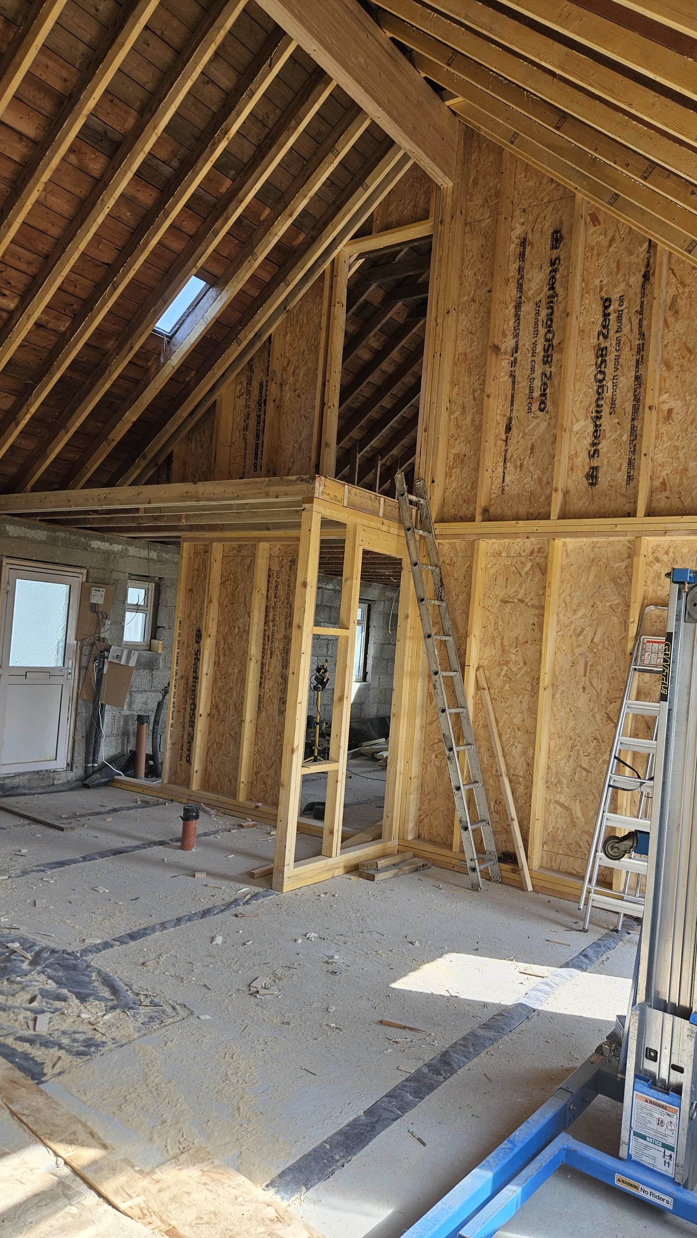

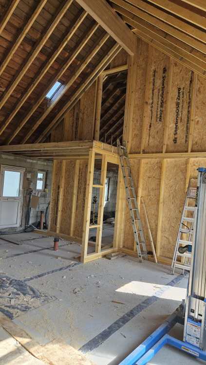

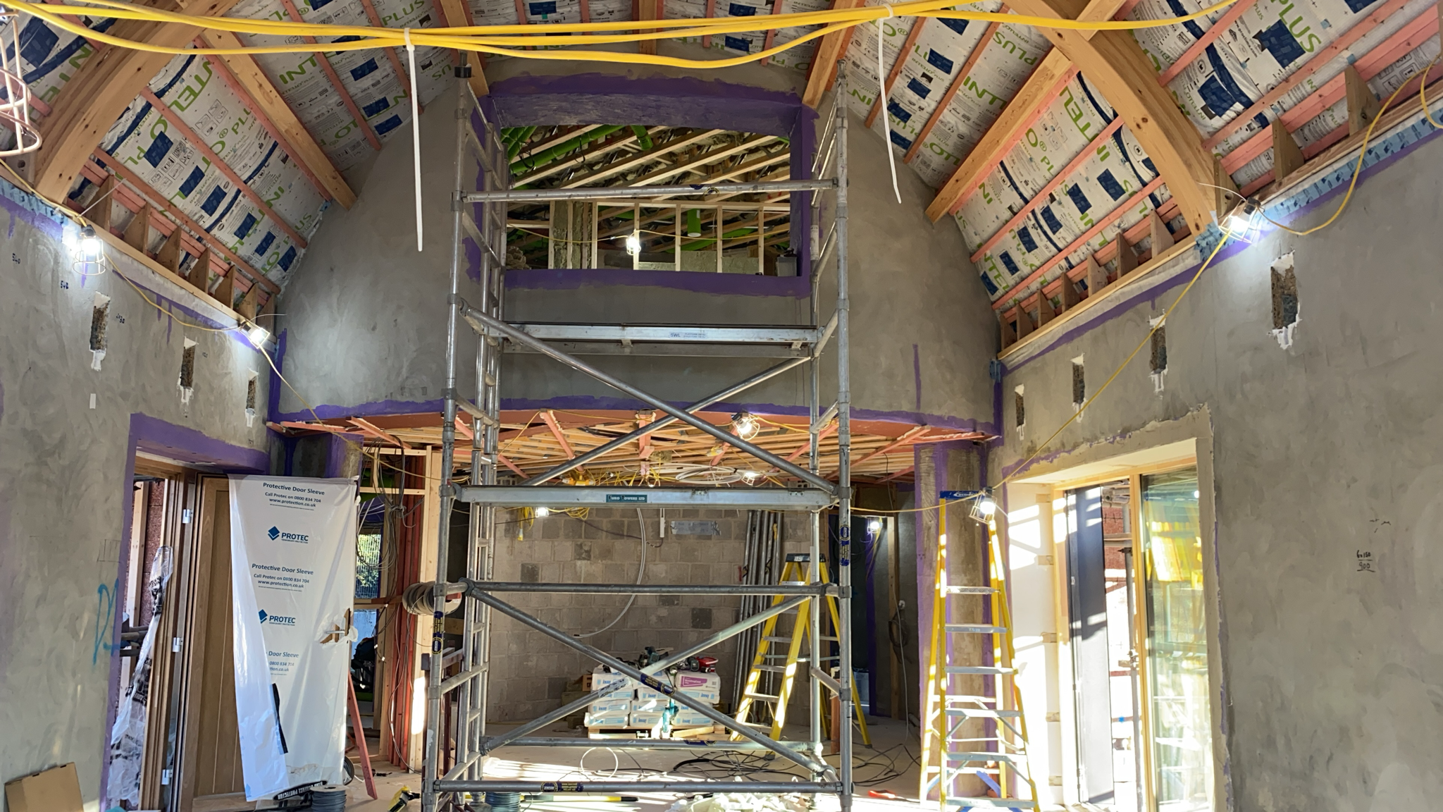

Hi, I'm also from the Highlands (Skye). Just converted a 70's house, turning half of it into a cathedral ceiling. The other half has a large 5m x 5m room/ensuite upstairs. The span of the house is 7.4m inside walls with a central load bearer running down the length, so approximately 3.7m each side of the load bearer. The first floor joists used back then were 6x2. Would you think the floor joists with a span of 3.7m either side of the (4x2) load bearer would support a 25mm biscuit mix without too much bother? Because the 6x2's kind of spoil the aesthetics when looking at the floor/ceiling from the open plan area, I also plan to brander the ceiling, also to make running services easier. Attached a couple of images of the cathedral ceiling which is 6m high. The open plan kitchen/lounge will be 7.4m x 6m. Many Thanks for any pointers

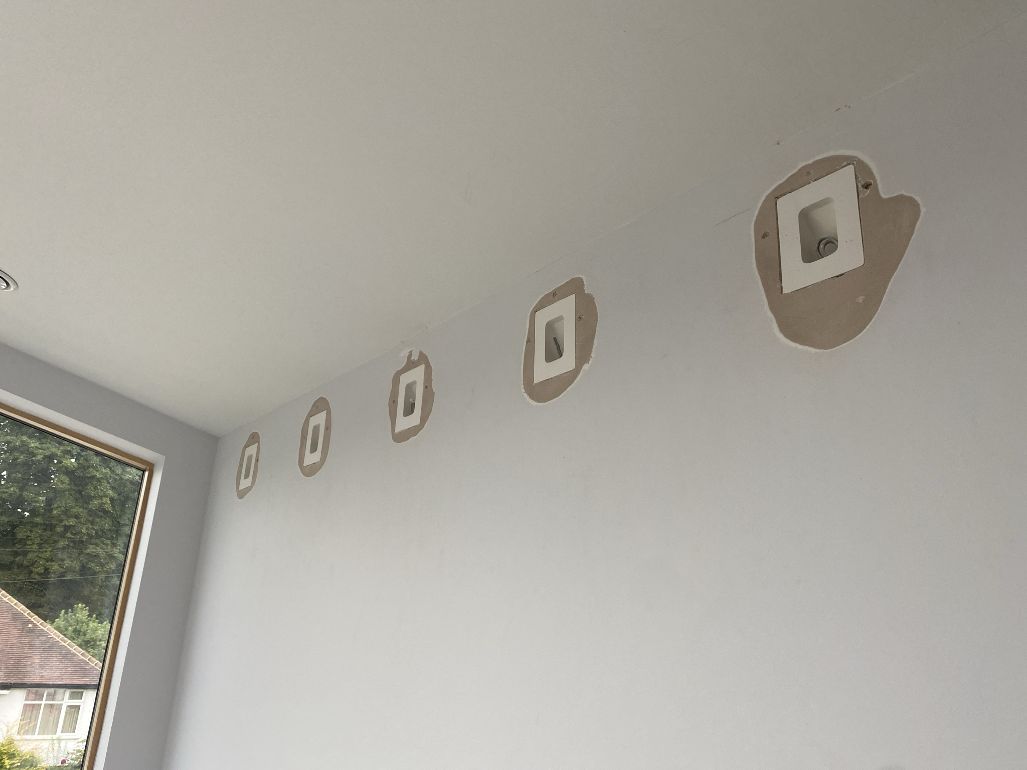

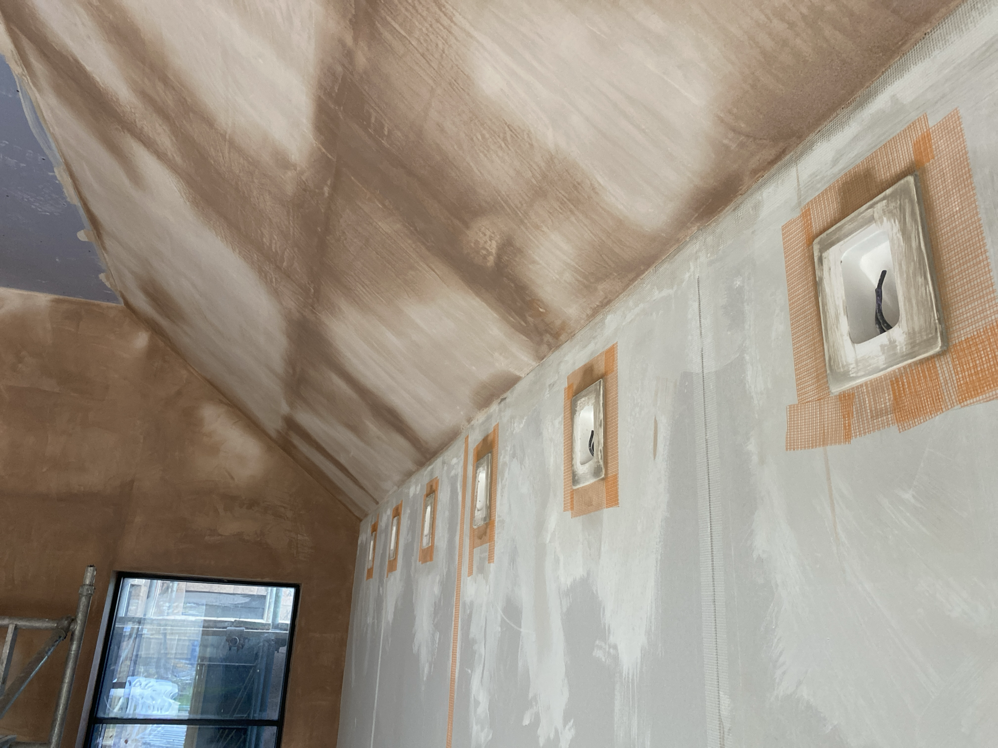

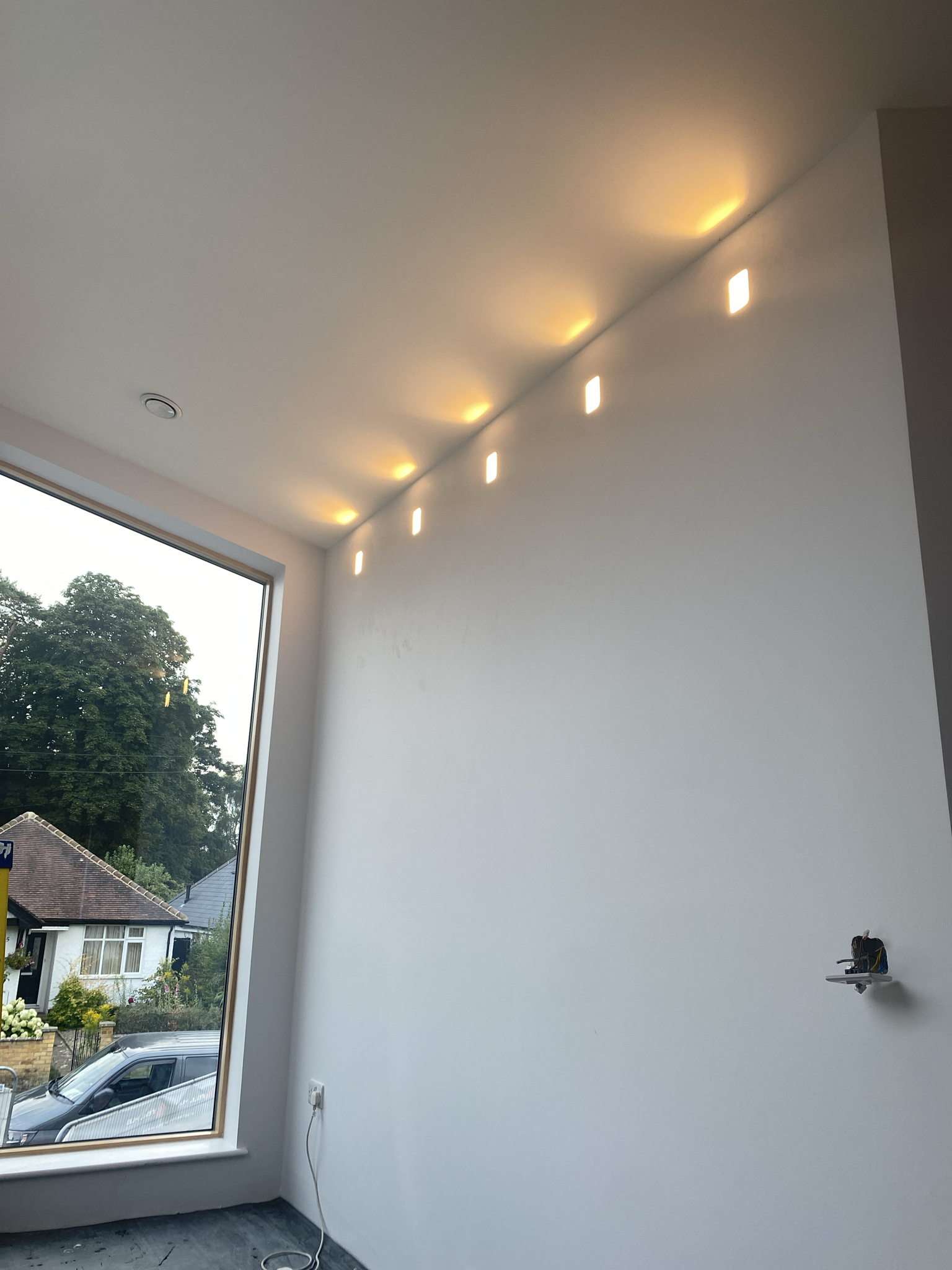

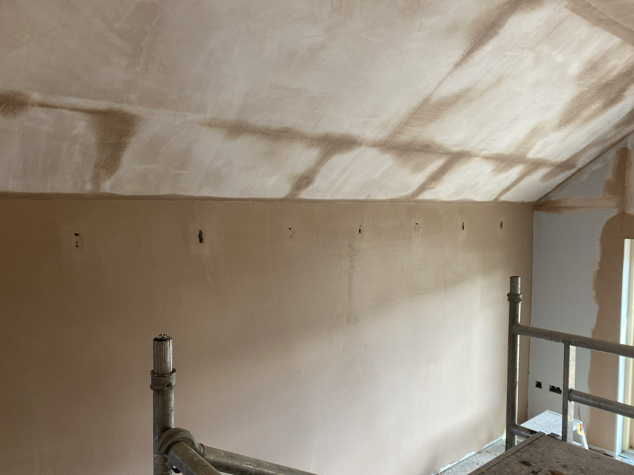

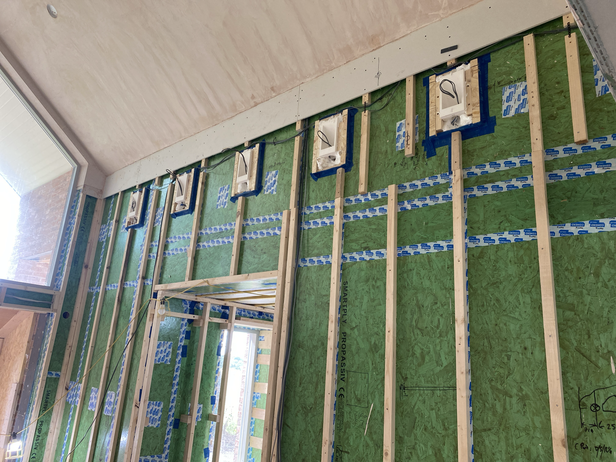

I’ve done a few projects with these cathedral type aspects, and have supported the clients with lighting design / electrical installation etc.
Check out plaster-in up lights; I’ve used Tornado lighting and the results have been great. Lots of light but no obvious source or offending lightbulbs to stare directly at.
For this client I installed 4 small surface mounted uplights at the base of each ‘spine’ and then you’ll see the pockets along each wall which is where I fitted the plaster-in units.
Some other examples for your information.
As @Nickfromwales I did similar but surface mounted up/down lights. So there are no electrics in the roof section at all. I put a service cavity there but never used it. Didn't even put any MVHR up there.1641229383886843465939736916291.thumb.jpg.ed65a6edbe94b1bf83219a882c95040e.jpg
Don't put lights high up, you need a scaffold to replace bulbs etc.
