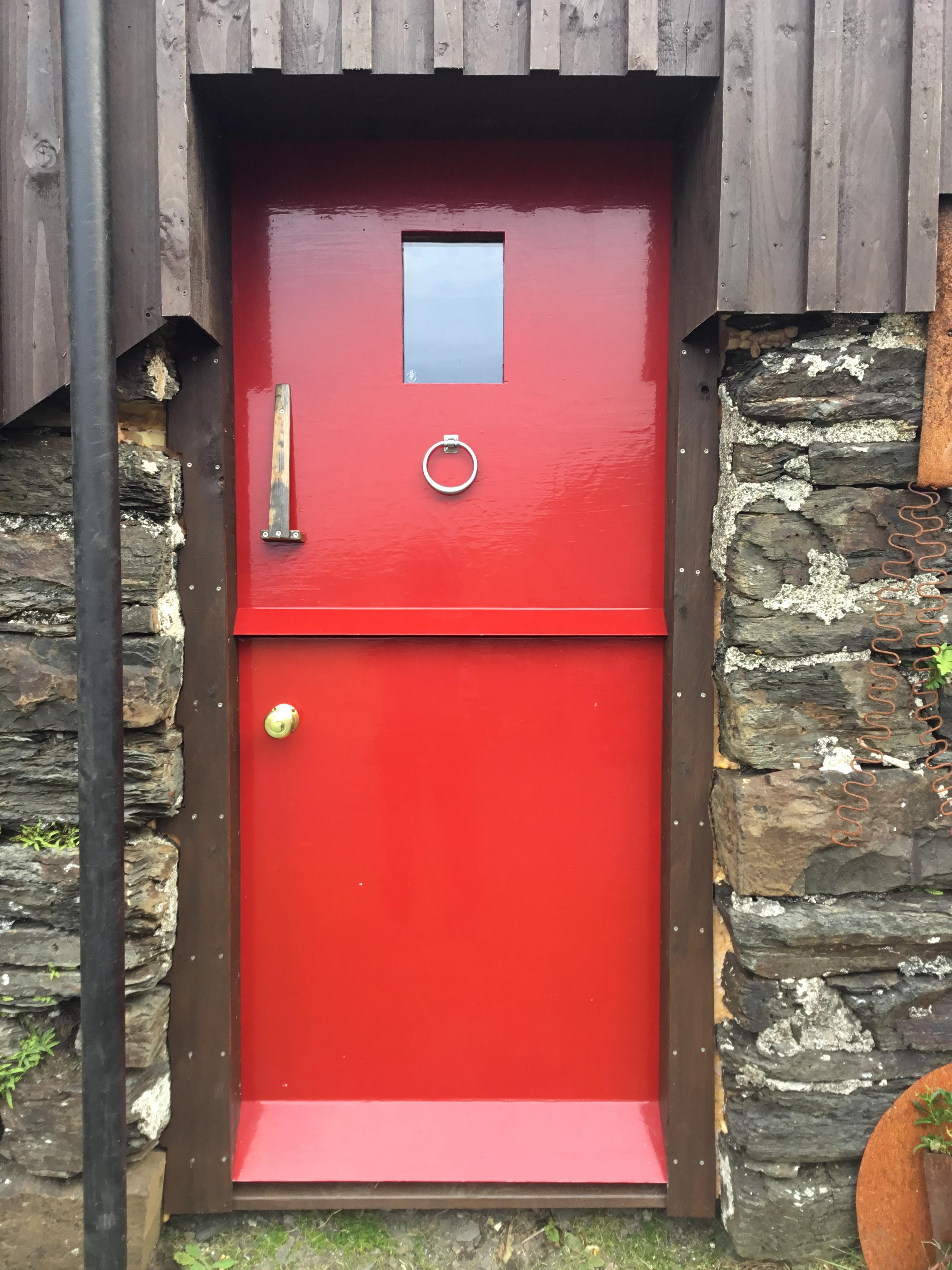

Caddy Posted August 19, 2022 Share Posted August 19, 2022 I'm looking for a stable door for the porch on my old cottage and was thinking to go solid oak for looks and hopefully durability. Is solid hardwood still the way to go or are composite doors more popular these days or something with a better U value than wood? I've seen this company and can get the custom sized door I need for ~£900 with prime grade oak and oiled finish. Anybody used this company or could suggest any others? https://wittswood.co.uk/quality-hardwood-products/stable-doors/exterior-stable-door-53-69-131-detail Any advice appreciated. Link to comment Share on other sites More sharing options...
Bonner Posted August 19, 2022 Share Posted August 19, 2022 Engineered wood is better for stability. Solid oak can twist so much that the door won’t close properly. Drafts/air leakage is more of an issue than U-value. Link to comment Share on other sites More sharing options...
Caddy Posted August 19, 2022 Author Share Posted August 19, 2022 21 minutes ago, Bonner said: Engineered wood is better for stability. Solid oak can twist so much that the door won’t close properly. Drafts/air leakage is more of an issue than U-value. I think my problem with engineered wood is that they mainly only come in standard sizes i.e. 1981mm high. My door needs to be 1918 which is a 62mm difference and the engineered doors have ~15mm strips for trimming. A lot of places doing the solid wood doors are made to order anyway and they can reduce the height easily. I'll keep looking as I have nothing against engineered doors but I've not seen one in the size I need. Link to comment Share on other sites More sharing options...
markc Posted August 19, 2022 Share Posted August 19, 2022 (edited) Forget that, just re read post Edited August 19, 2022 by markc Link to comment Share on other sites More sharing options...
Simplysimon Posted August 19, 2022 Share Posted August 19, 2022 6 hours ago, Caddy said: I think my problem with engineered wood is that they mainly only come in standard sizes i.e. 1981mm high. My door needs to be 1918 which is a 62mm difference and the engineered doors have ~15mm strips for trimming. A lot of places doing the solid wood doors are made to order anyway and they can reduce the height easily. I'll keep looking as I have nothing against engineered doors but I've not seen one in the size I need. depends on style of door, lippings can be ripped off, door sized and lippings dressed on the back and replaced. Link to comment Share on other sites More sharing options...
nod Posted August 19, 2022 Share Posted August 19, 2022 Iroko is a better option Looks like oak and Carrie’s a guarantee not to twist or warp Unlike oak 1 Link to comment Share on other sites More sharing options...
Cpd Posted August 19, 2022 Share Posted August 19, 2022 I made my own out of marine ply so that I could insulate them on the inside 😁 Link to comment Share on other sites More sharing options...
