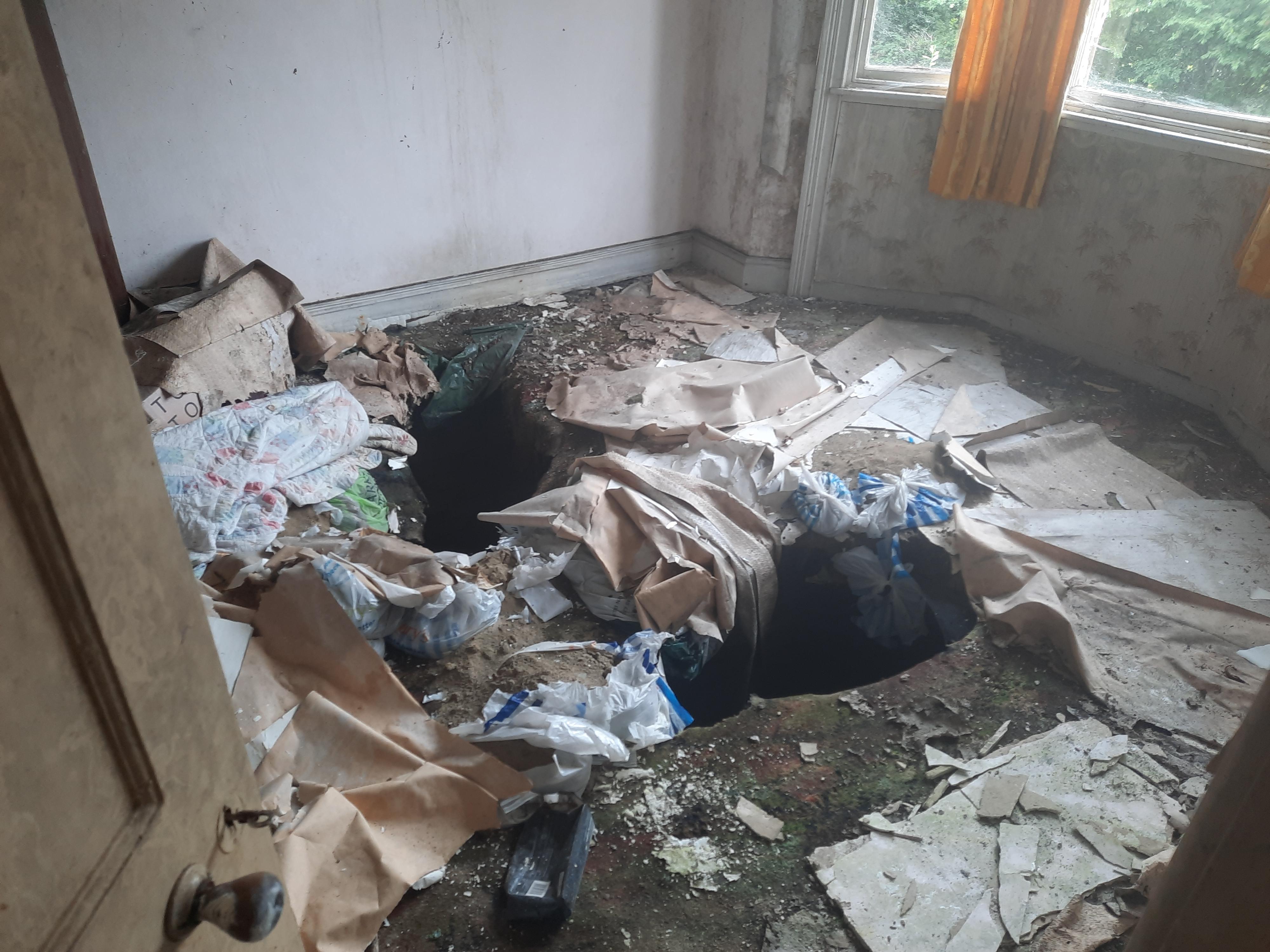

CalvinHobbes Posted August 12, 2022 Posted August 12, 2022 Hello, in Northern Ireland we pay rates on houses, both unoccupied and occupied unless you can prove a building is uneconomic to fix up. The bar is high apparently, even a missing wall or hole in the roof may not qualify the house for exemption. The house we want zero rated is due to be demolished in the next 2 month, we have planning permission, it's derelict, the floor is unstable because the house it's attached to has missing floors. It's thoroughly rotten with a structural fault. The roof would need replaced and missing bits to put tiles on. Any suggestions what actually will qualify?

CalvinHobbes Posted August 15, 2022 Author Posted August 15, 2022 So guy coming tomorrow, so 2 semi attached cottages built 1940's and one has been abandoned for 20 years already zero rated. I attach pics. The other in better nick but roofer told me he wouldn't replace any more tiles because there was nothing to put them on! Spark pulled one of the fuse switches and said don't ever put it back in, the wiring is a death trap (he was right, I was thrown across the bedroom plugging in something). He said the place was dangerous - get out. He was right. Floor feels dodgy, obviously dry rot etc and a big structural fault running across both. Windows single plane and the wind howls through (gaps around edges which appear to have been eaten!) So in terms of estimating valued where do you start? How much to replace a cottage roof? 40k? How much for the floor joists/treat woodworm and dry rot? 20k??? Windows 5k? Wiring? 10k? The staircase is not up to code and leads to only bathroom so presumably that has to change?? Meeting the land and property gent tomorrow, was thinking of giving him a list of estimated costs. We are knocking both down, it's just if it gets zero rated I don't get a rates bill of 500 . Below photo of adjoining cottage floor.
Mr Punter Posted August 15, 2022 Posted August 15, 2022 Just be nice to the guy, tell hime the cost to save the place is vast and you will be demolishing soon as it is unsafe. 1
