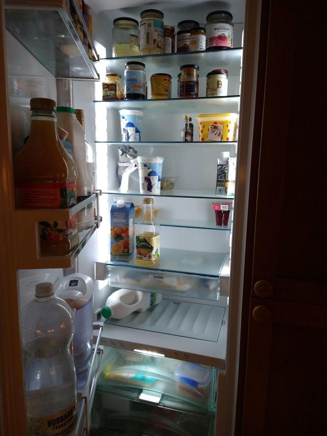

Fridgy Mc. fridgeface has been impressing us with its tricks all day now. Chief among these is drawing less than 1/4 the power of the old one while still managing to chill stuff down really fast. Supercool mode is actually super cool. But the one thing that delights me the most is the interior lighting...
Not one but three areas of LEDs with columns up both sides. The cherry on the cake is it goes with my movement sensitive kitchen Lighting theme by dimming up slowly rather than switching straight on when the door is opened. Will post up some power plots after it's had a full 24h without me opening it to tweak a hinge or add a bit of trim. On that matter, the installation instructions were (as everyone likes to point out on the internet) totally crap.

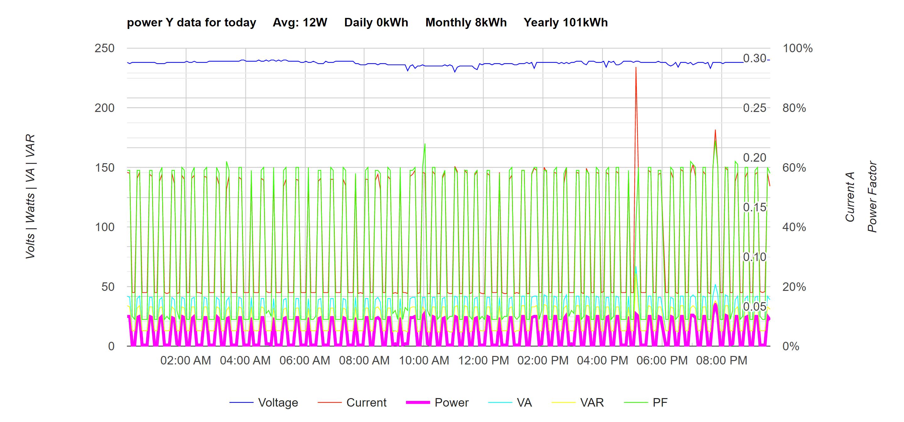

Energy data as advertised:
Energy consumption in 24h 0.242 kWh / 24h
Energy consumption per year 89 kWh/a
Actual consumption data for 24 hour period:
841688576_Screenshot2022-08-2622_17_56.thumb.png.23781a5f90be1acdca2a3004e415a07f.png
My daily kWh legend has rounded down to zero but the average of 12W over 24h makes 0.288kWh so slightly higher than their 0.242 kWh / 24h but not bad. Logging is done every 5 minutes so you only get a brief current spike, mostly averaged out, when the door is open due to the considerable led lighting. What's the betting the standard for test results are arranged to eliminate the contribution of the interior lighting.
The old fridge was averaging around 60W / 24h so this is going to save us £212 every year at the October price capped tariff.
