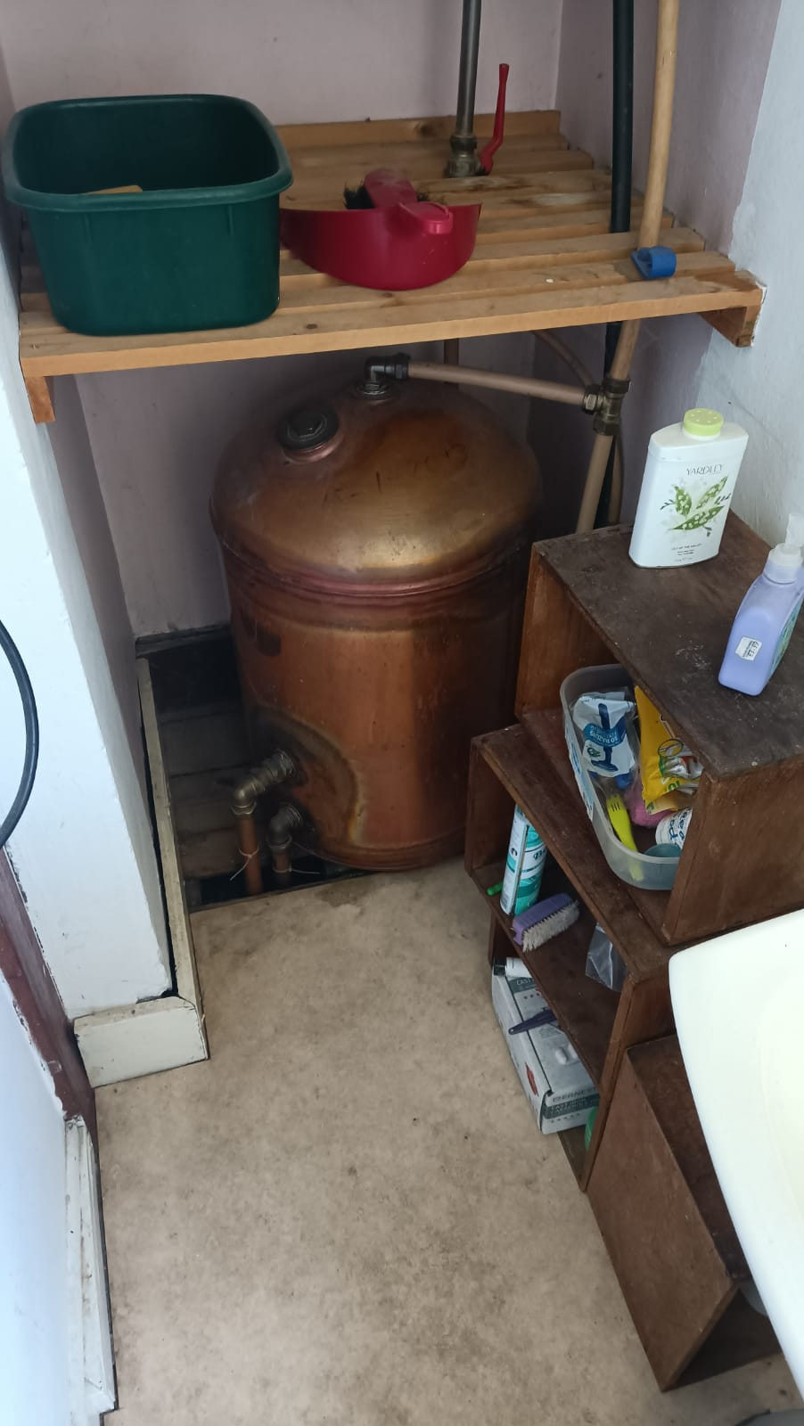

Iceverge Posted August 11, 2022 Share Posted August 11, 2022 I'm proposing to do something about the water system in my parents house. The system as currently stands is a mishmash of pipes and systems installed since the house was built in 1951. Water is provided by a well that is quite acidic, copper cylinders typically only last about 5-10 years. It feeds some of the cold taps directly from the main pipe from the pump and some via a gravity tank in an upstairs bathroom. Hot water is provided by a 120L direct copper cylinder heated on a gravity loop from a Rayburn 355sfw with a 16Kw boiler. Again distributed via a gravity fed header tank. Central Heating is from a 25 year old Firebird Popular Oil boiler to rads with a header tank in the Attic. Showering is done by an electric shower fed from the mains. Current issues are. 1. The high cost of oil in heating an old house. 2. The Rayburn is lit "religiously" with free timber daily for cooking and DHW. However the water in the copper cylinder is frequently approaching boiling temp with risk of scalding and damage to taps etc. It has a steel backboiler so water is brown from the hot taps, running DHW directly through the boiler is corroding it also. 3. The attic needs insulation but as it contains header tanks that may need moving/replacing we're holding fire on that. 4. The well water corrodes all copper and brass fittings eventually. 5. The Electric shower forms the vast majority of the electricity bill while most wood heated DHW goes to waste. The ideal system. 1. Have a hybird system that allowed the oil and/or rayburn to provide hot water and heating. 2. Remove all tanks from the attic. 3. Replace the current mix of piping with Hep20. 4. Switch to a pressurised system. 5. Move the cylinder downstairs to free up space for an ensuite upstairs. 6. Retain the Electric shower. My proposal. 1. Bring a new 22mm MDPE pipe directly into the house from the well. 2. Run it to a cold Hep2O manifold for radial cold water distribution. 3. Install a DHW "coil in tank" thermal store on the ground floor above the level of the Rayburn. 4. Run the Rayburn on a gravity circuit. 5. Connect the Oil boiler to the store on a pumped circuit. 6. Connect the existing CH loops to the store and have them operated by a temp switch near the bottom of the tank. 7. Run Radial hot water pipes from a new Hep20 Manifold and a thermostatic mixing valve. Issues 1. With a combi tank the thermal store header/expansion would be below the level of the upstairs rads meaning they'd need to be decommissioned. A header tank in the attic could solve this but I like the tidiness of a combi thermal store and consider it safer in a location where all leaks can be drained outside easily. Also I don't want to have to cut joists (6x2" at 16" cc) to fit a new tank up there. 2. Thermal stores are harder to get in Ireland then than the UK and may be expensive. 3. Access to existing pipes etc, (not Buildhubs problem I know) 4. Infinite funds not available and might need to be completed piecemeal. 5. What options are there for running primary water loops other than copper. I gather Hep2O/pex isn't an option however copper would be very hard to retrofit. Please critique my plans. Link to comment Share on other sites More sharing options...

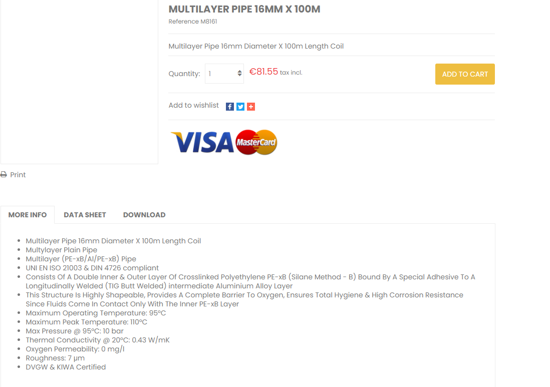

Iceverge Posted August 14, 2022 Author Share Posted August 14, 2022 Any takers? At least is Multilayer PEX-Al-PEX suitable for taking water from an oil boiler to a thermal store? Link to comment Share on other sites More sharing options...

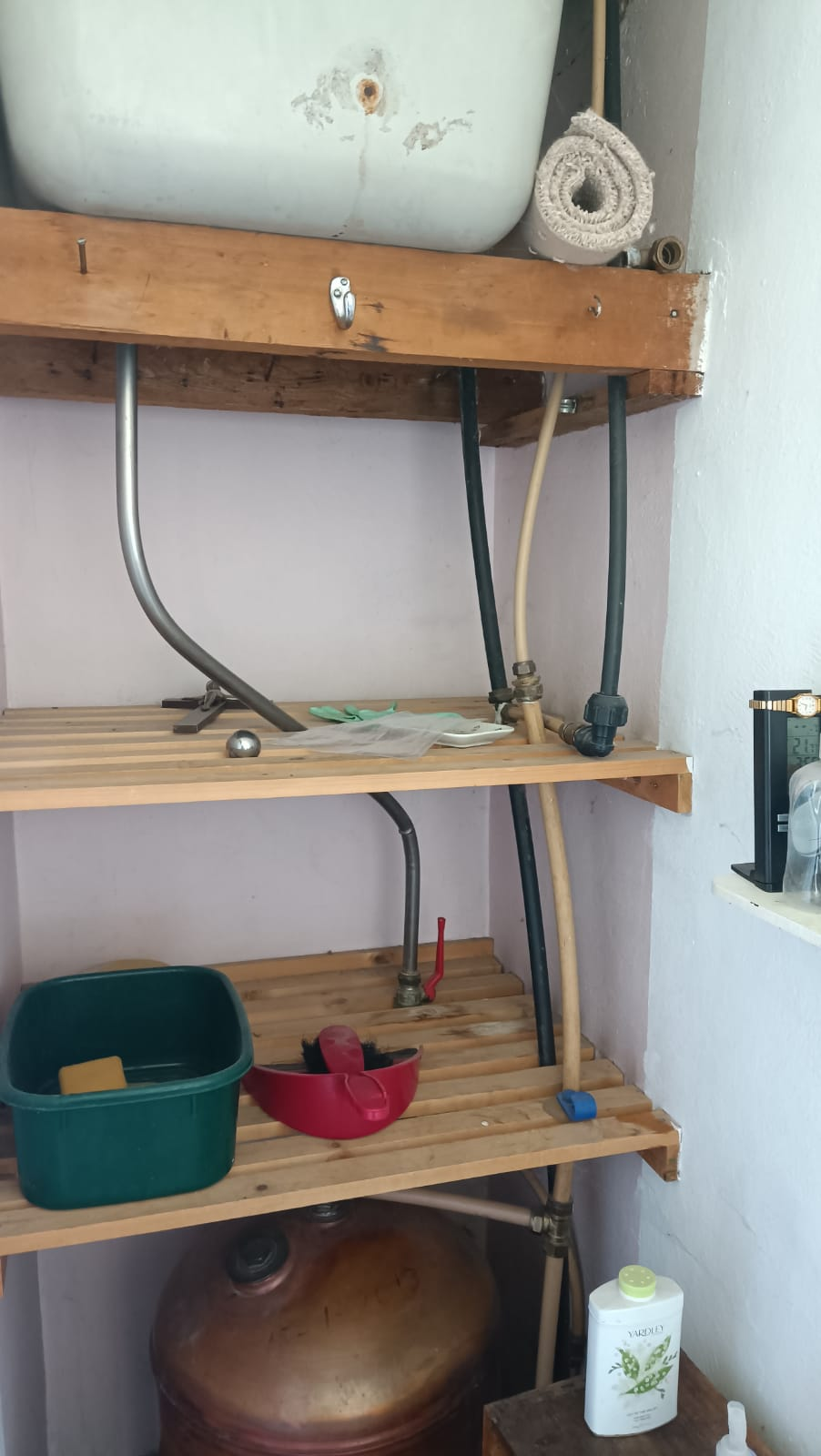

Nickfromwales Posted August 17, 2022 Share Posted August 17, 2022 (edited) OK. Firstly, only use copper for the primary pipework whatever you do!! No other product is rated for boiling water / steam. That's why the gravity tanks should be galvanised steel, as plastic tanks melt and shower occupants with scalding water. People have been killed by this happening where they got scalded to death in their beds when the tanks just folded in and dropped on them. It's a very serious issue. On 11/08/2022 at 12:13, Iceverge said: It has a steel backboiler so water is brown from the hot taps, running DHW directly through the boiler is corroding it also. These two bodies of water should not be meeting? The heated primary water should be going through a coil? Is this a failed / failing primatic hot water cylinder? On 11/08/2022 at 12:13, Iceverge said: The high cost of oil in heating an old house. Buy lots in the summer, as the cost of this system conversion will not be cheap!! On 11/08/2022 at 12:13, Iceverge said: Have a hybird system that allowed the oil and/or rayburn to provide hot water and heating. Simple to achieve tbh, but the Rayburn will need to a) keep the galv header tank, or b) be garnished with a retrofitted cold mains fed quench valve ( which cools the solid fuel device with mains water ) but that may not be suitable / compliant for an existing device. Also being mindful that your cold mains is power-dependant, so adds another degree of complexity!! I'd just keep the header tanks tbh, renewing them to be sure of longevity / suitability / reliability etc. The ground floor cylinder could then just be a gravity thermal store, stainless steel to combat corrosion issues as best as possible, and a very simple device where all bodies of primary water are shared, eg your hybrid setup would simply converge there. Where is the current cylinder? In this 630mm wide location or elsewhere? If there is a second cylinder location available, I would go; Rayburn > TS TS > Space heating Oil > Space heating ( ignoring TS when Rayburn is not in operation ) future-proofs against old age / sick days etc. Oil > DHW UVC ( when Rayburn not in operation ) "" ditto TS > DHW UVC ( when Rayburn is in operation ) doubles up thermal storage capacity to maximise 'stored' heat, eg DHW still ( residually / theoretically ) available early morning before lighting Rayburn On 16/08/2022 at 13:41, Iceverge said: Good point I suppose it's only a couple of ports. This house will never run off a heat pump. Flush that idea from here please!?! On 11/08/2022 at 12:13, Iceverge said: 1. Have a hybird system that allowed the oil and/or rayburn to provide hot water and heating. 2. Remove all tanks from the attic. 3. Replace the current mix of piping with Hep20. 4. Switch to a pressurised system. 5. Move the cylinder downstairs to free up space for an ensuite upstairs. 6. Retain the Electric shower. Doable Nope, not for heating anyways. Prob need the keep a CWS from the borehole for reliability. It's an attic, just leave it alone / utilise it to your advantage ( benefit ) imo. Not for the primary heating from solid fuel, copper best for the backbone here afaic. Nope. That means added maintenance for the old-folk, topping up, checking pressures, etc. Will also promote introducing leaks where weak spots currently reside. Poops on my idea for a dual-cylinder arrangement. If this is for the parents to grow old with, consider the en-suite / bedroom arrangement for downstairs maybe? Electric showers are shart on a good day, also not thermostatic unless you upgrade? Mixer showers off the TS or UVC would be far superior, plus pointless having PV diversion if it's going into a dead end whilst grid electricity is chewed up in parallel?? OK. Lets start there Edited August 17, 2022 by Nickfromwales Link to comment Share on other sites More sharing options...

Iceverge Posted August 18, 2022 Author Share Posted August 18, 2022 Thanks very much all for replying. There's really no excuse for not getting the water sorted. My best mate installs softeners plus treatment units! Must organise a water test asap. 15 hours ago, Nickfromwales said: That's why the gravity tanks should be galvanised steel, as plastic tanks melt and shower occupants with scalding water. People have been killed by this happening where they got scalded to death in their beds when the tanks just folded in and dropped on them. It's a very serious issue. The current one is fibreglass, is that acceptable? Aware of the dangers, I think there was a terrible case somewhere in SW England a few years back I think when a tank came through the ceiling. Hence wanting to do something about it. Also it forms some of my motivation of wanting to keep all stored water downstairs in a tanked cupboard with a drain to outside. 15 hours ago, Nickfromwales said: These two bodies of water should not be meeting? The heated primary water should be going through a coil? Is this a failed / failing primatic hot water cylinder? It was originally a 1950's system with a copper boiler in the Rayburn where all the DHW water went through the rayburn and a direct cylinder. The swap for a newer (but still 2nd hand) rayburn with a steel boiler last year has caused brown water from the hot taps and no doubt corrosion of the boiler. A bodge that needs fixing. Is a pressurised heating circuit much more resilient to corrosion etc than an open vented one with a header tank? I'm fond of the idea of a header tank over expansion vessels as a low maintenance system. Theres an existing W/C with space for a shower if we remove the Copper Cylinder upstairs. Theres a shower in existence downstairs at them moment and a room that could be a bedroom so thats not a huge concern. The cupboard downstairs is 630x950mm x 2650mm high. Its adjacent to an external wall with a void in the floor (used for an open fire bellows originally) That could be used for a new feed to the house. Its also directly below the upstairs W/C. The cupboard is 1.5m from the Rayburn laterally and the 3rd wall backs onto a wall where pipes could easily be routed to the oil boiler. It really is ideally placed but just a little tight. Ok how about this. Well water > Water softener New MDPE pipe routed to direct combi TS + Hep2O cold manifold Rayburn > TS Oil > TS TS > Downstairs Rads only. TS > Blending valve > Hep2O manifold. CH to be operated by Temp switch near the bottom of the TS to ensure that CH doesn't cannibalise DHW. If CH needed just fire the boiler or Rayburn and once the DHW portion of TS is hot then CH will spring to life. Slower yes but simple and should ensure DHW is protected? The rayburn will defo be copper piped primary to TS. Is there no more flexible option for the primary pipework from the oil Boiler as this will be tricky to route? Oh one more question. Is sludge lightly to banjax the TS connecting it to a set of old Rads and a steel boiler that is rusted internally on the Rayburn? Link to comment Share on other sites More sharing options...

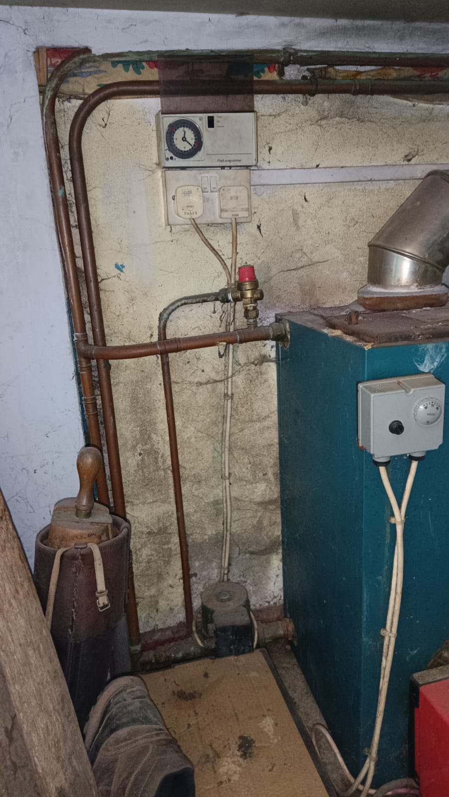

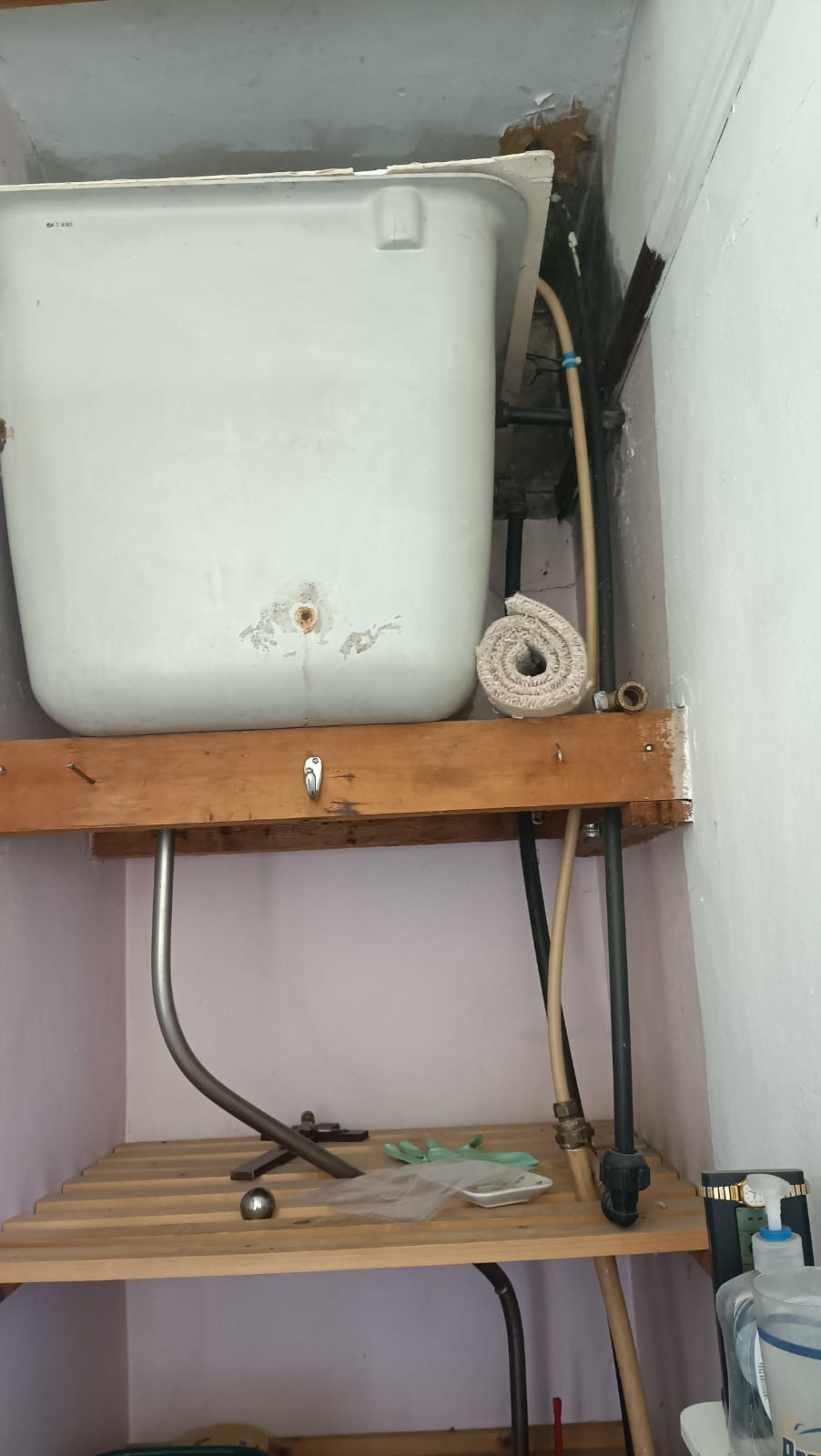

Nickfromwales Posted August 18, 2022 Share Posted August 18, 2022 5 hours ago, Iceverge said: The current one is fibreglass, is that acceptable? Yup, as long as it has a copper overflow and copper ( metal ) connected pipework. 5 hours ago, Iceverge said: It was originally a 1950's system with a copper boiler in the Rayburn where all the DHW water went through the rayburn and a direct cylinder. The swap for a newer (but still 2nd hand) Rayburn with a steel boiler last year has caused brown water from the hot taps and no doubt corrosion of the boiler. A bodge that needs fixing. This bit is confusing me. Gravity primary's normally convey heated primary water to a coil in a DHW cylinder, been that way since I was knee-high to a grasshopper. How many tanks are in the attic? On 11/08/2022 at 12:13, Iceverge said: The attic needs insulation but as it contains header tanks that may need moving/replacing we're holding fire on that. Are these both fibreglass? One for the CH circuit of the Rayburn, and a second exclusively servicing DHW? How many connections ( and where ) on the copper DHW cylinder atm? Need to understand this a bit better, but tbh mostly out of curiosity if things are to be changed around anyhoo. 5 hours ago, Iceverge said: Is a pressurised heating circuit much more resilient to corrosion etc than an open vented one with a header tank? I'm fond of the idea of a header tank over expansion vessels as a low maintenance system. A 'circuit' will be a victim of circumstance, so no generic yes/no there If a circuit has UFH and stainless / copper parts the corrosion issue is miniscule, if rads are present the issue is increased, albeit still manageable with inhibitors etc. If folk are bathing in DHW from a primatic cylinder you cannot treat the primary water so must upscale on design / diligence, but if your DHW and the CH primary water re two completely separate bodies of water ( suggested by the 'plural' reference to the header tanks ) then there are options for chemically treating the water to better manage condition. A magnetic filter would be an obvious friend to introduce here, but it would need cleaning out regularly for the first year. You don't really want to introduce a sealed and pressurised setup here, IMHO, as the folks will have to monitor / top up / make sure they don't over-pressurise etc etc, aka ball-ache. F&E = simple life / minimum routine maintenance. If the F&E tanks remain in the attic ( which they very likely will have to ) then you're fine to stay on gravity, so one less problem. Upstairs heating stays on that too so, so happy days. So; Bathing still to be off electric showers? Ergo stored DHW will be for washing hands / dishes etc only? Seems madness to me, especially if 'religious' Rayburn usage is on the cards for the foreseeable? Remember that occupancy by anyone deemed infirm requires thermostatic control for anti-scald, so regular electric showers 'should' be changed, for both safety and comfort, ( if being retained ). 6 hours ago, Iceverge said: Ok how about this. Well water > Water softener New MDPE pipe routed to direct combi TS + Hep2O cold manifold Rayburn > TS Oil > TS TS > Downstairs Rads only. TS > Blending valve > Hep2O manifold. What will happen the the second heat exchanger connections? The ones doing DHW via the steel tank? Te Rayburn is a 4-pipe setup atm yes? Link to comment Share on other sites More sharing options...

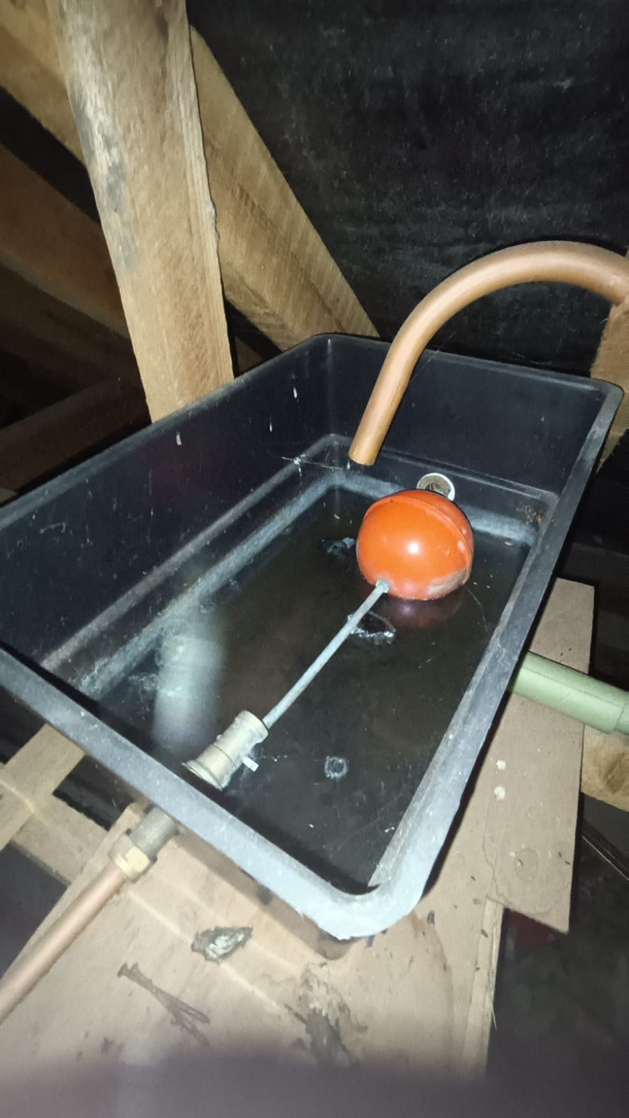

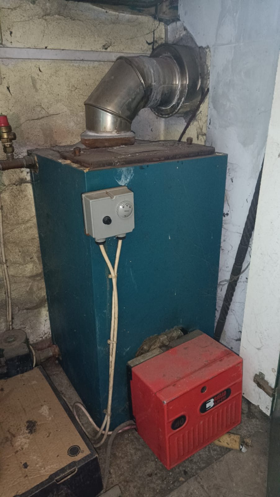

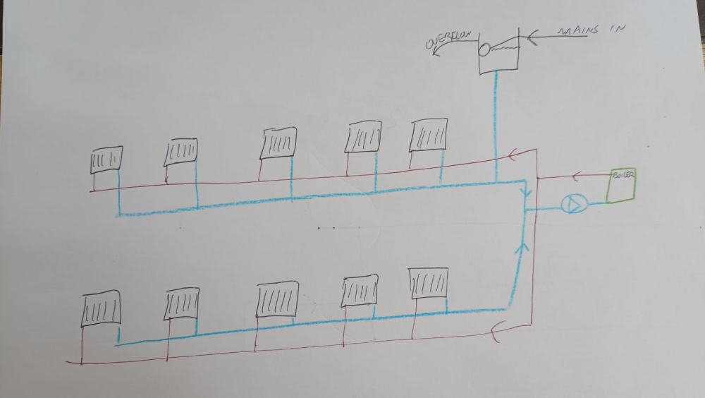

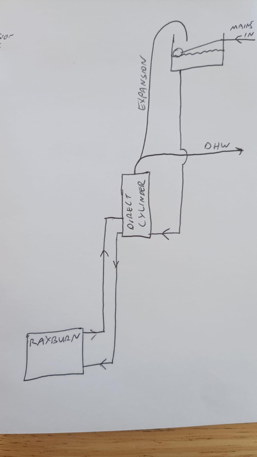

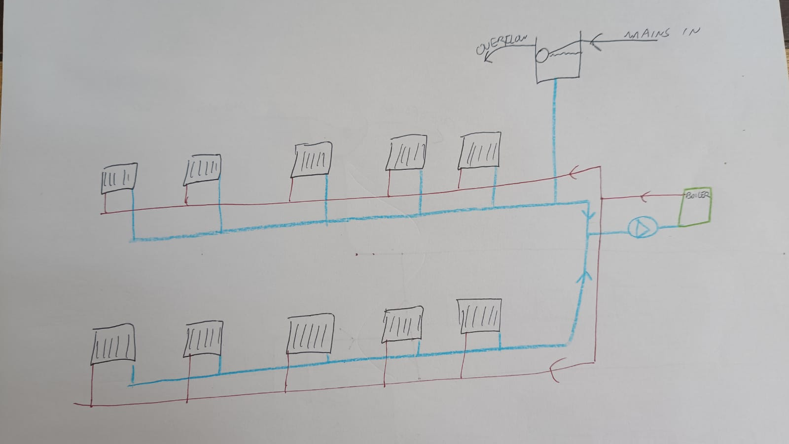

Iceverge Posted August 22, 2022 Author Share Posted August 22, 2022 Ok, here goes. The central heating is worked from an oil fired boiler. Feeding 5 Rads downstairs and 5 Rads upstairs. It is kept topped up by a Tank in the Attic. Here's a Sketch of what I think it looks like Link to comment Share on other sites More sharing options...

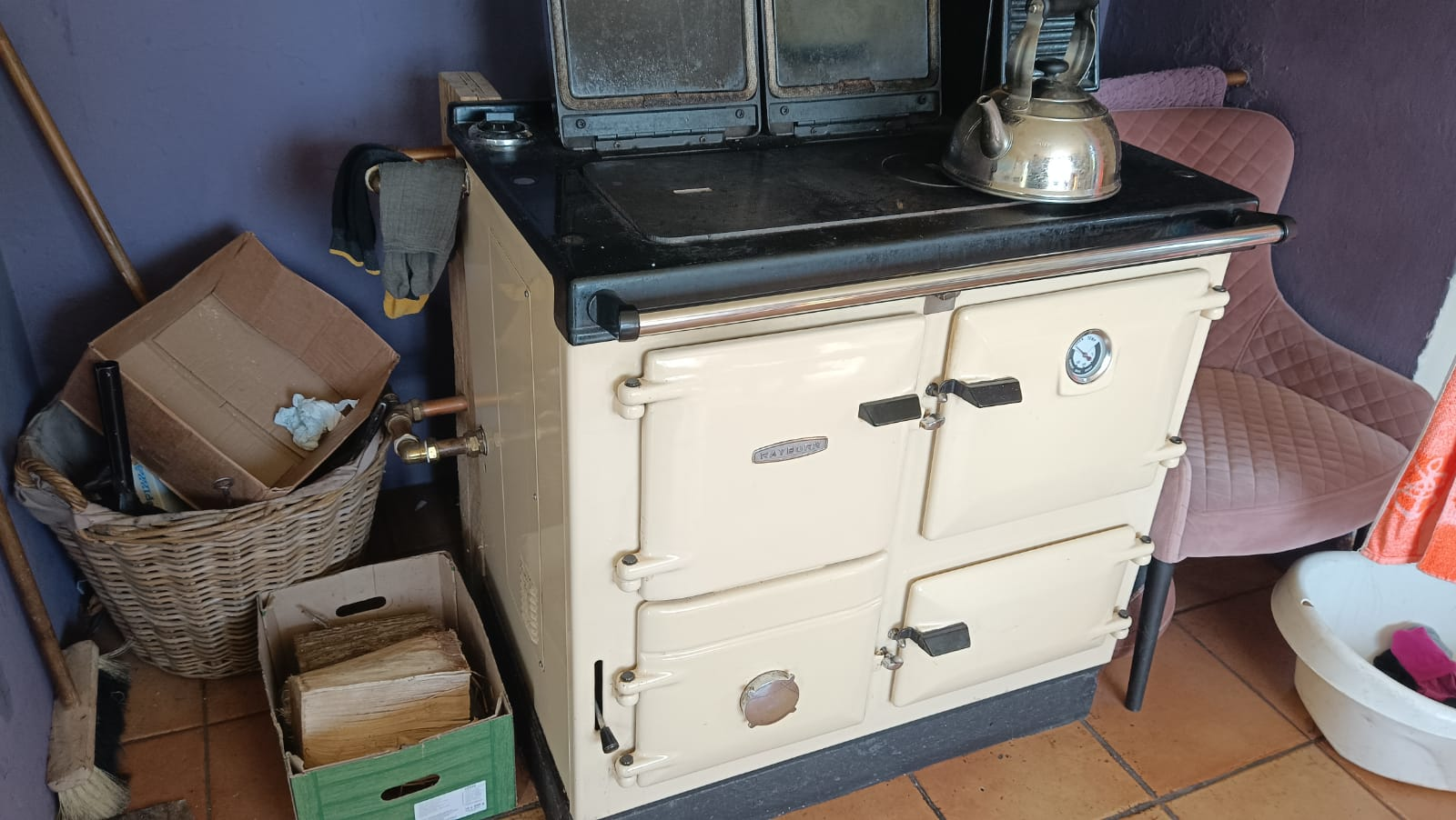

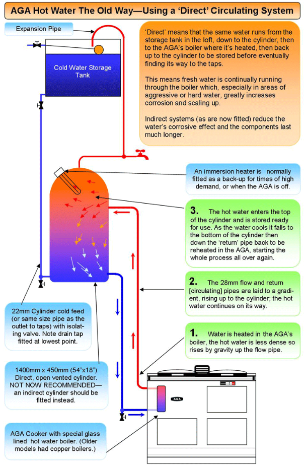

Iceverge Posted August 22, 2022 Author Share Posted August 22, 2022 Right now on to the DHW. There is a wood fired Rayburn 355SFW model. That feeds a direct copper cylinder via a gravity circuit. This in turn is fed by a fiberglass F+E tank. Here is a diagram of what I think is happening. Hope that helps clarify where we are. Link to comment Share on other sites More sharing options...

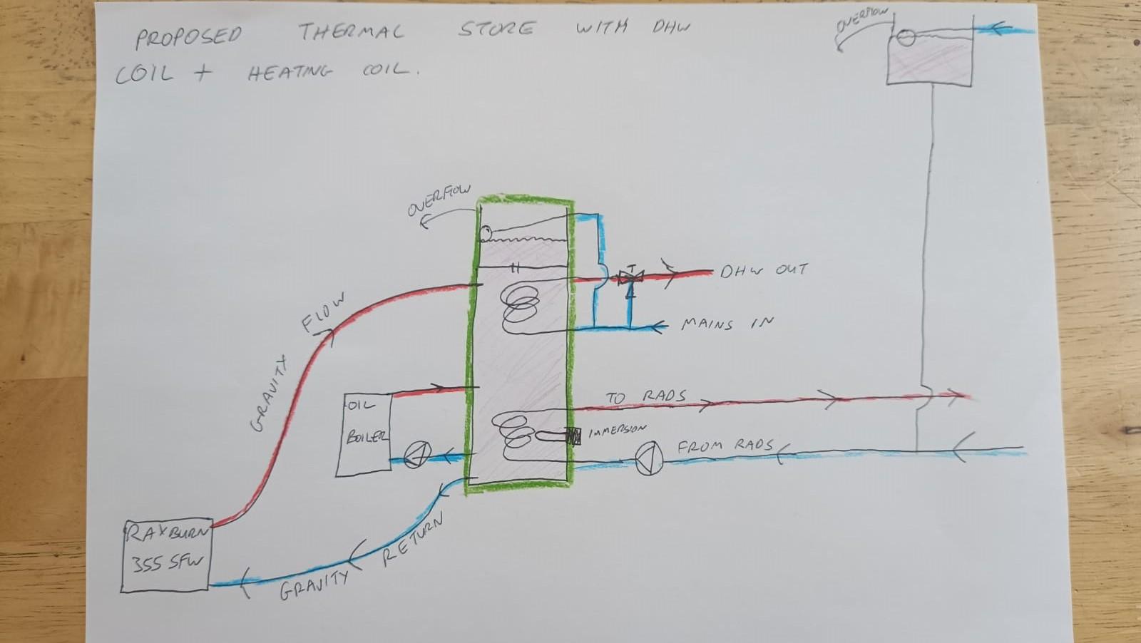

Iceverge Posted August 22, 2022 Author Share Posted August 22, 2022 Proposed Upgrade. 300l Combi type thermal store. Rayburn on Gravity direct Circuit. Oil Boiler on pumped direct circuit. DHW coil with thermostatic mixing valve. Heating Coil to accommodate upstairs rads using existing F+E tank. All commentary welcome. Link to comment Share on other sites More sharing options...
Spreadsheetman Posted August 22, 2022 Share Posted August 22, 2022 This reminded me of this blog http://mydreamhouse.co.uk/exotic-heating-systems/ where a thermal store was used. Something called a Laddomat had to be added to make the stove bit work properly. Link to comment Share on other sites More sharing options...
dpmiller Posted August 23, 2022 Share Posted August 23, 2022 It's a similar scheme to my own, but as well as using a Laddomat-style load unit, I've also chosen to use a stove with a cooling coil in it for boil protection. You might want to consider this safety aspect yourself- maybe using an STS valve to supply cold mains to the bottom of the store in the case of a catastrophic overheat? Link to comment Share on other sites More sharing options...
Nickfromwales Posted August 23, 2022 Share Posted August 23, 2022 I’ll need a pint in my hand before replying to this later. In the interim, is there 100% defo just the one header tank servicing the copper cylinder and Rayburn? Looks like it from the images, which send a shiver down the spine……. 1 Link to comment Share on other sites More sharing options...
Iceverge Posted August 23, 2022 Author Share Posted August 23, 2022 Yup........"The Old Way" however with a non lined steel boiler = Brown DHW 🤢 Link to comment Share on other sites More sharing options...
Iceverge Posted August 23, 2022 Author Share Posted August 23, 2022 6 hours ago, dpmiller said: You might want to consider this safety aspect yourself- maybe using an STS valve to supply cold mains to the bottom of the store in the case of a catastrophic overheat? No mains, just a pumped well so not an option in a powercut. Link to comment Share on other sites More sharing options...
Nickfromwales Posted August 23, 2022 Share Posted August 23, 2022 Heat circuit input connections to the cylinder just look too close together……. Link to comment Share on other sites More sharing options...
Iceverge Posted August 23, 2022 Author Share Posted August 23, 2022 Maybe a primatic cylinder? Link to comment Share on other sites More sharing options...
