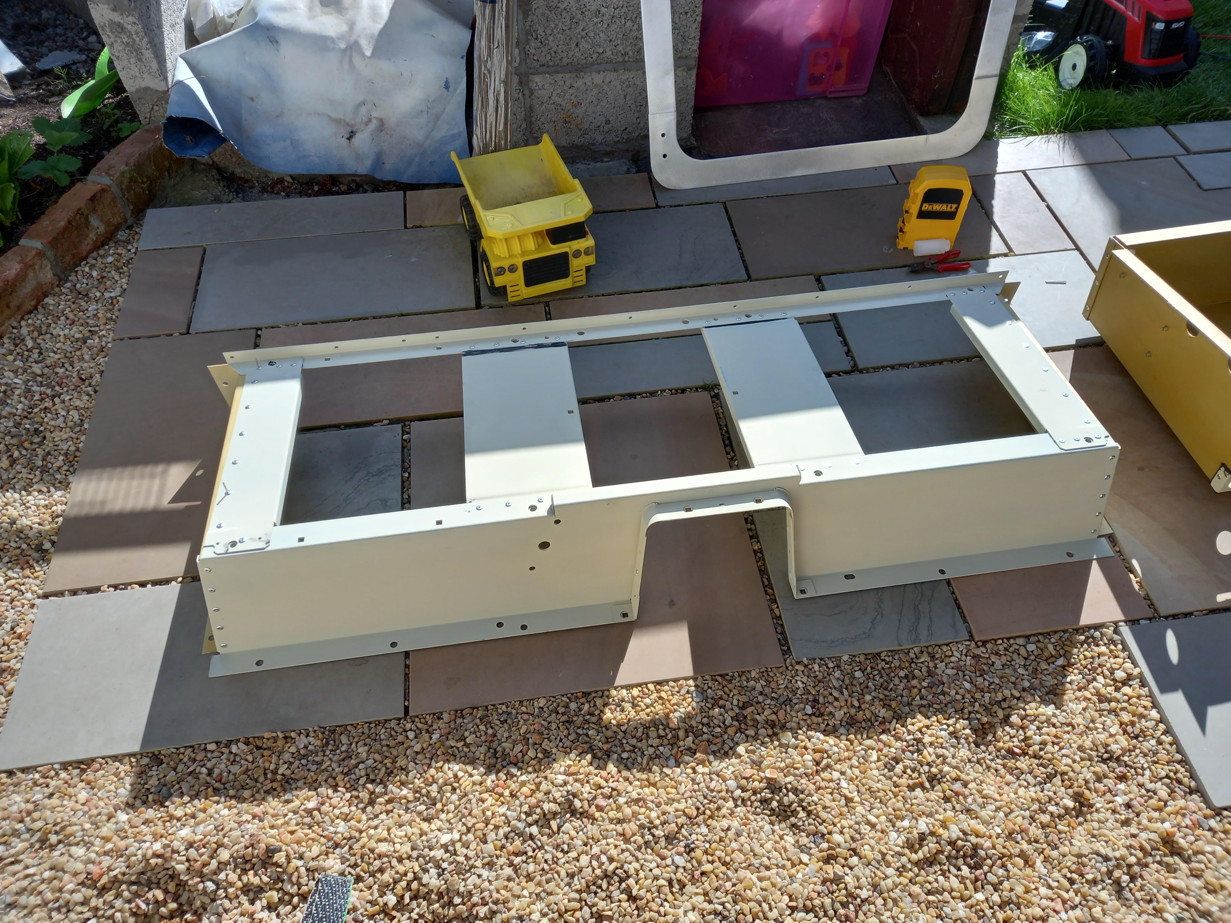

I was spraying 2k at the weekend, more to do tonight.
I spray paint most things that I need to paint, I work with everything from waterbased, cellulose, 1k and 2k (my favourite for a tough finish) - always have a fairly wide range in stock in my garage at any given time ready for most eventualities!
Weekends efforts in etch primer:

Amazing! That looks quality finish. I did etch primer and paint on my street twin few days ago :). It turns out to be quite good. What's your view healthy and safety wise on using 2k? I will be using my garage for it.

We will see how the weather holds up, if nice I will hit the top half of that (bottom done last night) with the 2K solid white paint - I'll post the results as I suspect you will be doing all this soon!
I really enjoy painting but it can be stressful, so do it when you have time, there is no such thing as a quick paint 5-10minutes to build the gun, mix the paint, 5 minutes for final degrease of items, maybe only 3 minutes of actual painting, with waiting time between coat, then you can spend 15 minutes cleaning the gun! In that time you also don't want anyone harassing our or even present without a mask - I usually do it when I am home alone and like a breeze to help carry away the fumes/paint dust.
Allow an hour for even 1 door, oddly, allow about the same for 4 doors.
