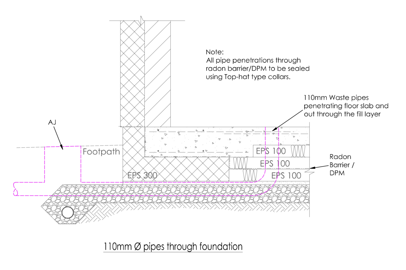

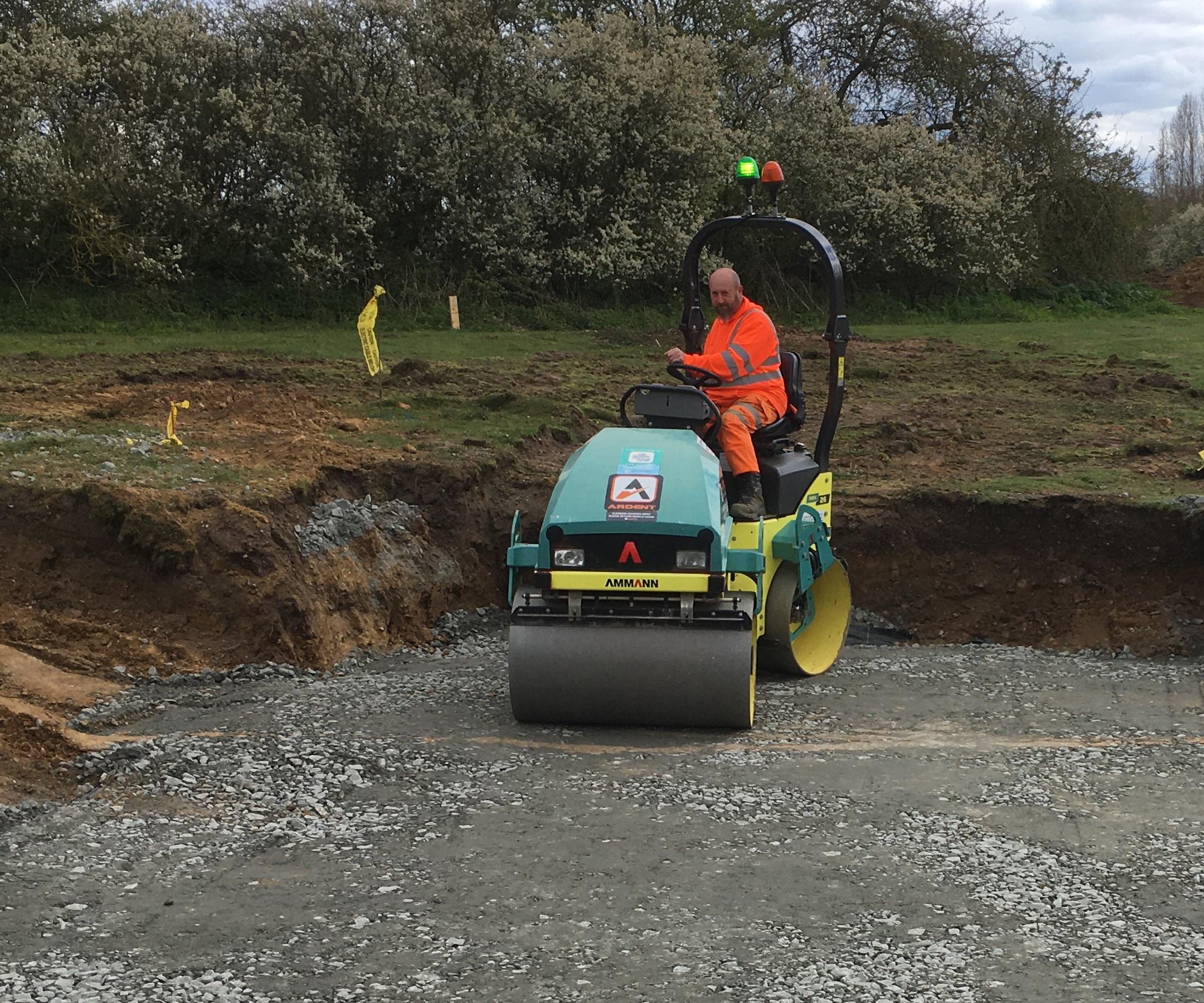

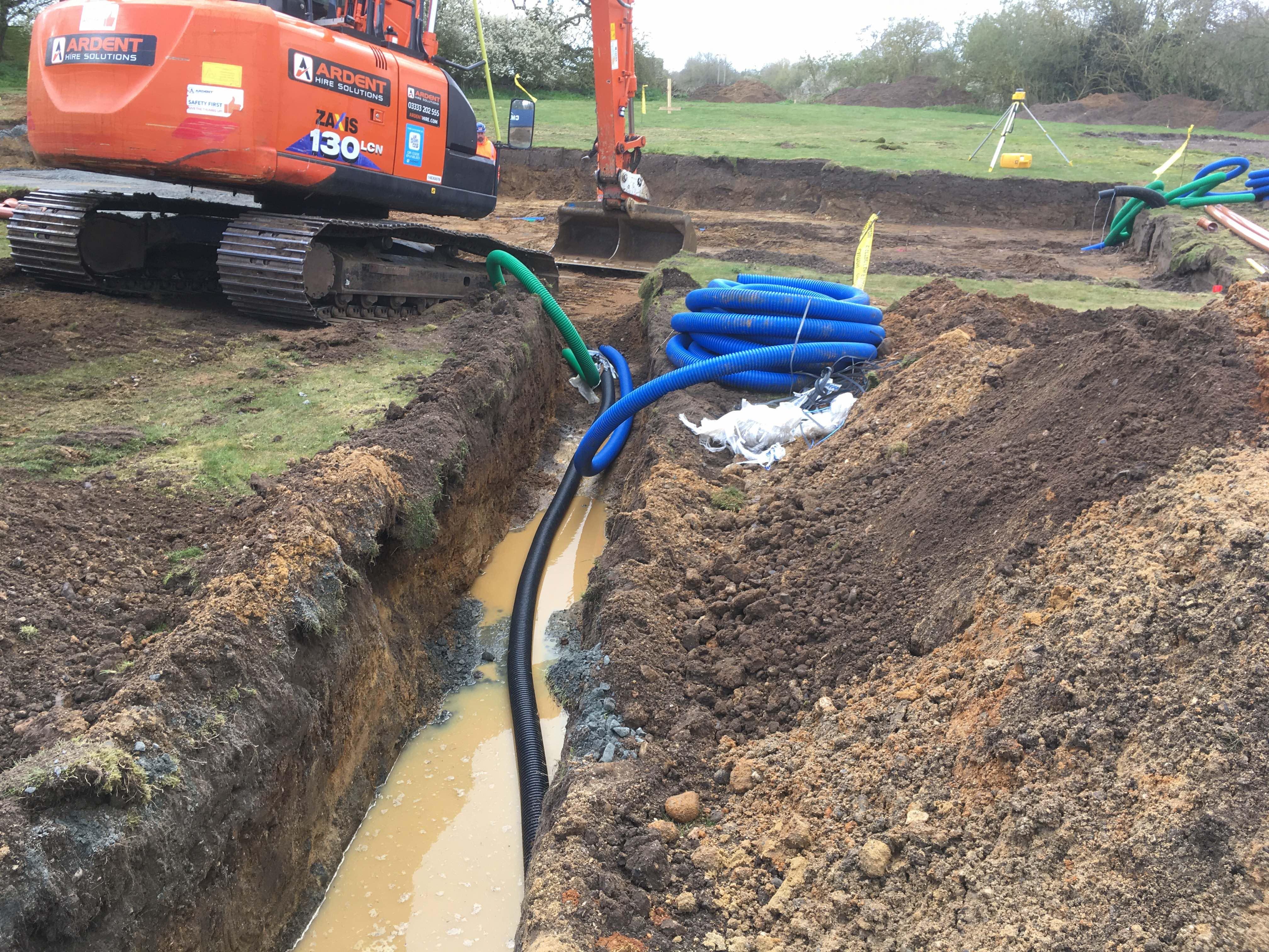

Nick Laslett Posted August 4, 2022 Posted August 4, 2022 (edited) Here are some details for the SVP from my foundation detail. Also a site photo. All of the services were in 110mm coloured ducting under the sub base in trenches in the ground about 900mm deep. We laid the insulated ASHP pipe in the MOT layer. Our build up was 300mm MOT type 3, with 50mm of sand, then 300mm EPS, then 150mm concrete. My groundworks guys were very clear on what was needed. We had some 63mm ducting for electrical cabling leaving the house to the Sewage Treatment Plant that was cut into the EPS layer as per the foundation design. 110mm ducting may be overkill for the mains electric but that is what they used. We also had services leaving the house to supply water, electric and data to the garage. Edited August 4, 2022 by Nick Laslett

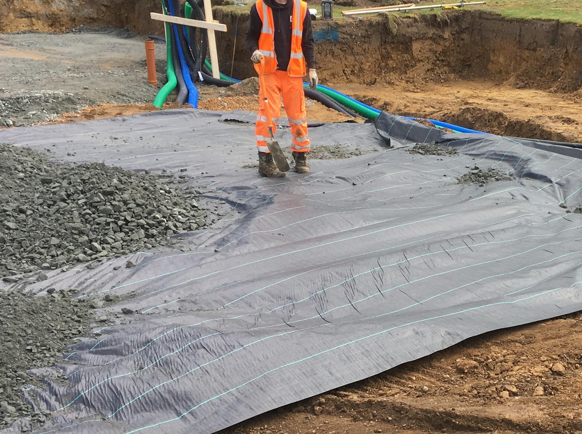

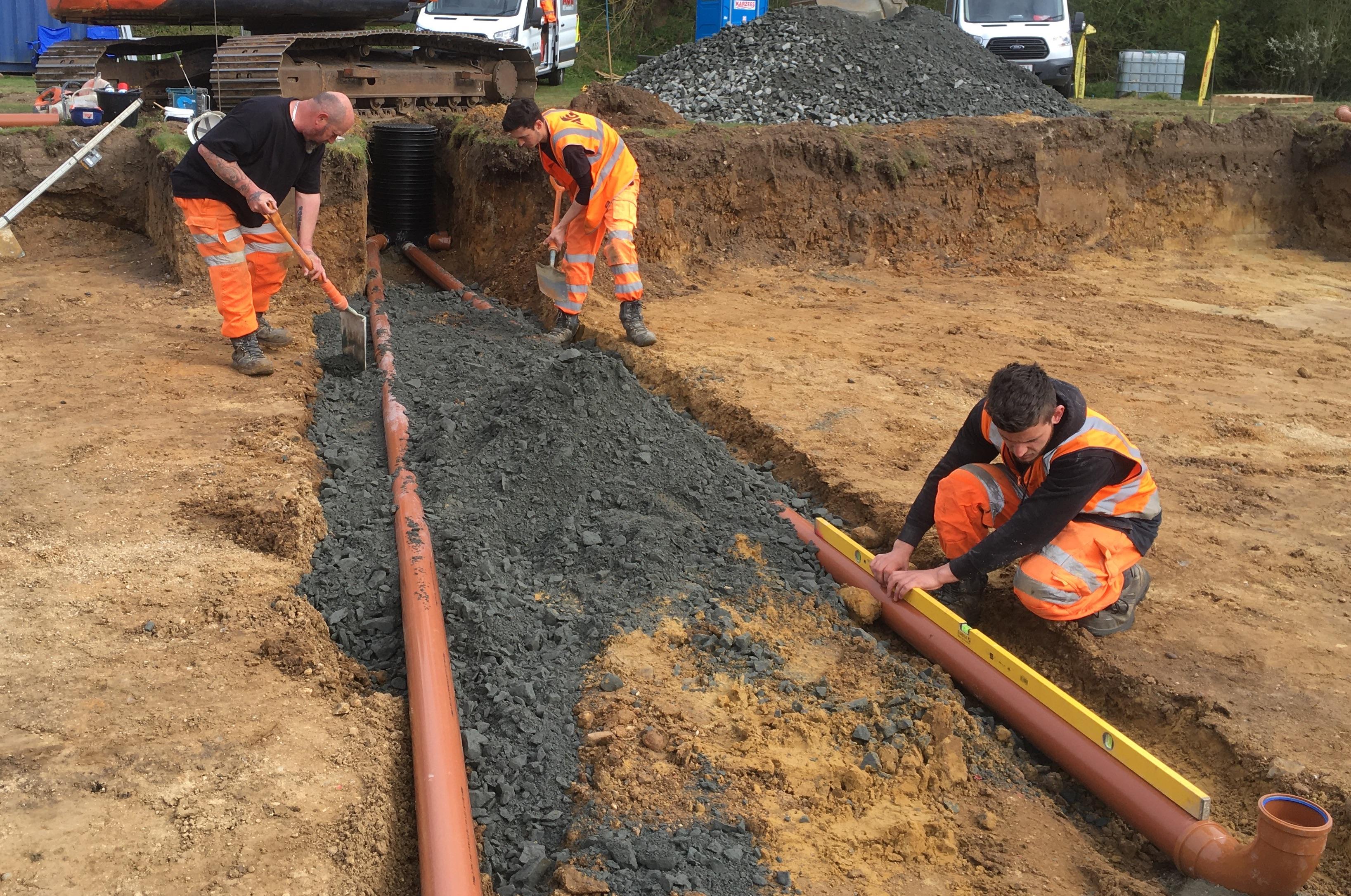

Nick Laslett Posted August 4, 2022 Posted August 4, 2022 (edited) A few more photos. Drainage being laid under the MOT Type 3. A cross section with geotextile, MOT Type 3 and ducts underneath. Edited August 4, 2022 by Nick Laslett

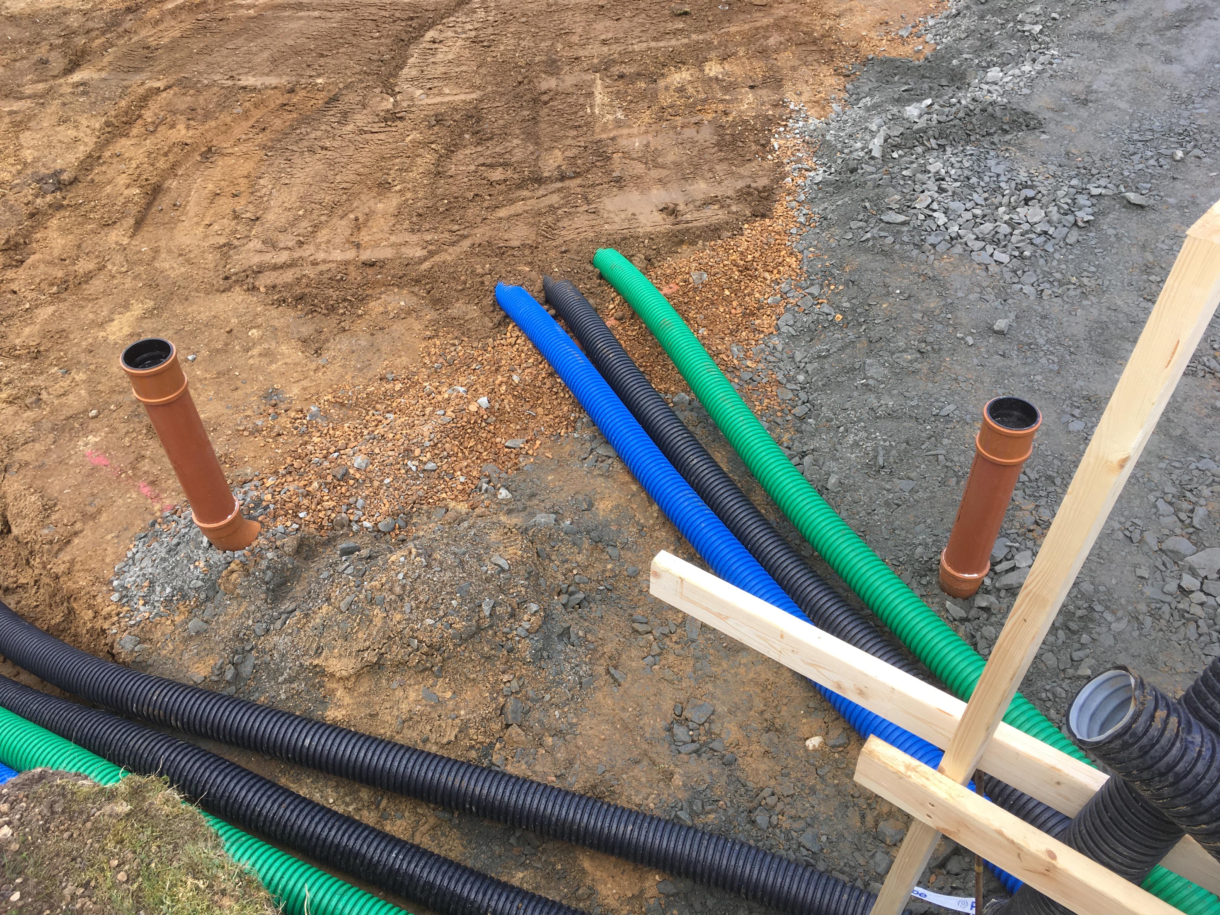

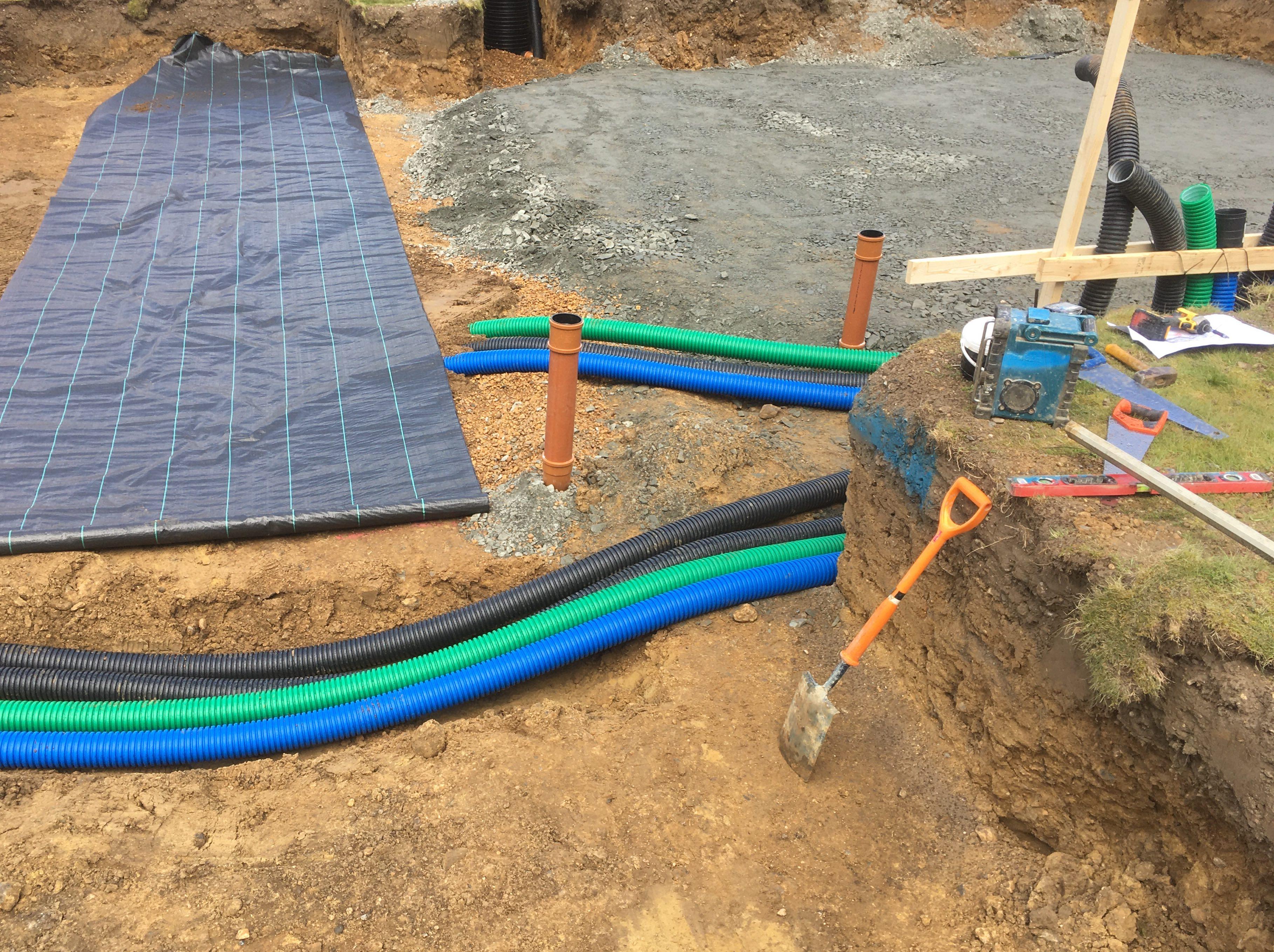

Nick Laslett Posted August 4, 2022 Posted August 4, 2022 (edited) We had an electrical kiosk on the perimeter of the site where the service entered the plot. Services trench. Edited August 4, 2022 by Nick Laslett

Field_of_Dreams Posted August 4, 2022 Author Posted August 4, 2022 @Nick Laslett Thanks for the pictures Nick...it really helps makes thing clearer in my head. I have about 550mm of MOT and a similar amount of insulation so I am about 875mm below DPC...the thought of going even deeper for the services is the bit I am having a hard time getting my head around 🙂 I was told not to run any pipes in the MOT as when it gets compacted, it can potentially cause damage. I guess that only applies to the solid pipes rather than the twin wall ones you show in the pictures? Thanks again for taking the time to post the pictures and all the info...truly appreciated.

Nick Laslett Posted August 4, 2022 Posted August 4, 2022 (edited) 23 minutes ago, Field_of_Dreams said: @Nick Laslett Thanks for the pictures Nick...it really helps makes thing clearer in my head. I have about 550mm of MOT and a similar amount of insulation so I am about 875mm below DPC...the thought of going even deeper for the services is the bit I am having a hard time getting my head around 🙂 I was told not to run any pipes in the MOT as when it gets compacted, it can potentially cause damage. I guess that only applies to the solid pipes rather than the twin wall ones you show in the pictures? Thanks again for taking the time to post the pictures and all the info...truly appreciated. I believe that the 110mm corrugated twin walled ducting can take a lot of weight. The spec sheet says 450N. I don't know what that means, but my ground workers did not seem that worried. The ducting was under the MOT. https://unitedcivilssupplies.co.uk/wp-content/uploads/2020/03/naylor-ducting-coil-data-sheet.pdf Here is the roller they used, I think it was 1.5 tonne. I think the vibration is the most important aspect of the roller not the actual weight. The Structural Engineer gave the following instruction: "Ride-On" vibrating roller - max layer depth = 150mm "Walk behind" vibrating roller - max layer depth = 100mm So they had to roller the MOT at 150mm, then add the 2nd 150mm layer and roll again. Edited August 4, 2022 by Nick Laslett
Field_of_Dreams Posted August 5, 2022 Author Posted August 5, 2022 @Nick Laslett thanks for the extra info. I see with the twin wall ducting you dont appear to have any "string lines" in them to help pull through the relevant cables/pipes. Did you run into any trouble getting the services through them? Im not even sure how you would get the line through them anyway considering the length of the runs...maybe there is a little trick?
Nick Laslett Posted August 6, 2022 Posted August 6, 2022 (edited) 9 hours ago, Field_of_Dreams said: @Nick Laslett thanks for the extra info. I see with the twin wall ducting you dont appear to have any "string lines" in them to help pull through the relevant cables/pipes. Did you run into any trouble getting the services through them? Im not even sure how you would get the line through them anyway considering the length of the runs...maybe there is a little trick? The 63mm ducting has string lines. The trick: Plastic bag and an air blower. Tie string to bag and use it a bit like a parachute. The air blower doesn’t even need to be that powerful. We used this in blower mode: https://makitauk.com/product/dvc750lz Here is an example using a Henry to suck the bag down the duct. Edited August 6, 2022 by Nick Laslett 1

Field_of_Dreams Posted August 6, 2022 Author Posted August 6, 2022 @Nick Laslett Is your twin wall all running in the same trench at the same depth like it appears in the picture? Im just trying to get my head around the different services and the different depths they are meant to be at but it would be so much easier if they could all be at the same depth and in the same trench. I am specifically talking about Electrics/Water/Fibre. Thanks

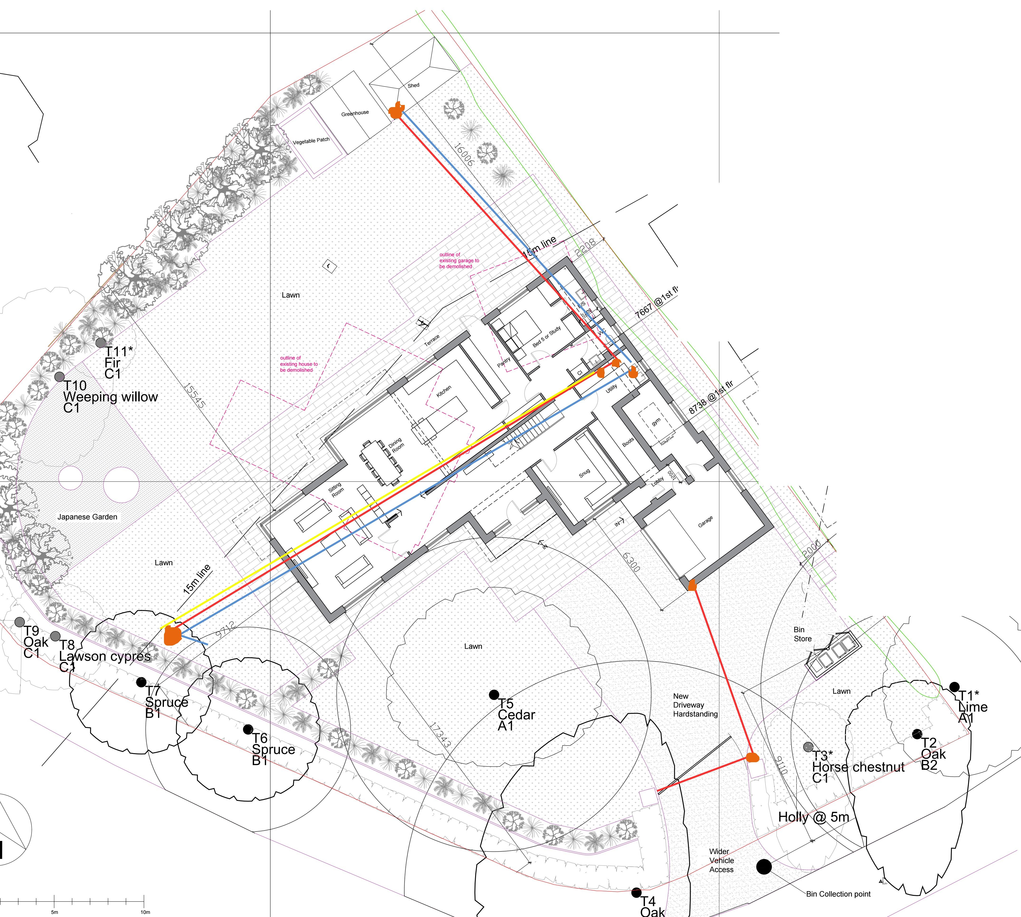

Renegade105 Posted September 25, 2022 Posted September 25, 2022 hi @Field_of_Dreams & @PeterW, I am about to start the KORE slab etc in a few weeks and am thinking the same questions. Apologies for the hijack... 1) External supply currently in a temp box. Do we need to run the DNO Service head outside of the building OR can it be inside? 2) If it has to be outside, then unfortunately I need a large distance of circa 25m to reach the main Consumer Unit inside the utility room. How can I run the wiring from the External box to the internal location, under the subbase in a corrugated pipe? I will be running 3 phase so any tips would be great (Yellow 100mm corrugated) 3) So I think I understand I will also need to run under the subbase corrugated long bends for the GAS and the Water, can you confirm what size and for the gas pipe, what is the pipe requirement for this nowadays? 4) I would like to run gas also to the external of the property, a Barbeque. I assume this is a no no and we have to use the Calor gas cylinders? 5) I have a shed which I would like to run power, cold water, what ducting is required, the corrugated type again 450mm below DPC and the outside grass? For the waste, I assume I just need to run it to an inspection chamber (the closest one?)
PeterW Posted September 26, 2022 Posted September 26, 2022 9 hours ago, Renegade105 said: External supply currently in a temp box. Do we need to run the DNO Service head outside of the building OR can it be inside? Depends on DNO but I would build a permanent kiosk for it where it is now and you don’t have 2 sets of connection charges. You also can’t run Waveconn inside a building unless it’s ducted in their spec and I doubt they will approve under a slab as there is no access. 9 hours ago, Renegade105 said: How can I run the wiring from the External box to the internal location, under the subbase in a corrugated pipe? I will be running 3 phase so any tips would be great (Yellow 100mm corrugated) Why 3 phase into the house ..? You only need a single phase in the house, use an external kiosk and split your phases (assuming car charger etc here) at the DNO kiosk. Also, yellow corrugated is Gas not electric so you need the correct ducting which is usually either black or red for electric 9 hours ago, Renegade105 said: So I think I understand I will also need to run under the subbase corrugated long bends for the GAS and the Water, can you confirm what size and for the gas pipe, what is the pipe requirement for this nowadays? Water can be run in either 110mm soil with a couple of slow bends on the ends, Gas has to be run where it can be seen/inspected OR can be run in a ventilated duct using TracPipe. Question would be though what are you using it for as your bigger issue will be a boiler flue - if that’s near a wall then bring the gas in on the same wall, don’t go under the slab. 9 hours ago, Renegade105 said: would like to run gas also to the external of the property, a Barbeque. I assume this is a no no and we have to use the Calor gas cylinders? that’s internal installation - ie after the meter - so one for your GSR installer but again, TracPipe and ventilated ducts 9 hours ago, Renegade105 said: have a shed which I would like to run power, cold water, what ducting is required, the corrugated type again 450mm below DPC and the outside grass? For the waste, I assume I just need to run it to an inspection chamber (the closest one?) How much power ..? And again, if you split at the DNO meter box you can use armoured to the shed. Water pipe should be 750mm for frost protection, 20mm MDPE in 63mm duct would be fine. Send waste to nearest IC. Question would be who has done the M&E design for this build as this all should be planned already..? And questions such as 3ph etc and the what / how are for DNO as they vary by region what they will allow.

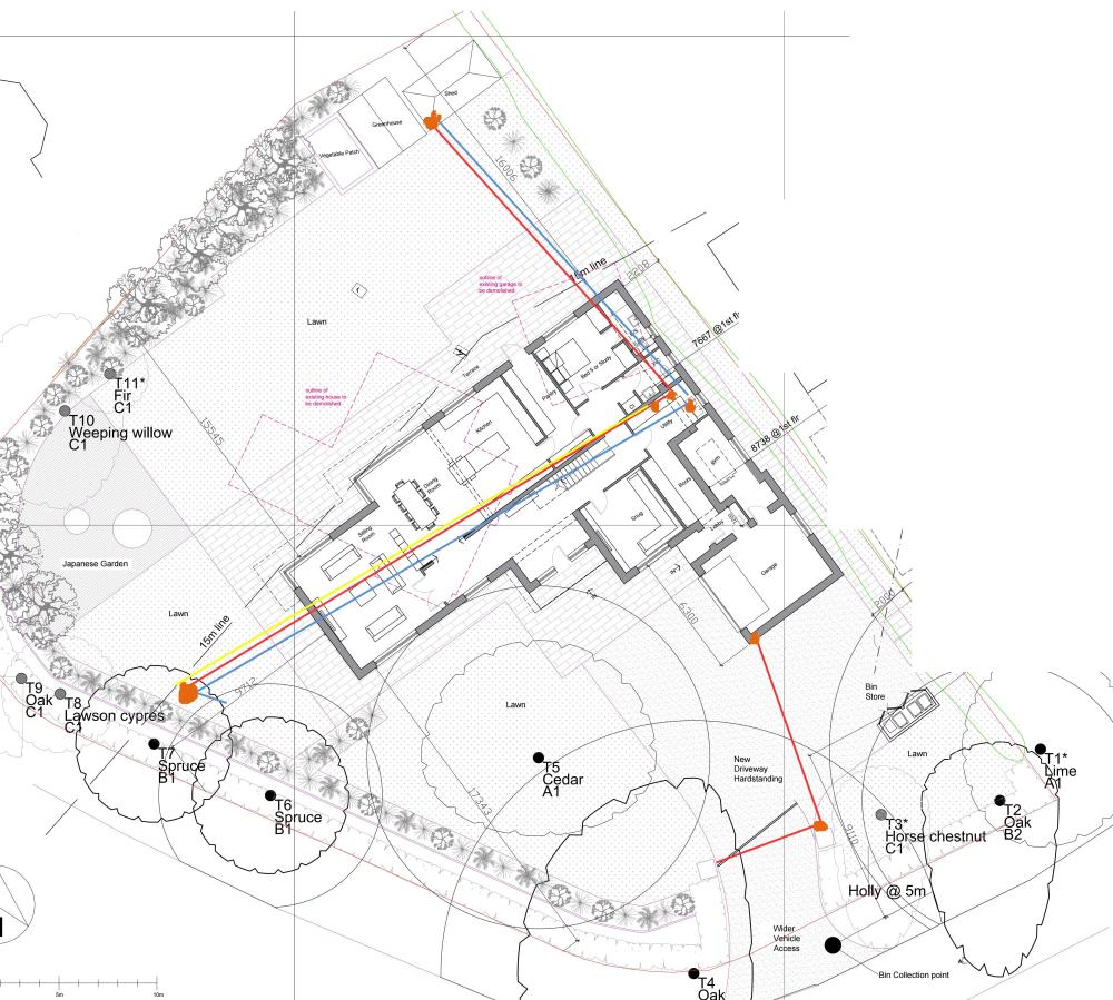

Renegade105 Posted October 5, 2022 Posted October 5, 2022 Hi, So, will have an external kiosk. Temporary are already on site now so will have to just build in for the 3-phase in the future. In the meantime, these are the duct runs that I think we need. Gas will go straight to the kitchen hob. Water and 3-phase electric to the Utility room, and I was thinking of running internal wiring to wherever it needs to go, so 1 phase out to the shed in the garden, and 3 phase out to the EV Point. Will want to have an electric gate so that too will need power, which I assume will need to be laid underground too. Solar PV will run down from attic to the utility room too. I think I know I will ask them to run the 4" ducting for the electric and water to the utility room, and then another to the shed. This would need to be in the sub-base beneath the KORE Foundation? Also, for the gas pipe, how would you recommend getting it to the kitchen? As ever, your help is much appreciated. As you can see, I have not paid for an M&E so I am stuck with making these decisions with the groundworkers for now and I will of course confirm with the builder's electrician and gas safe plumber as soon as I can.
