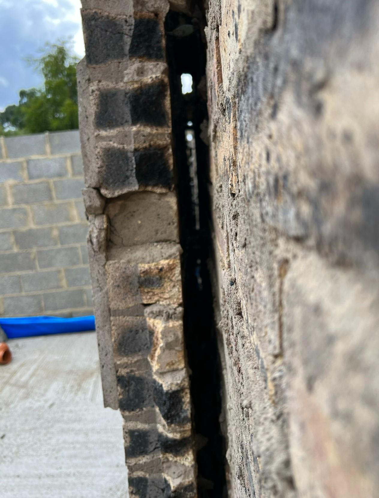

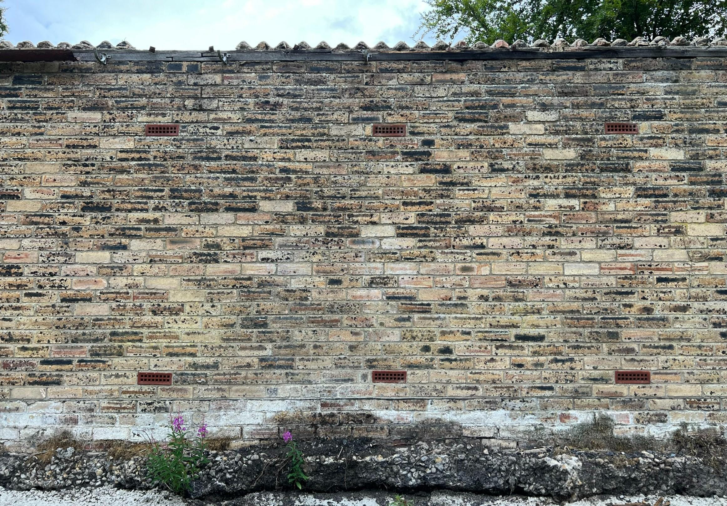

We are converting an old mining pit pony stable and we cannot knock down the building and rebuild it, even though it's in a poor state. Thas said, we are allowed to cut out large windows and 2 reasonable sized extensions on the rear, which means there wont be much of the original rear wall anyway.
The building has many air vents, both internally and externally, on the rear and we will be blocking the internal ones but we are uncertain on the outside ones. I have asked the question of my architect but he isnt really sure. The cavity wall gap is about 5 cm and in the interests of preventing issues down the line, we will be leaving the cavity empty and insulating form the inside, despite my desire to insulate as much as possible. My feeling is that the vents are more for venting air whilst it was used as a stable. There are no vents on the front of the building, purely on the rear.
Any thoughts on blocking these external vents ?

I would leave them in to ventilate the cavity and keep the wall dry.
Thanks foe that advice, although I must admit it's probably not what I wanted hear. They are both at the top and bottom of the wall so would you think I would need both ?
Similar concept to a chimney I would guess - needs ventilating top and bottom.

As others have said, leaving the outer leaf vents open will allow for stack ventilation of the cavity.
The ventilation pathway is for the outer leaf only, through the lower vent, up the cavity and back out again. The inner leaf can safely be sealed up and insulated internally.

Yeah, so a modern cavity wall differs because the bricks and mortar will be less porous than older walls. They are also usually as least partially open at the top with the wall plate being connected on the inner leaf, meaning the cavity has some pathway to the outside world.
There also won't be any sort of tray or weep holes in OP's wall so keeping the existing air vents is a sensible precaution.
Lastly, if they are insulating internally, having a high level of ventilation in the cavity will keep the moisture gradient, drawing any water vapour out and away from the inner leaf.

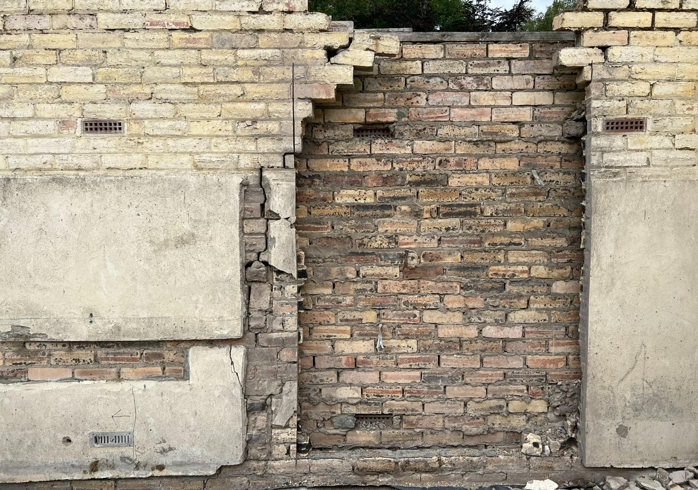

I should have noticed this before but as I didn’t cut out the inner walls I never noticed.

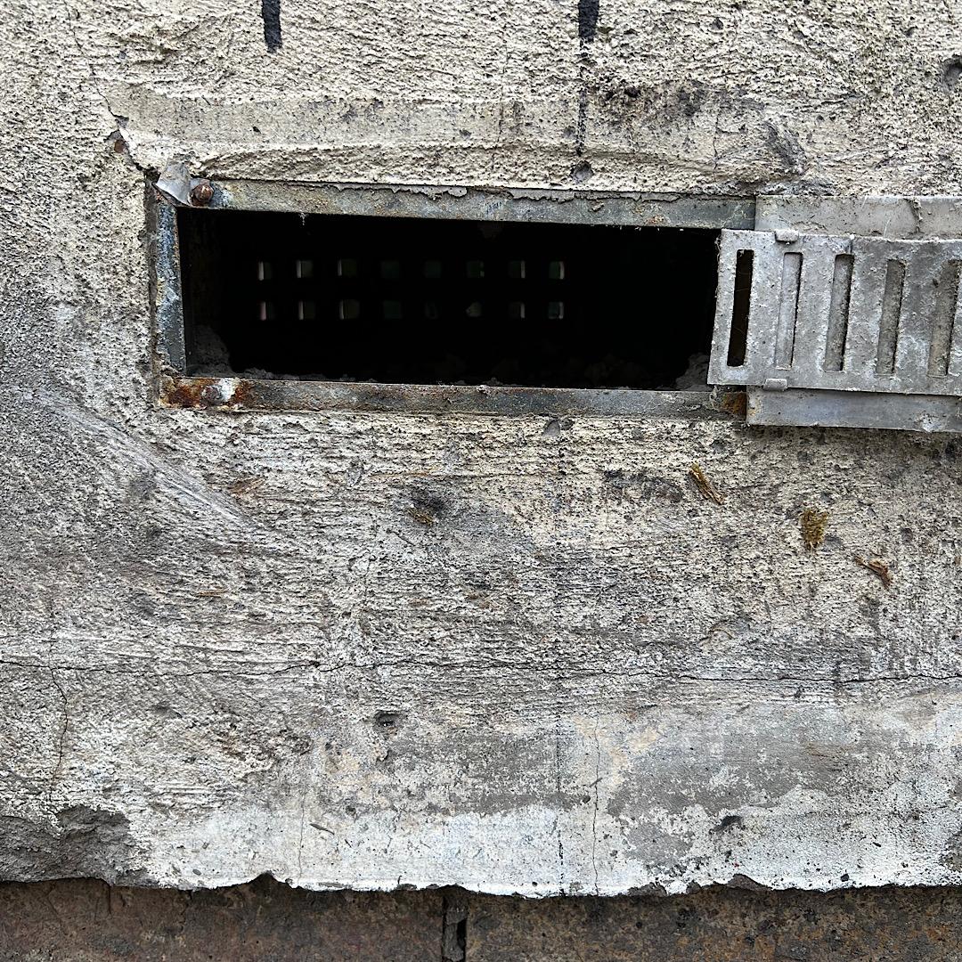

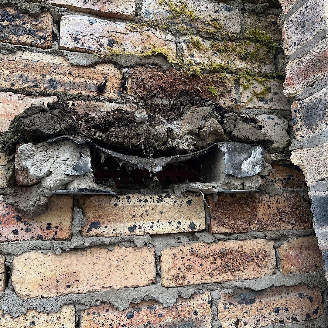

Turns out the vents don’t vent into the cavity but into the building itself. Seems like it was along the lines of what Jilly mentioned previously being for the horses. Each vent has a sort of brick / cement surround forming a tunnel directly into the building. This fact may change my mind.
In that case yeah get rid of the whole thing. Hopefully you've got some spare bricks to repair the holes on the outside.
