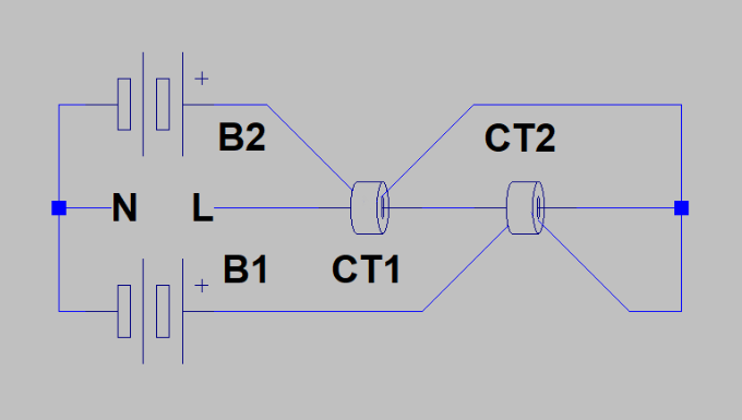

SteamyTea Posted July 31, 2022 Posted July 31, 2022 31 minutes ago, Radian said: Am I being silly or is it as simple as this I am not sure if silly is the right word. If each CT is sensing current from each AC circuit, does it not just cancel out and then end up doing nothing? Take away the CTs and associated wiring, then it is just two batteries banks in parallel. which is what I have been trying to say, without actually saying it (as the conversation had moved on).
Radian Posted July 31, 2022 Posted July 31, 2022 (edited) 1 hour ago, SteamyTea said: If each CT is sensing current from each AC circuit, does it not just cancel out and then end up doing nothing? That cancellation is exactly what I think is needed to fix the problem. If the PW can't see the power flowing into the SE then it won't push up its output voltage to try and supply it. And the same is true for the SE. Edited to repost the schematic to make the cables passing through the CTs clearer: Edited July 31, 2022 by Radian
SteamyTea Posted July 31, 2022 Posted July 31, 2022 8 minutes ago, Radian said: That cancellation is exactly what I think is needed to fix the problem. I hate NAND and NOR. I have not been following this too closely, apart from the kwh/kw/KW/KWH/kwH/Kw/killawotour. Is it the software and how it reports that is the main problem? It may be give a very false impression of what is actually happening, when in reality, PV is being stored when there is excess, when the batteries are low, they can charge at night, sufficient power is being delivered to the house and little is exported. What @pocster needs it to make one of my energy monitors, then he can see what is really happening. (I am not developing a crapple version).

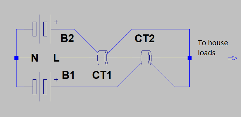

Radian Posted July 31, 2022 Posted July 31, 2022 5 minutes ago, SteamyTea said: I have not been following this too closely, Me neither because I'm incredibly jealous of all that luverly kit 🤣 Glancing at my schematic again, I realise that I'm taking it for granted that people understand that the house loads come off at the far right of the 'L' cable although not shown. This diagram only shows the relative locations and wiring for the two battery systems. Also, I think the SE system is a hybrid inverter but it should only have the one connection point to the AC so can be considered as a 'self charging battery' for our purposes here.
MikeSharp01 Posted July 31, 2022 Posted July 31, 2022 6 minutes ago, Radian said: Glancing at my schematic again, I realise that I'm taking it for granted that people understand that the house loads come off at the far right of the 'L' cable although not shown Have you shared that somewhere I must have missed it.
Radian Posted July 31, 2022 Posted July 31, 2022 Just now, MikeSharp01 said: Have you shared that somewhere I must have missed it. Er, Are my picture attachments not showing up? How about this one...
MikeSharp01 Posted July 31, 2022 Posted July 31, 2022 Sorry it was above I must have missed it - only England beating Germany at football on the telly so not sure why I missed it.
RobLe Posted July 31, 2022 Posted July 31, 2022 2 hours ago, Radian said: Er, Are my picture attachments not showing up? How about this one... That's a very interesting arrangement, but I'm not sure that will do what you want. As an aside, you may find it difficult to fit 2 thick cables through the clamps. Anyway - considering the power into B1, B2, and House - I think the schematic above, with knowledge that B1 is trying to null CT1, will create 2 equations: B1=-House B2=-House Thus the overall power from the Live Tail will be the sum of B1, B2, and House: B1+B2+House = -House. The units will each independently compensate the house, but that's unlikely to be what you want, as you've gone too far and are still interacting with the grid. In contrast, the version I intended a while back gives equations: B1=-House B2=-House - B1 Thus the overall power from the Live Tail will be: B1+B2+House = -House-House-B1+House = -House-House+House+House = 0 No current at the tail, just what we want I think 🙂 Honest.

Radian Posted August 1, 2022 Posted August 1, 2022 19 hours ago, RobLe said: I think if the PW clamp were after PW+House+PV, then SE clamp after PW+House+PV+SE that this stops the PW responding to the SE as it can't "see" that current flow. The SE can still respond to the PW - but the overall feedback loop is broken, so I think this might fix it 🙂 One of the home batts will be exercised much more than the other doing this - the way around I described it, the PW will do all of the work until it cannot, being full or empty or having too high power flow, then the SE will mop up the rest. Hi RobLe, in trying to understand your suggested scheme I couldn't work out what you meant by 'after'. But I suspect the issue is that, as being near-identical generators and consumers of power, no asymmetric arrangement of clamps is going to produce symetrical results. Pocster needs both storage systems to bank-up charge in the narrow off-peak window. 9 hours ago, RobLe said: Anyway - considering the power into B1, B2, and House - I think the schematic above, with knowledge that B1 is trying to null CT1, will create 2 equations I don't follow. B1 is not nulling CT1, it would defeat the operation of the composite device. CT1 belongs to B1 and must see everything going in or out of it! What happens in the arrangement I'm proposing is that B1's operation is invisible to B2 and vice-versa.

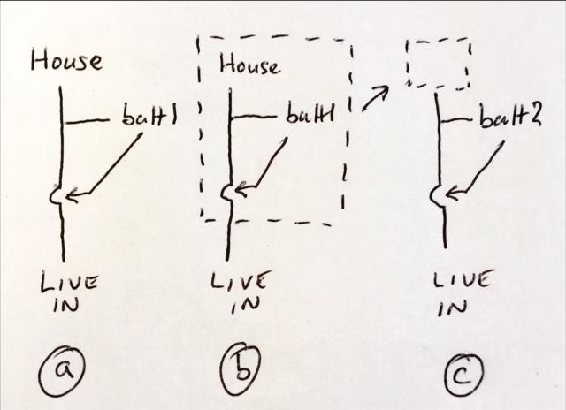

RobLe Posted August 1, 2022 Posted August 1, 2022 I'm going to have another go at convincing people 🙂 The pic below is in 3 parts, showing a progression of the idea in my mind, and without pesky equations: a) is as the manufacturer intends, batt1 having a CT on the tail before it, so that it can identify the power flow and try to make it zero on average. It's doing a lot of maths and clever power electronics to achieve this, but we don't need to know about that. A bit of power sneaks in and out on transients, but otherwise it does a good job. b) is just like (a), but I've put a dashed box around the house+batt, and now we are just going to ignore what's inside - it all just works in isolation - any interactions are inside that box, and ultimately just give or take power from the grid. Importantly, nothing from outside the box affects the inside (neglecting stuff like the grid is broken etc). c) now we apply another battery, but you can see that box from (b) replaces what was just "house" in (a). So batt2 should work, just as well as batt1 in (a). As described before, the 2nd batt won't do much work - the first will preferentially absorb PV and make the tea, 2nd batt only operating when the 1st for some reason cannot. 🙂
SteamyTea Posted August 1, 2022 Posted August 1, 2022 23 minutes ago, RobLe said: I'm going to have another go at convincing people Can see what you are getting at, but does it not assume that all potentials are always equal? Secondary supplies need to be at a higher potential or nothing happens, and when they are lower, they absorb energy. Maybe the PW and SW are always at the same potential (or try to be), which is slightly higher than grid potential. Or worse, they fight each other to be the top one.

RobLe Posted August 1, 2022 Posted August 1, 2022 1 hour ago, SteamyTea said: Can see what you are getting at, but does it not assume that all potentials are always equal? Secondary supplies need to be at a higher potential or nothing happens, and when they are lower, they absorb energy. Maybe the PW and SW are always at the same potential (or try to be), which is slightly higher than grid potential. Or worse, they fight each other to be the top one. You don't need to worry about the voltages - the PW and SE will do all of that complicated stuff with their power electronics and control algorithms. All you need to know is that the PW is trying to minimise the power flow through its CT; it will put out whatever current at whatever voltage is required to achieve this. Imagine that you sublet a room in your house, where you had a single power feed in, and there was a PW battery, and a kettle which somebody turned on and off, maybe even a bit of PV. The PW battery would effectively power the kettle. You might not even know that they had done this, inside their sublet room. Then imagine you fitted an SE battery to your whole house - this would work too, but nothing it does will affect the PW operation.
Radian Posted August 1, 2022 Posted August 1, 2022 36 minutes ago, SteamyTea said: Can see what you are getting at, but does it not assume that all potentials are always equal? Secondary supplies need to be at a higher potential or nothing happens, and when they are lower, they absorb energy. That's right. I suspect Pocster's install is wired in exactly the way RobLe shows it in (c) although which is batt is PW and which is SE is unclear. But it doesn't matter. It's the job of each battery to supply the power demand in preference to the grid except for when it is set to absorb power at off-peak times. Neither battery system can distinguish the house load from the other battery system if that battery system is being charged - therefore, if not actively charging itself, it will attempt to provide power for the other batteries charge. Again, it's a highly symmetrical problem so is unlikely to yield satisfactorily to an asymmetric solution. 1
Radian Posted August 1, 2022 Posted August 1, 2022 1 hour ago, RobLe said: Imagine that you sublet a room in your house, where you had a single power feed in, and there was a PW battery, and a kettle which somebody turned on and off, maybe even a bit of PV. The PW battery would effectively power the kettle. You might not even know that they had done this, inside their sublet room. Then imagine you fitted an SE battery to your whole house - this would work too, but nothing it does will affect the PW operation. Except for it's insistence on charging the PW in the sublet during off-peak tariff time if PW is in need of charge and SE isn't. This is what annoys poor old Pocster so much becuase he doesn't want them exchanging their power reserves - ever! 1
