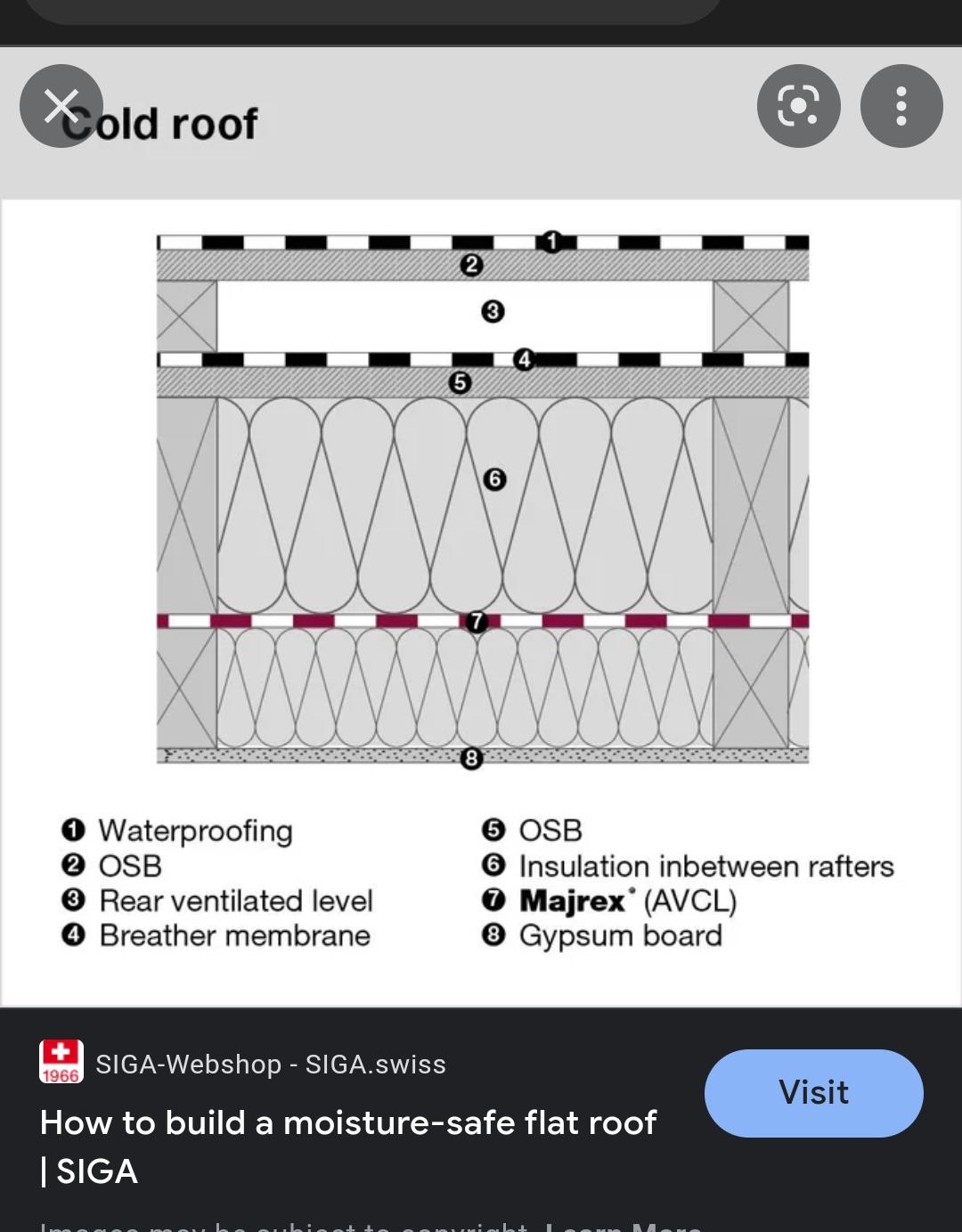

Iceverge Posted August 6, 2022 Share Posted August 6, 2022 (edited) Any pics/sketches/diagram's of what you propose? It sounds like a hybrid approach. If you could ensure a robust airtight/vapour control layer and a fully breathable build up outboard with a ventilation layer between the final roofing and the sarking I would see no problems. I'm sure the "it'll rot to pieces" brigade will be along soon to correct my erroneous ways. Have you considered blown cellulose between the joists? Perfect fill, cheap and excellent in almost every way otherwise. I think Siga have some details. I'll check...... Edited August 6, 2022 by Iceverge Link to comment Share on other sites More sharing options...
Iceverge Posted August 6, 2022 Share Posted August 6, 2022 There's one. Link to comment Share on other sites More sharing options...

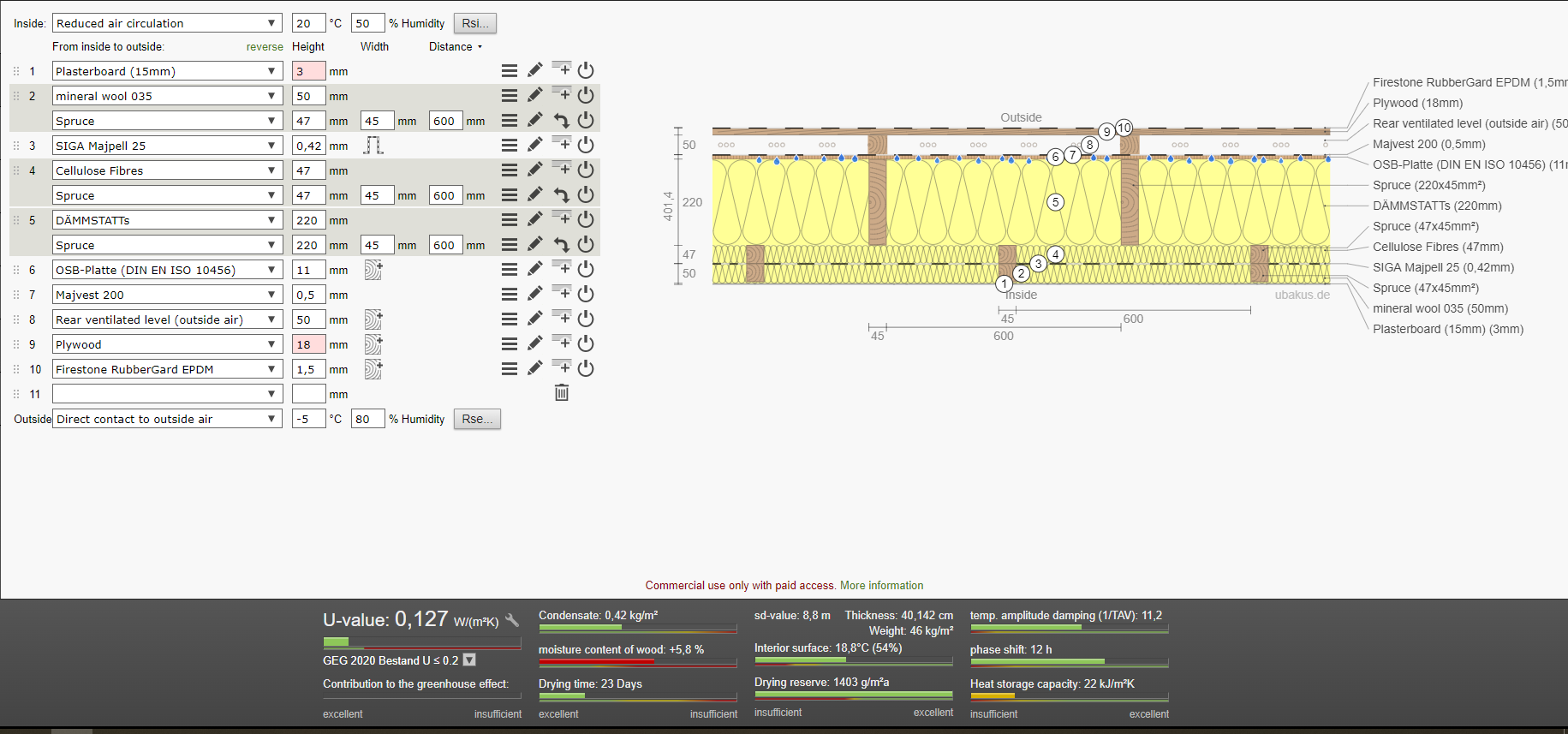

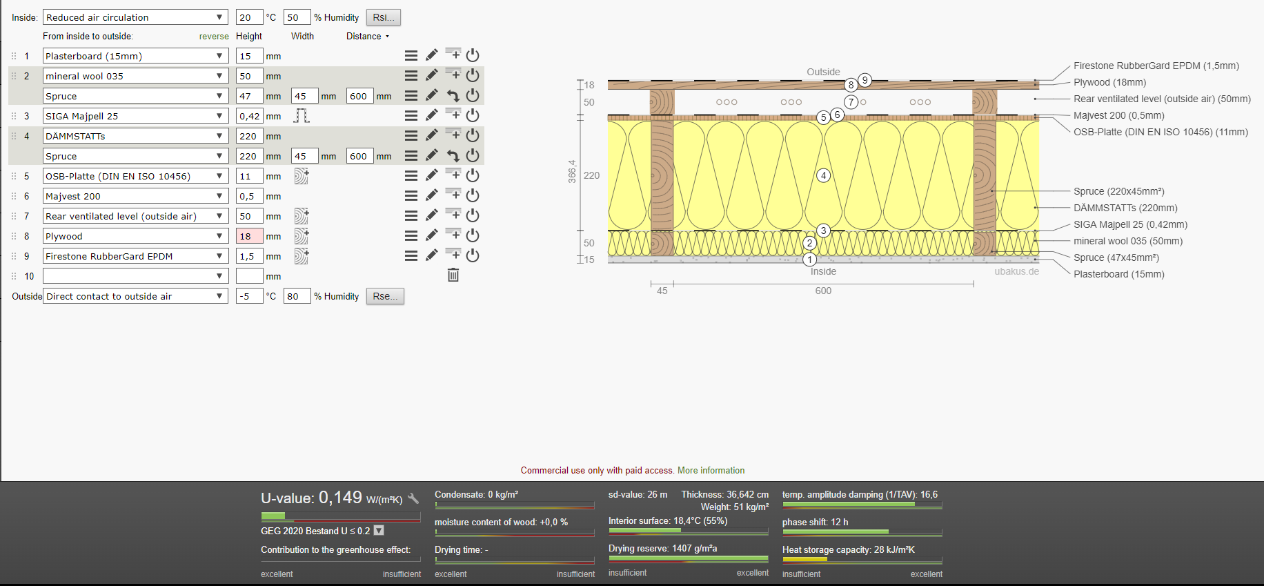

Iceverge Posted August 6, 2022 Share Posted August 6, 2022 I've re-read your post.... My idea for something cheap and good. EDPM OSB/PLY, 50mm battens for ventilation layer, Fully taped breather membrane. OSB 225mm joists filled with blown cellulose. Vapour control layer. 47mm battens at 600cc for service cavity with 50mm batt insulation. 15mm plasterboard. U-value about 0.15-0.16. To upgrade the U-value counter batten above the VCL with another 47mm batten and increase the layer of cellulose. Should be a U value of about 0.14 with excellent airtightness and decrement decay. Thermal bridging etc All nail gun friendly too and no exotic expensive materials. I would avoid the faff of furring strips and slant the whole roof if you could live with the aesthetic of a slanty ceiling. Link to comment Share on other sites More sharing options...
Adsibob Posted August 7, 2022 Share Posted August 7, 2022 11 hours ago, Iceverge said: I've re-read your post.... My idea for something cheap and good. EDPM OSB/PLY, 50mm battens for ventilation layer, Fully taped breather membrane. OSB 225mm joists filled with blown cellulose. Vapour control layer. 47mm battens at 600cc for service cavity with 50mm batt insulation. 15mm plasterboard. U-value about 0.15-0.16. To upgrade the U-value counter batten above the VCL with another 47mm batten and increase the layer of cellulose. Should be a U value of about 0.14 with excellent airtightness and decrement decay. Thermal bridging etc All nail gun friendly too and no exotic expensive materials. I would avoid the faff of furring strips and slant the whole roof if you could live with the aesthetic of a slanty ceiling. This is a good build up, but I think wood fibre has a better decrement delay than blown cellulose. At least according to ecomerchant.co.uk: insulation materials offering a high decrement ‘factor’ include cellulose fibre (7.3 hr), wood fibre insulation board (11.3 hr); whereas materials with a low decrement factor would include low-density mineral fibre (3.7 hr) and polyurethane/ polystyrene. Link to comment Share on other sites More sharing options...
SimonD Posted August 7, 2022 Share Posted August 7, 2022 (edited) 13 minutes ago, Adsibob said: This is a good build up, but I think wood fibre has a better decrement delay than blown cellulose. At least according to ecomerchant.co.uk: insulation materials offering a high decrement ‘factor’ include cellulose fibre (7.3 hr), wood fibre insulation board (11.3 hr); whereas materials with a low decrement factor would include low-density mineral fibre (3.7 hr) and polyurethane/ polystyrene. No, the wood fibre insulation board referred to by ecomerchant is a different product compared to the between rafter wood fibre bats. In this case, blown cellulose is by far the better option. The high decrement delay woodfibre boards are those that are usually installed above the rafters and form a sarking so you end up with a hybrid warm roof - very good for reducing repeated cold bridges too. Edited August 7, 2022 by SimonD Link to comment Share on other sites More sharing options...
