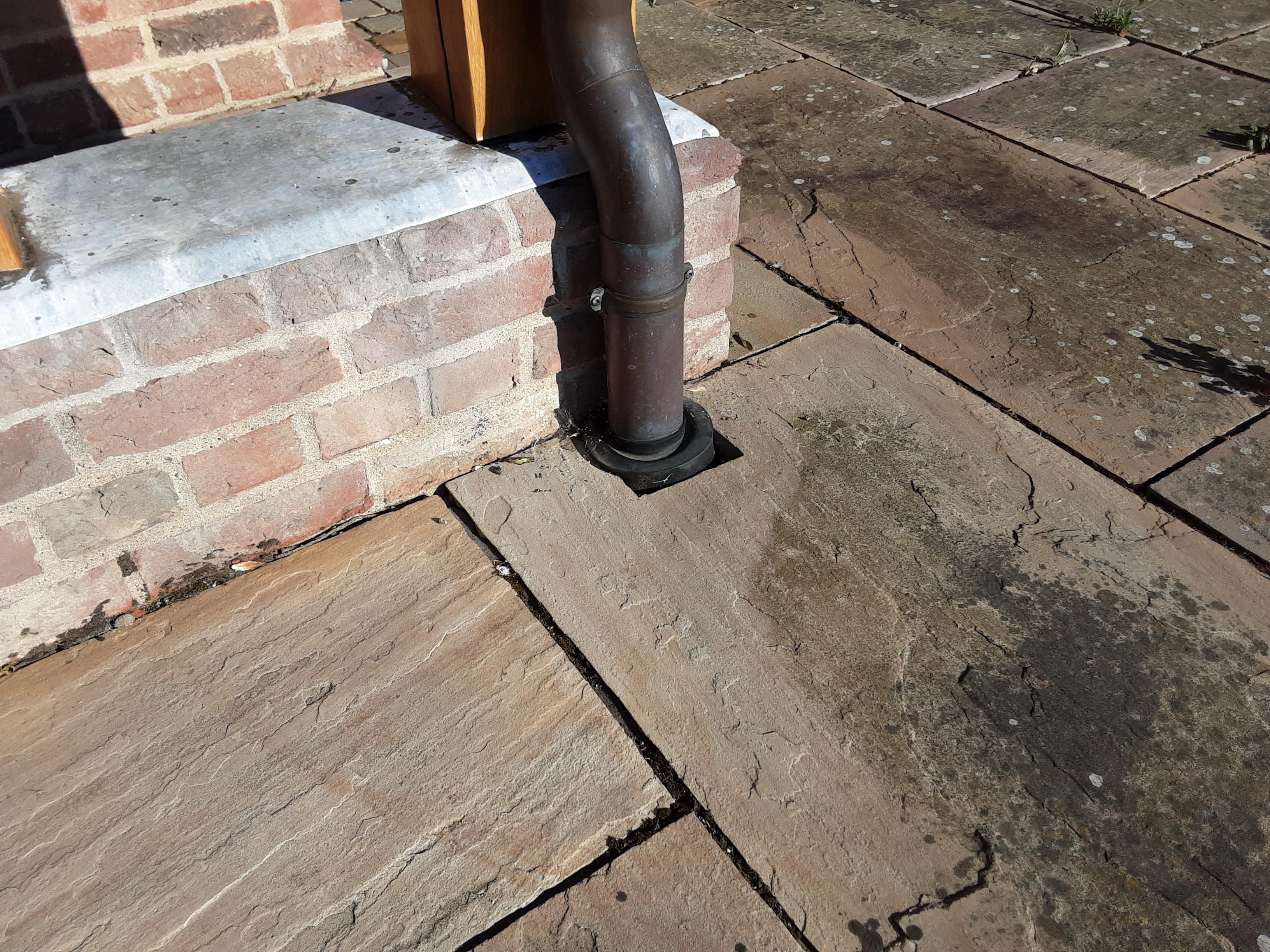

This is what we did. Down pipe into 110mm with rubber adaptors. Have lots of trees and leaf fall but never been a problem..
From there the water goes to a leaf filter and rainwater tank. Overflow to piped ditch in the road verge.
