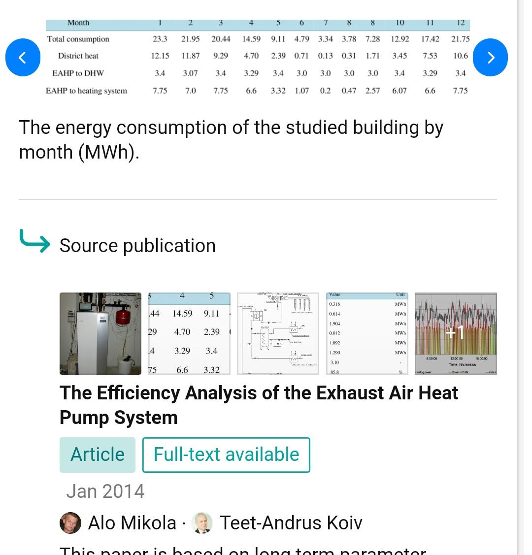

https://www.researchgate.net/publication/276499152_The_Efficiency_Analysis_of_the_Exhaust_Air_Heat_Pump_System
Reckons the winter COP will be about 3 and summer about 3.4 .
Heating far superior. COP of 7!!!!
The case for heat pumps for DHW isn't as clear as space heating.

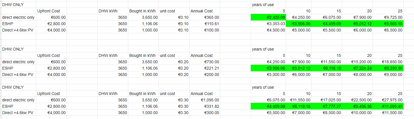

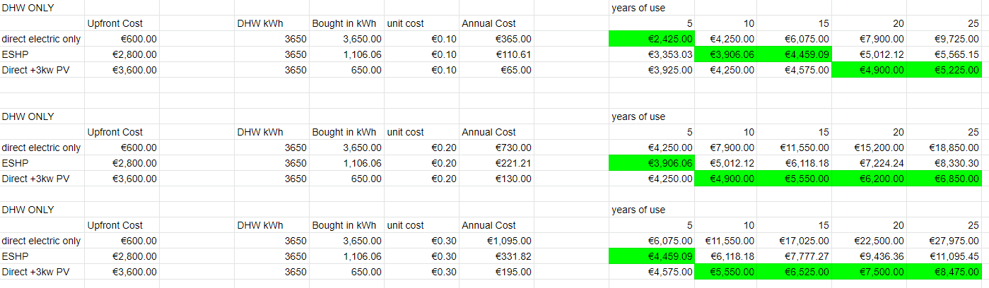

Quick googling shows a Dimplex Edel 270l for £2752 + ducting and a Telford 300l UVC for £599 and 3kW of Solar PV for about €3000. Assuming self install as in this case.
I made a brief table for 3 electricity prices and 3 scenarios. UVC only, ESHP, UVC+3kW PV ( all self used on DHW)
The numbers tell the story. Obviously it really depends on your DHW usage and electricity price.

Posted
And the share of bought in vs generated electricity.
I think you're generous with PV on two counts
- Probably generates less than 1000 kWh per kW(p) per year
- Seasonality is all wrong so you'll waste loads in summer and not have enough in winter (when the water also needs more heating - try 5-20C variation)
Try a seasonal calc using pvgis and variable temperature and I think you'll conclude that you need a lot more than 3kW(p) to supply that kind of demand.
Posted
I've re done my table with a 4.6kWh system (real prices from easyPV) and upped the amount of bought in electricity.  PVGIS shows 4141kWh of production. With a large DHW tank it should be possible to use 3/4 of that I reckon. (Does anyone actually have any experience?)
The ESHP wins out here although it's close. However, I'm unconvinced it will last as long as the PV which guarantees the panels to 25 years. If you had to replace the ESHP at any stage it'd be more expensive. Also the PV can be used to displace lots of peak electricity elsewhere in the house too which isn't in the above calcs.
The simplicity of it and the lack of any moving parts get my juices going too!!!
