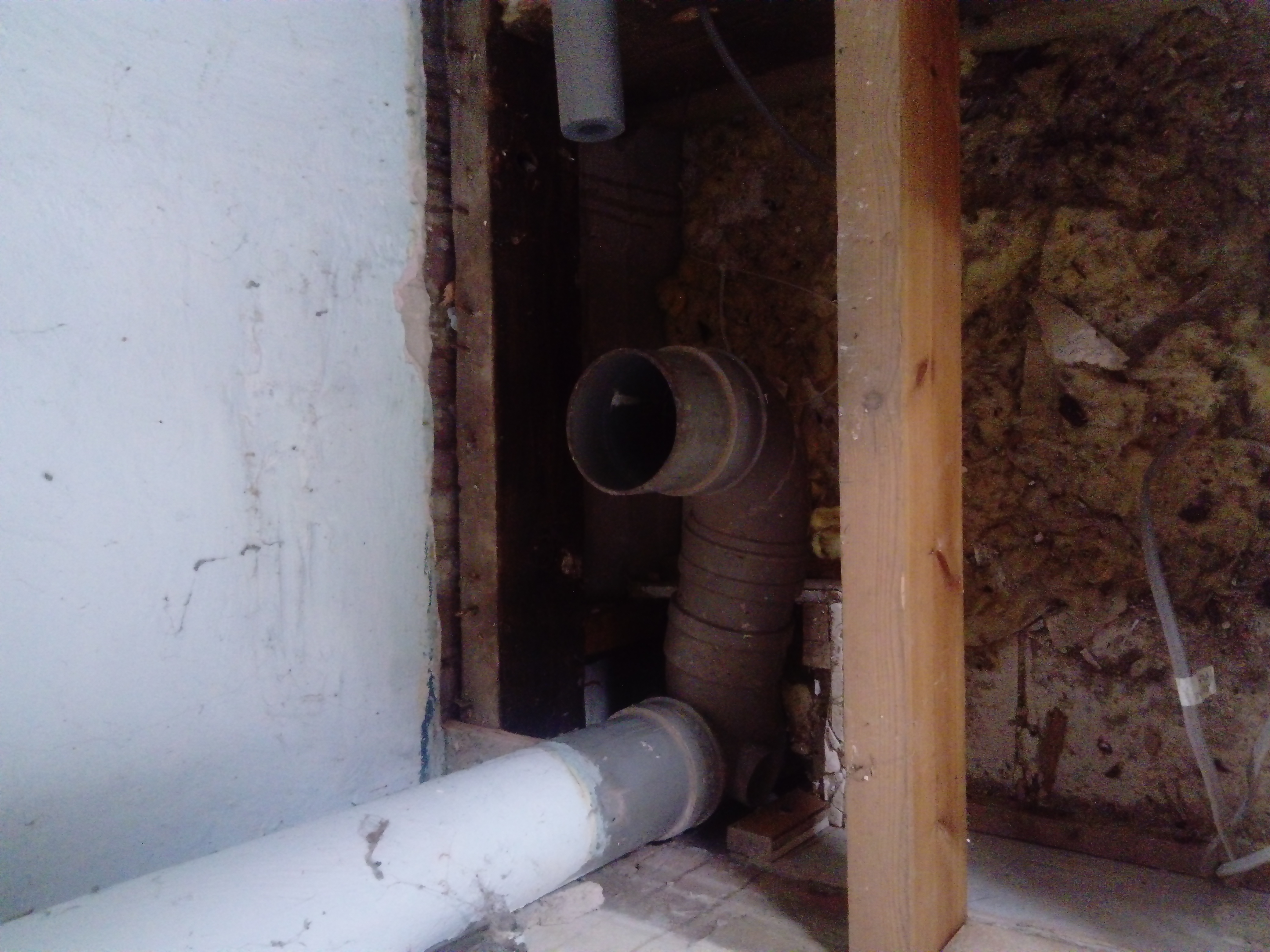

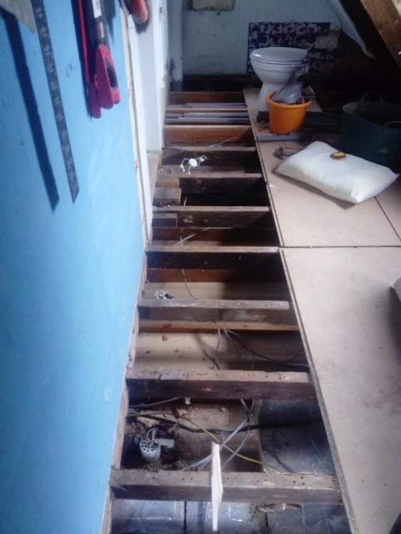

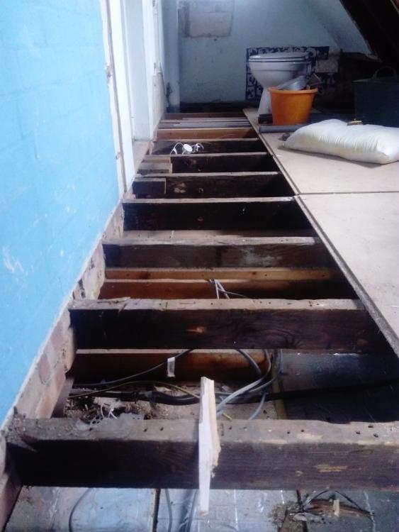

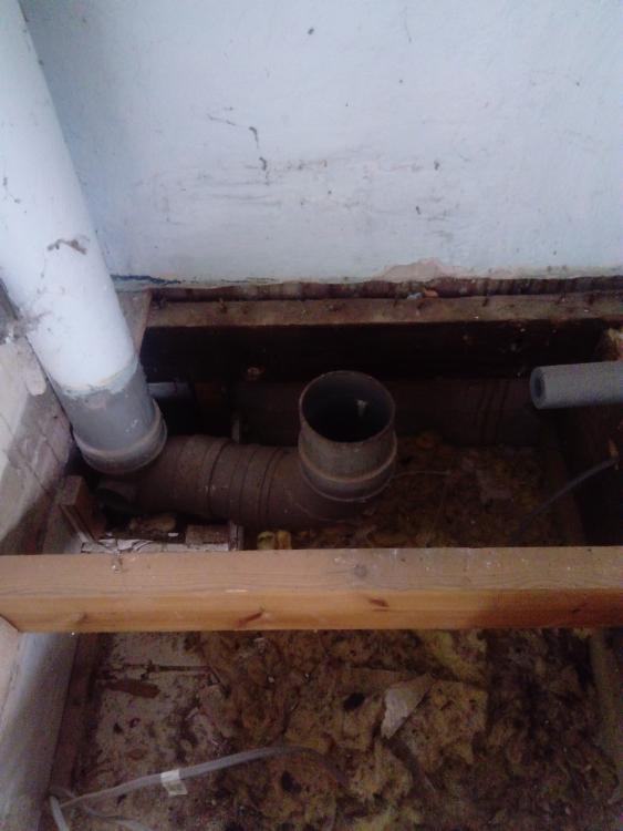

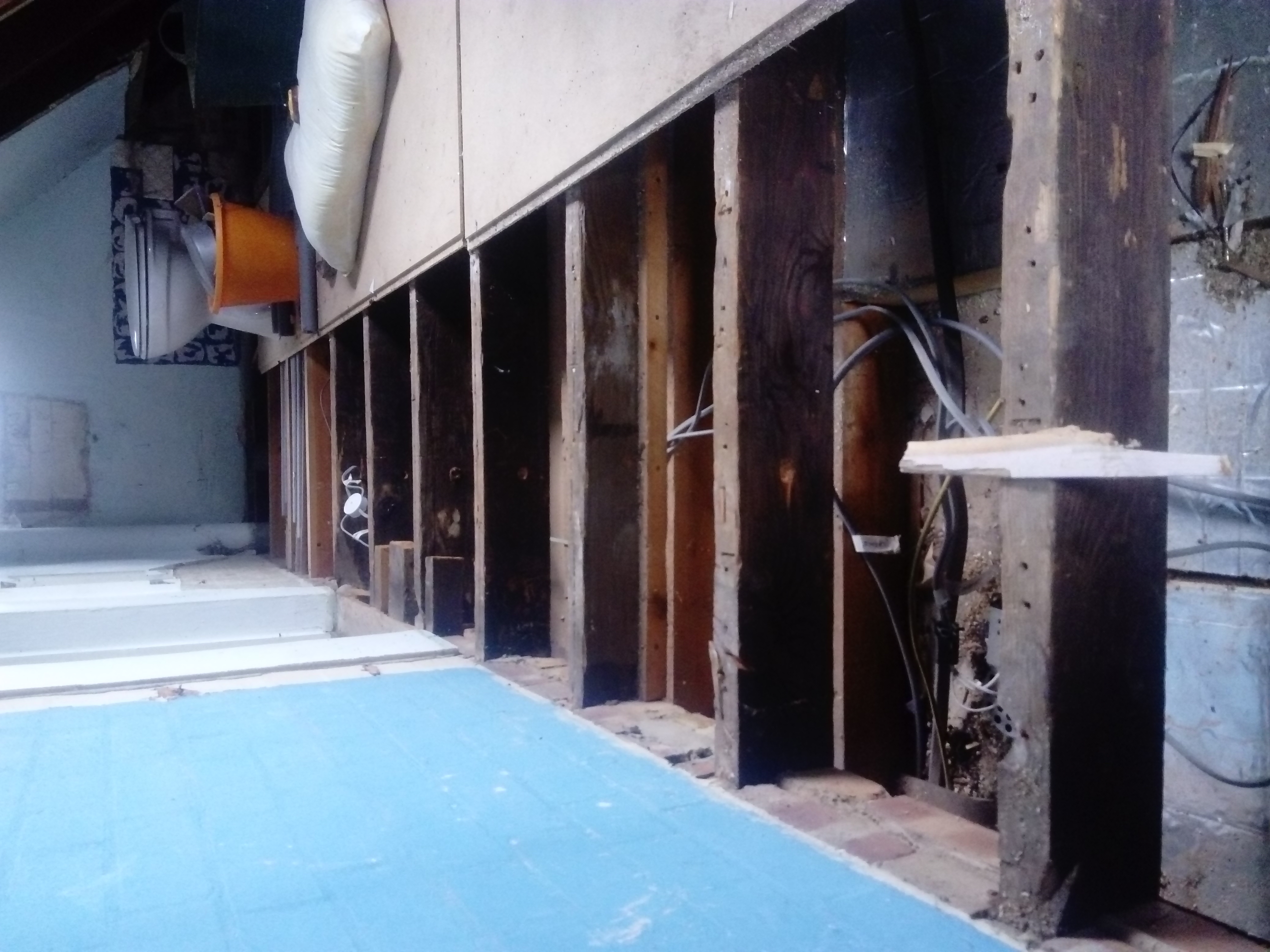

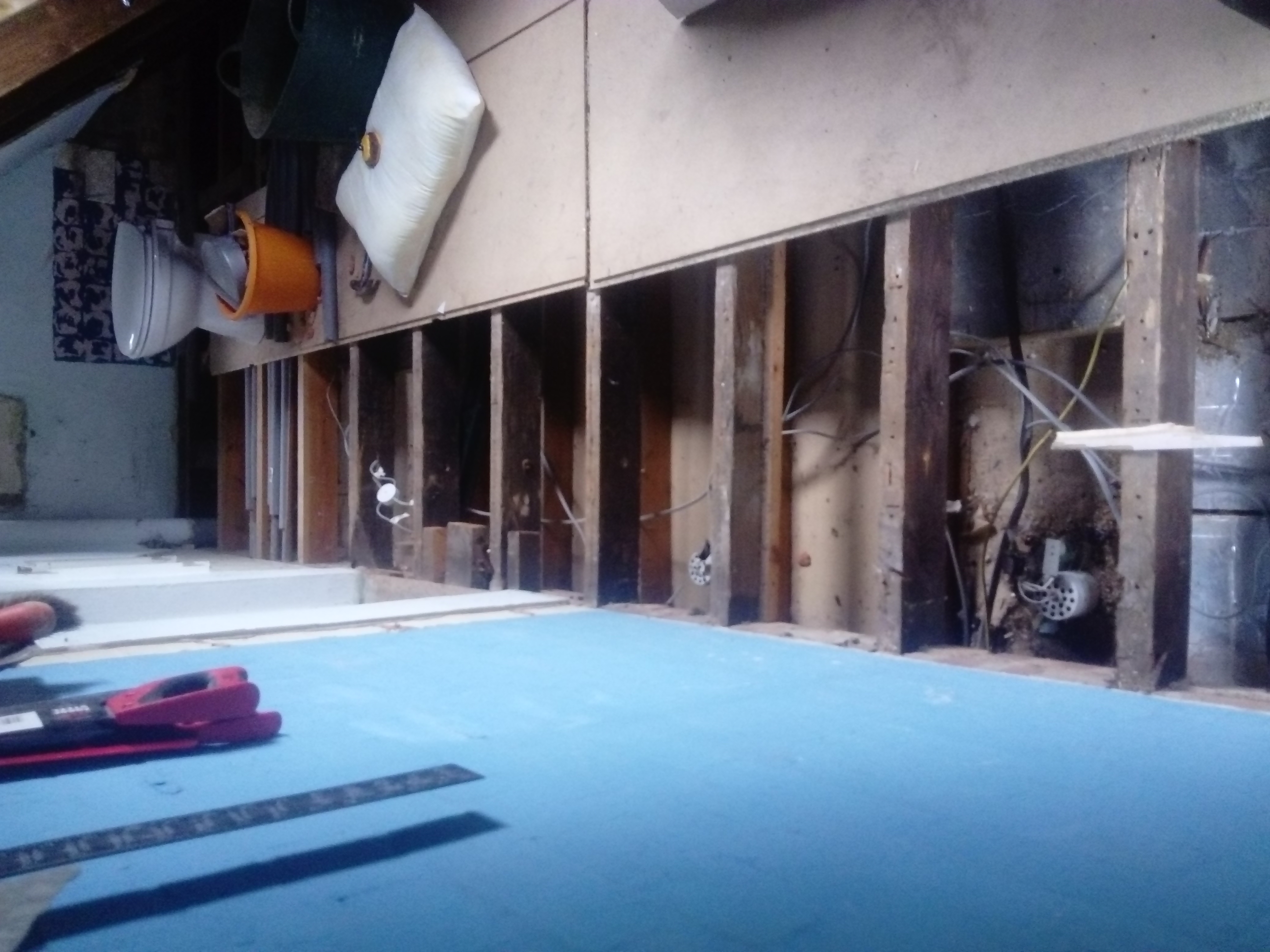

Dee Posted June 13, 2017 Author Share Posted June 13, 2017 (edited) Makes total sense.... Now my current problem is the poo pipe.... I will be fitting two loos. One will replace an old loo so the stack and bendy pipe is already there, a new loo will sit 4m away and directly in front of the old one. To get any fall I need to notch out 5 joists. 1. How much must I notch out to get the fall? 2 where do I notch, to one side or the other of the existing poo pipe? Or directly in line. The first image is where the old loo will be replaced, the second and third is taken from the position of the second new loo and the run the pipe will take. (piece of wood balanced on joist is where the stud wall will be) I can't visualise how the new pipe will connect to the old pipe (first picture) Confused..... And all this happening while husband is cycling in Italy!!! Grrrr Edited June 13, 2017 by Dee Link to comment Share on other sites More sharing options...
PeterW Posted June 13, 2017 Share Posted June 13, 2017 Why can't you go below the joists ..? You will struggle to notch the tops. 1 Link to comment Share on other sites More sharing options...
Dee Posted June 13, 2017 Author Share Posted June 13, 2017 (edited) I am @PeterW ....but the gap is only 100mm and the pipe is 130mm. There is a void btewen the 2 sets of joists Edited June 13, 2017 by Dee Link to comment Share on other sites More sharing options...
PeterW Posted June 13, 2017 Share Posted June 13, 2017 Pipe should be 110mm..?? Looks much deeper or is that an illusion ..? 1 Link to comment Share on other sites More sharing options...
Nickfromwales Posted June 13, 2017 Share Posted June 13, 2017 Don't notch the underside of the upper joist, notch the top of the lower one. 130mm ? What are you measuring . ? 1 Link to comment Share on other sites More sharing options...
Dee Posted June 14, 2017 Author Share Posted June 14, 2017 11 hours ago, PeterW said: Pipe should be 110mm..?? Looks much deeper or is that an illusion ..? It is 110 but it has a collar moulded to one end with a rubber seal inside.... Hence 130mm Link to comment Share on other sites More sharing options...
Dee Posted June 14, 2017 Author Share Posted June 14, 2017 This is what I'm using... The collar end is 130mm moulded onto 110mm pipe. They are 1.2m lengths.. Due to very restricted access I know to notch out the top of the lower joist but where along the joist do I notch? Close to the wall, center, right? I can't visualise how it will connect into the soil stack (next to the window in the image) will it connect to the stack or into the old 90 degree (first image)? I don't want to waste my time notching in one position only to have my plumber tell me it needed to be to the left or right.... See my dilemma Link to comment Share on other sites More sharing options...
