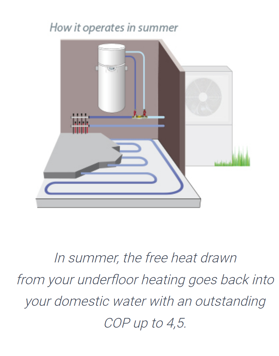

markocosic Posted July 22, 2022 Share Posted July 22, 2022 https://www.tesy.co.uk/heat-pump https://www.vaillant.co.uk/for-installers/products/arostor-domestic-hot-water-heat-pump-58880.html Or perhaps more relevant to houses with a wet heating system: https://www.auer.fr/en/products/heat-pump-water-heaters/edel-water-heat-pump-water-heater/ They need to be PV divertable though so that either the compressor only runs when there's ~300W+ available or it is inverter driven and can run when there's very little excess available etc. One for @Radian next week perhaps! 😉 Link to comment Share on other sites More sharing options...
Radian Posted July 22, 2022 Share Posted July 22, 2022 2 hours ago, markocosic said: Or perhaps more relevant to houses with a wet heating system: https://www.auer.fr/en/products/heat-pump-water-heaters/edel-water-heat-pump-water-heater/ They need to be PV divertable though so that either the compressor only runs when there's ~300W+ available or it is inverter driven and can run when there's very little excess available etc. One for @Radian next week perhaps! 😉 This caught my eye: And cools the floor as well. Hmmm... 1 Link to comment Share on other sites More sharing options...

joth Posted July 22, 2022 Share Posted July 22, 2022 2 hours ago, markocosic said: It's french but not a daft solution Needs some integrating to the main UFH controls to ensure the primary circuit continues to circulate via the UFH loop even when there's no call for cooling or heating on the ASHP. But... Yeah it does make sense Link to comment Share on other sites More sharing options...
JohnMo Posted July 23, 2022 Author Share Posted July 23, 2022 Think it makes good sense in the summer when it's hot, as you can use to cool the slab. But at almost any other time, you are taking heat out of the floor provided by another source, i.e. a boiler, heat pump, even solar gain etc. So if you take a kW away out of the UFH return flow you need to add kW at the other end to keep things in balance. So would it be more cost effective just heat DHW from the normal source of heat. Link to comment Share on other sites More sharing options...

Radian Posted July 23, 2022 Share Posted July 23, 2022 52 minutes ago, JohnMo said: Think it makes good sense in the summer when it's hot, as you can use to cool the slab. But at almost any other time, you are taking heat out of the floor provided by another source, i.e. a boiler, heat pump, even solar gain etc. For anyone like me with a UFH loop in a garden room, outside the heating season, the floor may be a significant thermal resource. The sunlight that falls directly on the floor is re-radiated and trapped by the low-E glazing so becomes one of the most significant contributions to the room's air temperature. In turn, reducing the floor temperature would reduce this re-radiation so reducing the source of the unwanted air temperature rise. The fact that this would also be sourcing the DHW, potentially through solar PV is a win-win. Link to comment Share on other sites More sharing options...
