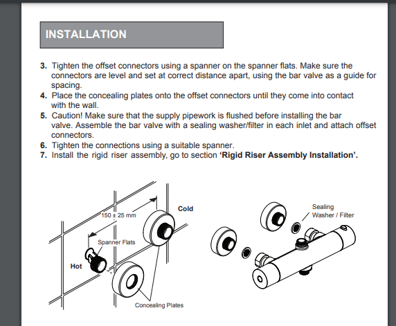

The shower has a safety feature that one has to click a button on the tap/handle to let the water get hot. At the moment, I can only get scolding hot water whatever I do.  I wonder whether the safety feature is preventing it working OK in reverse flow?
In any case, the instructions have a diagram showing the hot water pipe on the left.  https://s1.thcdn.com/design-assets/product-pdf/bathstore/en_GB/12915461/1646341213114-20007015000.pdf

If the hot and cold are reversed the cartridge that is meant to regulate the temperature actually makes things worse... If the flow is a bit too hot, instead of reducing hot and increasing the cold it does the reverse, it increases the hot making it even hotter. In no time at all it's at maximum hot.
Thanks everyone for your comments.
It really is a case of our plumber not applying reasonable care and skill.  Not only did he connect the pipes the wrong way around, he never tested the shower to make sure it was working OK.   Not too surprised.
