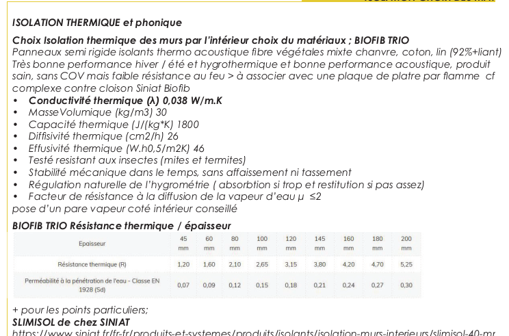

Garald Posted July 13, 2022 Author Share Posted July 13, 2022 Incidentally, do we know enough about the long term effects of phenolic mousse to use it to insulate bedroom walls? If not, a solution may be simply to use a thinner (10cm, say, meaning R=2.65; it would be about 12cm or 13cm once everything is considered) layer of BioFib Trio in the bedroom; a bedroom simply doesn't need to be as warm as other rooms on winter nights, and, since this bedroom faces NWN, it probably won't get all that hot in summer either. (Of course I'd need to see whether having one room with walls at R=2.65 would wreck the energy rating.) Link to comment Share on other sites More sharing options...

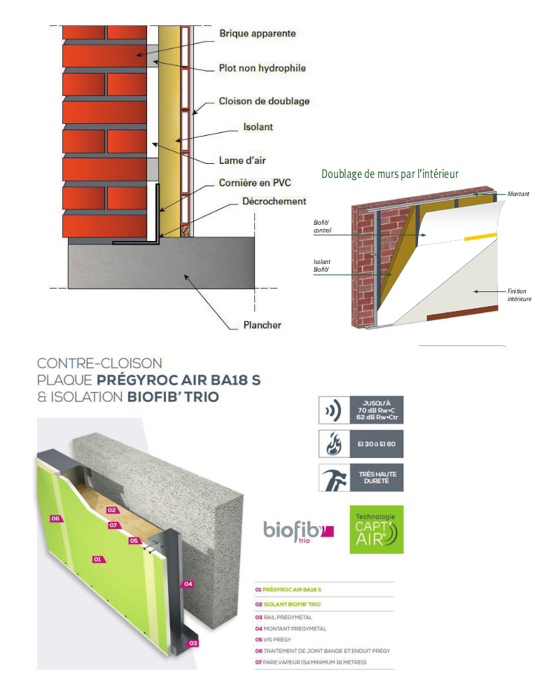

Garald Posted July 15, 2022 Author Share Posted July 15, 2022 While we are at it: I suppose the Biofib technical specifications in https://www.biofib.com/biofib-trio/ are really about what the Actis brochure (see website above) calls "R intrinsèque"? If that is the case, and performance increases as for Hybris when one adds air on both sides (as we plan to, in part for soundproofing) then 120mm of Biofib -> intrinsic R = 3.15 -> (R taking air into account)=3.8 or thereabouts. Then 120mm of Biofib (+ air on both sides) should be enough (that's what my architect seemed to prefer the next to last time we talked). Link to comment Share on other sites More sharing options...
SteamyTea Posted July 15, 2022 Share Posted July 15, 2022 (edited) 29 minutes ago, Garald said: R intrinsèque An important point. It does not matter how brilliant the insulation properties are on paper, or of paper, if it is fitted badly, incorrectly, or is just unsuitable (water absorbing), then it will not perform as well as expected. Edited July 15, 2022 by SteamyTea Link to comment Share on other sites More sharing options...
