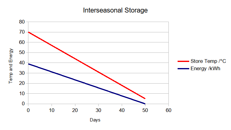

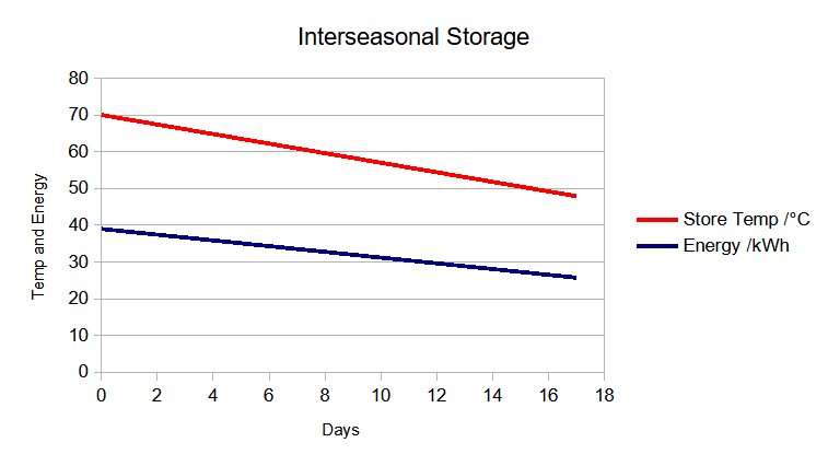

SteamyTea Posted November 10, 2023 Posted November 10, 2023 (edited) A bit of arithmetic can help here. Let us start with a box, 1 m on each side. So 1 m3, that will hold around 2,700 kg of sand, which has a specific heat capacity of around 0.8 kJ/kg.K, so 2,160 kJ/K or, 0.6 kWh/K If we add 0.5 m of insulation around it, we then have a cube that is 2 m on each side, and a volume of 8 m3. so a volumetric capacity (AKA Heat Capacity) of 0.075 kWh/m2.K. Why so much insulation you may well ask. Well the sand will have to be kept at a high temperature, so the thermal losses will be quite high without it. If we choose a phenolic insulation with a thermal conductivity of 0.02 W/m.K we can work out the losses. The total surface area will be 12 m2, and let us say that the ground is, during winter, at 1 m depth 5°C and we store the sand at 70°C, a temperature delta of 65 K and an initial energy storage of 39 kWh. Converting the thermal conductivity to a U-Value give us 0.042 W/m2.K (about half what a Passivhaus uses). 0.042 [W/m2.K] x 12 [m2] x 65 [ΔT] = 33 W [2 significant figures). After a day, 0.8 kWh will have leaked out, leaving 38.2 kWh, the temperature will have dropped by 1.3K, to 68.7°C, day two, there will be 37.4 kWh of storage and the temperature will be 67.4°C. After 15 days of losses, the energy stored will be 27.3 kWh and the temperature will be at 50.5°C, about as low as to be useful. Now you can top up to counteract the losses with relatively small amounts of energy, 0.8 kWh/day, but that just covers the losses, not usage. If you run the heat store down to 50.5°C every day, then you need to replenish it with 11.7 kWh for usage, plus the 0.8 kWh for losses, 12.5 kWh/day. Now I have a small storage heater in my kitchen, a 10.5 kWh model. It is 0.56 m wide, 0.18 m deep from the wall and sits 0.71 m high from the floor. That gives a volume of 0.072 m3. A volumetric capacity of 146 kWh/m3. Compare that to the sand storage of 4.9 kWh/m2. Now my storage heater does not have anything like the insulation levels of an intersessional storage system, but then it does not need to, as all the thermal losses end up heating the room, which is what heaters are meant to do. So for less space, less price and thermal losses where they are wanted, my storage heater is better, by a factor of 30. If intersessional storage was so brilliant, all our houses would be built on them. (as usual, quickly calculation things can introduce errors, so I may have made one that could turn the whole thing on its head) Just had a thought, GSHP would be easier and cheaper, it effectively works the same. Done a chart. After 50 days, the losses have depleted the store. It is 45 days till Christmas day. Edited November 10, 2023 by SteamyTea

Adsibob Posted November 11, 2023 Author Posted November 11, 2023 On 10/11/2023 at 08:34, SteamyTea said: After a day, 0.8 kWh will have leaked out, leaving 38.2 kWh, the temperature will have dropped by 1.3K, to 68.7°C, day two, there will be 37.4 kWh of storage and the temperature will be 67.4°C. After 15 days of losses, the energy stored will be 27.3 kWh and the temperature will be at 50.5°C, about as low as to be useful. Don’t you need to do some differential equation to model the fact that the heat leaks out continuously not incrementally.

SteamyTea Posted November 11, 2023 Posted November 11, 2023 2 hours ago, Adsibob said: Don’t you need to do some differential equation to model the fact that the heat leaks out continuously not incrementally Ideally yes. But as it is not a practical idea, rather a moot point See what @Marvin said. GSHPs are taking advantage of stored energy. As are ASHP and WSHP.
