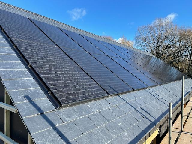

Gus Potter Posted June 28, 2022 Posted June 28, 2022 On 28/06/2022 at 21:06, low_and_there said: and weight considerations we ought to plan for? Expand Good point. Often if converting an attic you run into head room problems and you want to try an avoid having to strengthen / deepen rafters if you can. PV panels have become much lighter as time has passed. SE wise you check the roof for the following: 1/ The self weight of the tiles / rafters and so on plus an access load of about 60kg per square metre. 2/ If a low pitched roof.. access plus wind loading.. sometimes critical if a big flat roof 3/ Snow loading plus roof self weight. Now in many parts of the UK the snow loading is much smaller than the access load. And under normal conditions you would not expect folk to be standing/ placing scaffolding etc on your panels (this would be what we call an accidental loading case). Thus you can primarily design for the self weight of the roof plus the panel weight plus snow which could be less than self weight plus access and you may find that works to give you head room inside if you get stuck. You could go further and go for an in system (if you can detail the ventilation ok) where you just have lightweight trays. Load is reduced further (no tile weight etc) and you save a bit on the tiling which offsets the cost of the trays. The difference is small but if you are struggling for head room have a chat with your design team. 1

JohnMo Posted June 29, 2022 Posted June 29, 2022 The issue with ventilation is, to get full output you need some airflow at the rear for cooling. GSE trays do include ventilation. Even without cooling it is at max output when you may loose a few percent in performance, so 20 or 30 days a year, for a couple of hours a day if facing south. Not something to worry about. 1

low_and_there Posted June 29, 2022 Author Posted June 29, 2022 On 28/06/2022 at 22:27, Gus Potter said: You could go further and go for an in system (if you can detail the ventilation ok) where you just have lightweight trays. Load is reduced further (no tile weight etc) and you save a bit on the tiling which offsets the cost of the trays. Expand Thanks for your notes @Gus Potter, appreciate the breakdown of things to think about in terms of weight. In terms of the lightweight trays you refer to, are these something like the "GSE" trays that @JohnMo mentions? Are there any such items for flat roofs you could point me in the direction of?
Gus Potter Posted June 30, 2022 Posted June 30, 2022 On 29/06/2022 at 21:09, low_and_there said: Are there any such items for flat roofs you could point me in the direction of? Expand Not really but others may know more. The thing is that that any advantage gained by way of load reduction when retrofitting PV would be offset by the cost of trying to make a flat roof water tight if the carrier system for the PV needs fixed down to the underlying structure. Any leaks could mean the panels need to be lifted and that could be the start of a nightmare. On a flat roof if the PV panels are to be pitched then the carrier system has some self weight.. which again reduces any benefit of the proposal I make above in terms of justifyable load reduction.
low_and_there Posted July 1, 2022 Author Posted July 1, 2022 On 30/06/2022 at 19:48, Gus Potter said: Not really but others may know more. The thing is that that any advantage gained by way of load reduction when retrofitting PV would be offset by the cost of trying to make a flat roof water tight if the carrier system for the PV needs fixed down to the underlying structure. Any leaks could mean the panels need to be lifted and that could be the start of a nightmare. On a flat roof if the PV panels are to be pitched then the carrier system has some self weight.. which again reduces any benefit of the proposal I make above in terms of justifyable load reduction. Expand Thanks again for the explanations @Gus Potter, super helpful! Based on this thread, I'm now thinking: 1) For the existing roof where we're (hopefully) not re-tiling, we'll go over the existing tiles - if we have to re-tile the roof then the in-roof trays are an option. 2) For the two new flat roofs we're creating, we need to factor in the additional weight considerations of the trays, ballasts and panels, along with the various loading scenarios that you outlined in your earlier post - that is the simplest and safest way rather than building in any frames or any screwing into the roof that could compromise weather tightness. 3) For the new pitched roof we're creating, we could go for in-roof trays so long as we ensure decent ventilation behind them.
