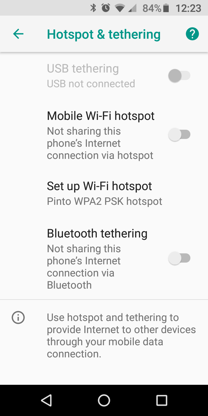

pstunt Posted June 27, 2022 Author Share Posted June 27, 2022 Just now, JohnMo said: Use your phone, instead of a router, or sit the the 4G router in you car, powered from your car. Thanks, that's what I have been doing up until now but I want the wifi router to carry out two main functions. The first to allow me to carry out my day job when I am on site. Using a hotpsot of a phone is not as convenient as an always available wifi connection. For sure, the car solution would work but the other reason for the router is for a security camera which is connected to the internet. I have a spare Ring camera which is currently hooked up on site and works fine. Link to comment Share on other sites More sharing options...
SteamyTea Posted June 27, 2022 Share Posted June 27, 2022 As @JohnMo says. Phone if you want to run it permanently on site (my old Motorola E will last a couple if days). Can always get a solar powered battery bank. They allow a secondary power input i.e. more solar. https://www.ebay.co.uk/itm/294702432459 Link to comment Share on other sites More sharing options...
SteamyTea Posted June 27, 2022 Share Posted June 27, 2022 (edited) My phone can be USBed to my laptop, may be able to do the same to a router. Though I can't see why it is not as convenient as a proper router. I use the hotspot on Mt phone as my sole interweb connection. Top of the list Edited June 27, 2022 by SteamyTea Link to comment Share on other sites More sharing options...
pstunt Posted June 27, 2022 Author Share Posted June 27, 2022 11 minutes ago, SteamyTea said: As @JohnMo says. Phone if you want to run it permanently on site (my old Motorola E will last a couple if days). Can always get a solar powered battery bank. They allow a secondary power input i.e. more solar. https://www.ebay.co.uk/itm/294702432459 Thanks, I do have an old phone I can try but I am doubting the hotspot signal will be strong enough or reliable but I am charging the phone now and will give it a go. My experience on my phone with hotspots is that they often disconnect or dont reconnect if you move away and then come back, which is something I do all the time. Link to comment Share on other sites More sharing options...
