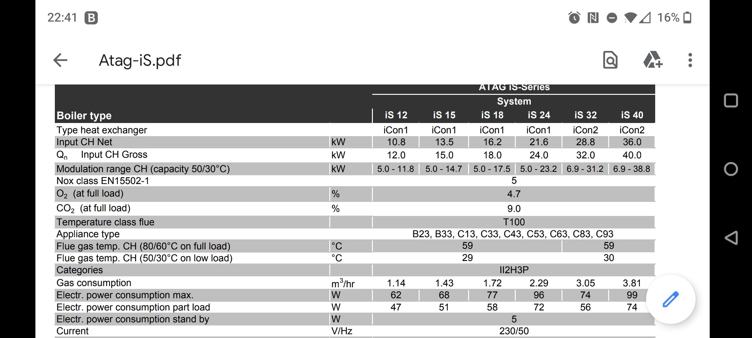

JohnMo Posted June 13, 2022 Posted June 13, 2022 First reason for a cylinder was to enable PV diverter and offset DHW and possibly heating/ adding to CH. Future plan is to also add solar thermal. Thermal panel currently sat in garage waiting to be installed. The buffer when in CH mode only gets heated to about 30 to 35, so heat loss is negligible, but it hot enough to pre heat water going to combi for DHW. Reason for combi was hot water on demand, without having to store hot water and the associated heat loss. To get everything to work sounds easy, but has taken a couple of revisions to get to it function efficiently.
ruggers Posted June 13, 2022 Author Posted June 13, 2022 Thanks. Were you not tempted by an ASHP? It seems that everyone using the Viessmann products opt for no zones or stats which I need to look into further, I'm not really understanding how that works, I know it's new tech with Weather comp, but 1 thermostat for a whole house without WC just sounds like how it was done 30 years ago. Are people also doing this in their houses with other brands of boilers? The plus side to having a tank would mean that the house should be set up to swap from gas to something else in the future like ASHP without pulling ceiling in to alter pipes. I do like the sound of the storage combi for the reasons you mention being continuous DHW and the heat loss from cylinder. Although MVHR should recover some from that room. I had a look at an ATAG system boiler but they don't mention any modulation or figures.
JohnMo Posted June 13, 2022 Posted June 13, 2022 Atag manual has all the numbers, snapshot attached 1
