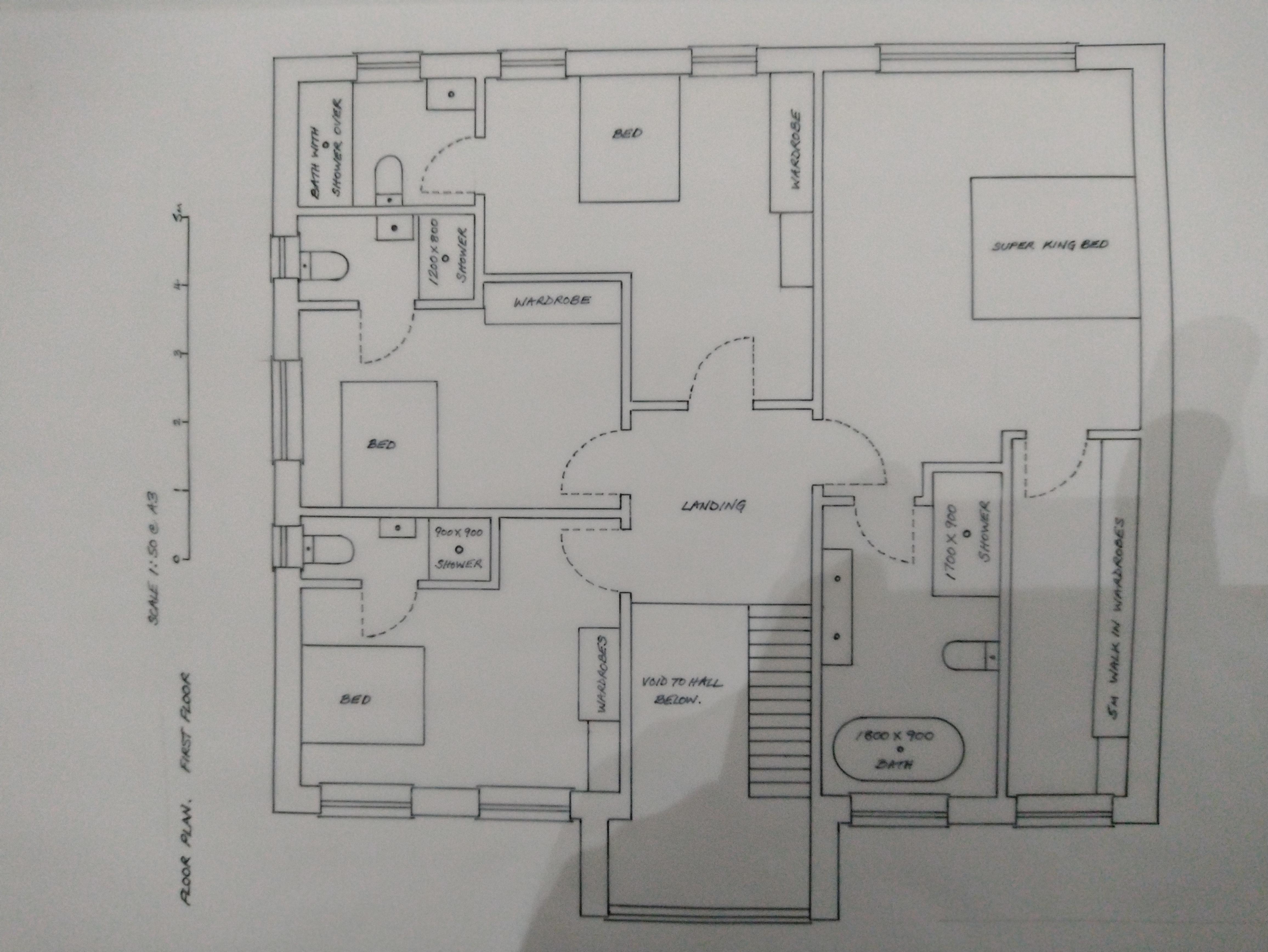

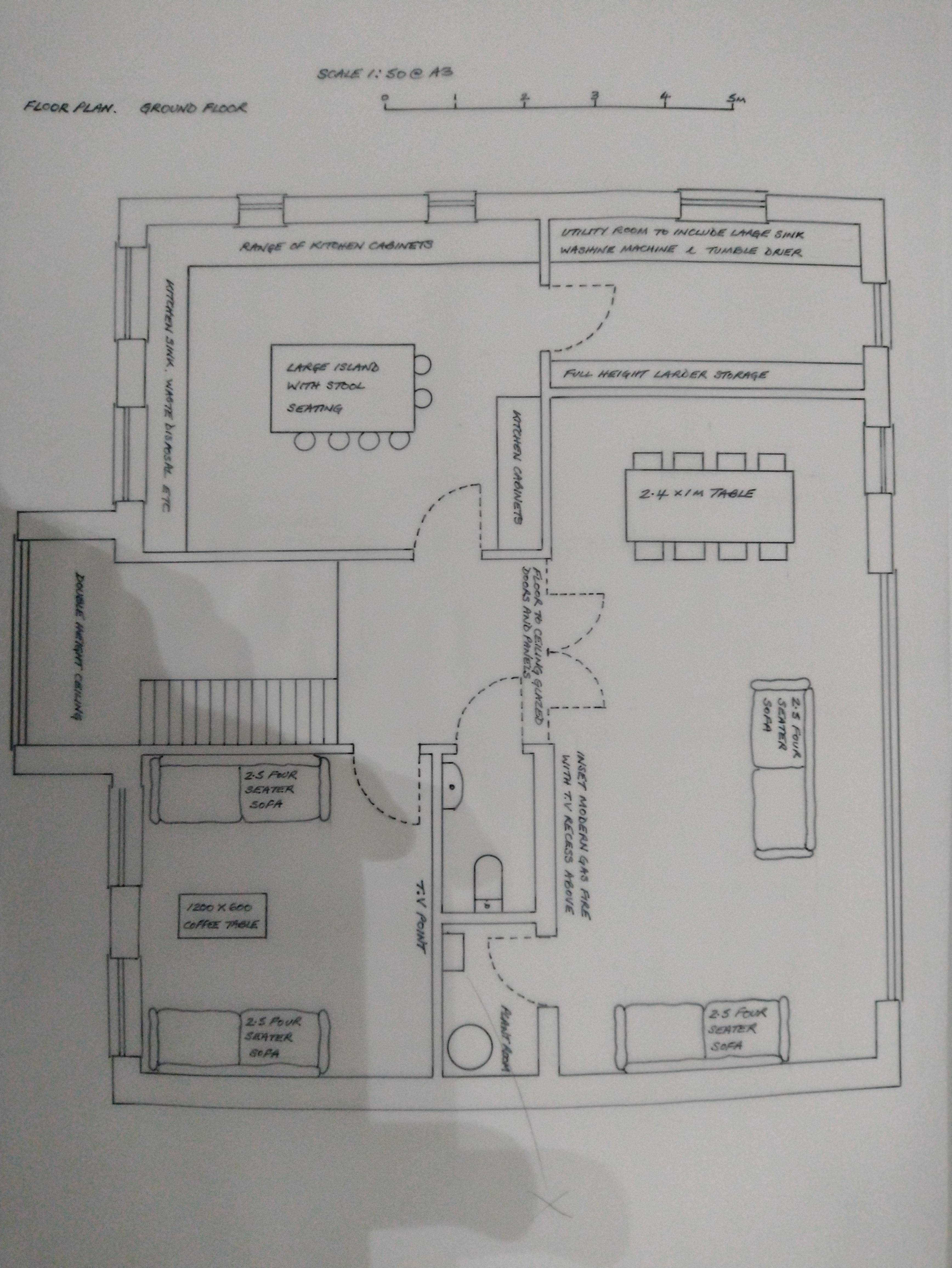

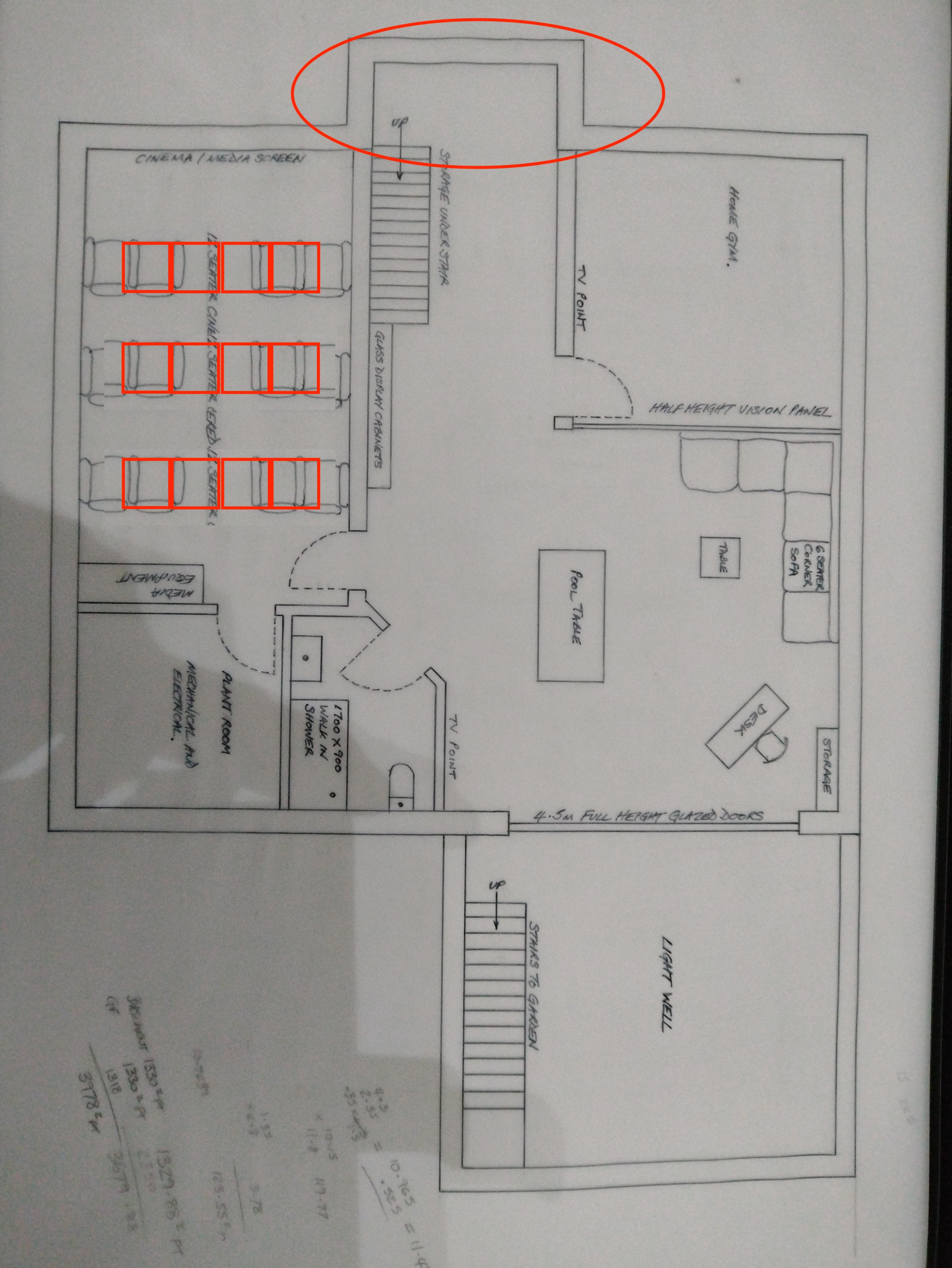

Big Jimbo Posted June 13, 2022 Author Share Posted June 13, 2022 Yes i went in for planning permission for a basement that was the full size of the house above. with a decent sized lightwell to the rear. The reason for the basement was because i'm in Greenbelt and i knew that there was no way to go bigger on the house. Just got it through. I'll do some reading re the above advice. Thanks folks. I am pleased that i have managed to go from about 650 square ft to 3881 square ft + a double garage, and my posh shed. So about 4450 square ft in total. Ive had A and E permitted development rights removed. A i can understand but E is a right cheek. I will try and post up my floorplans, so you can all pull them apart. 2 Link to comment Share on other sites More sharing options...

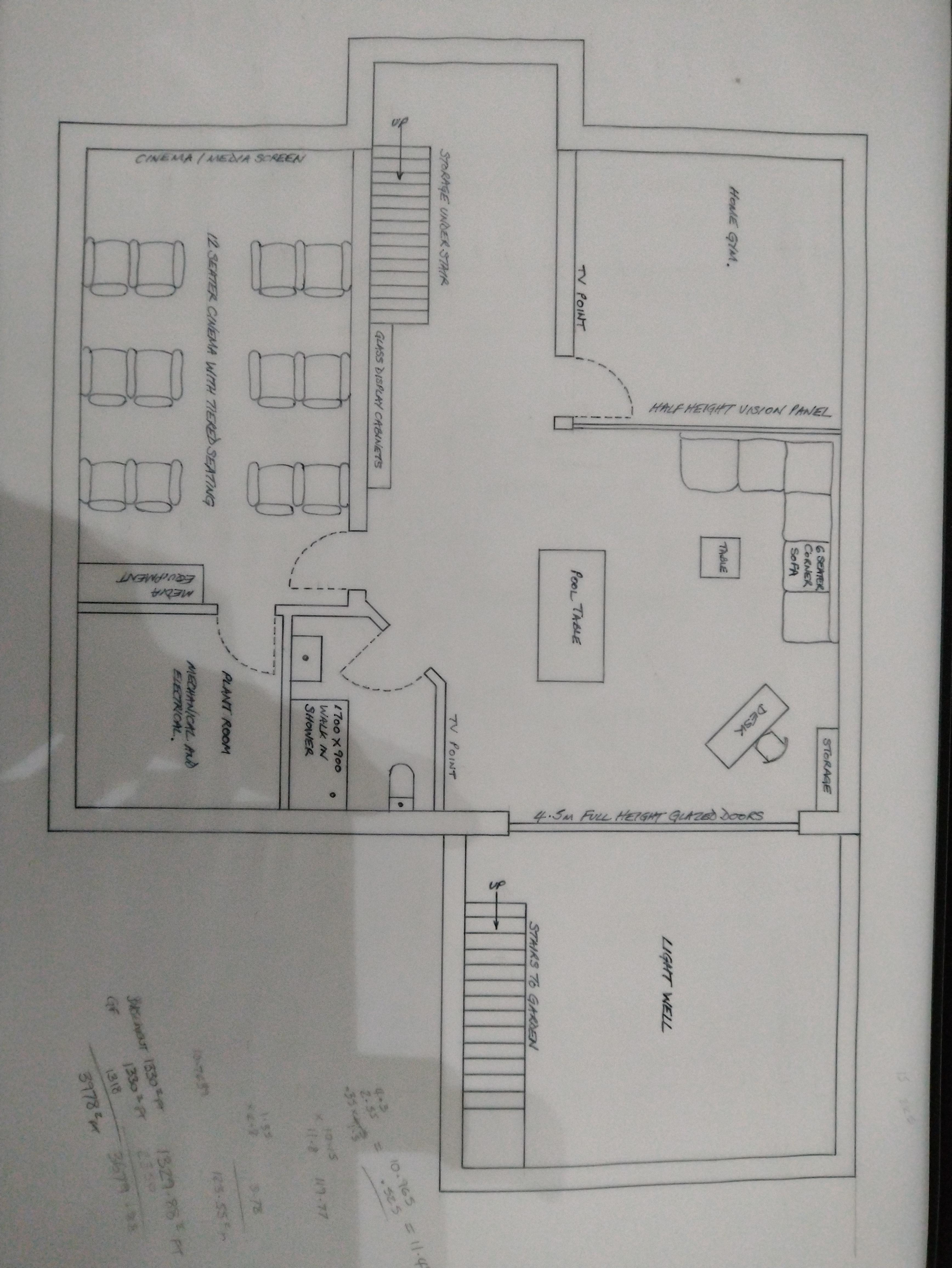

Big Jimbo Posted June 13, 2022 Author Share Posted June 13, 2022 Big apols for being so tecno rubbish, hence the 3 posts. Thanks again for all the replies gang. 1 Link to comment Share on other sites More sharing options...
Pocster Posted June 13, 2022 Share Posted June 13, 2022 7 minutes ago, Big Jimbo said: I think one says ‘gym ‘ - it’s too small mate ! Make the gym bigger ! Also where does the arcade cabinet go ? , hot tub ? , sauna ? and games room ? Link to comment Share on other sites More sharing options...
Big Jimbo Posted June 13, 2022 Author Share Posted June 13, 2022 10 minutes ago, pocster said: I think one says ‘gym ‘ - it’s too small mate ! Make the gym bigger ! Also where does the arcade cabinet go ? , hot tub ? , sauna ? and games room ? You could always use the posh shed as a Gym. I might apply to get my Part E back. (There is no way it passed the six tests) just so i can build a pole dancing posh shed down the bottom of the garden. Obviously it would include a hot tub, sauna. arcade games etc (+ dancing girls) I would obviously invite the buildhub gang. 1 Link to comment Share on other sites More sharing options...
Thorfun Posted June 13, 2022 Share Posted June 13, 2022 love it! and can't wait to see the progress once you get started. a few comments... 1. what is the area circled in red for? it's much more cost effective to build the square basement. adding that kink will add extra cost and I can't see a reason for it. 2. I would put the cinema seating in the middle and have the walkways at the sides. otherwise no one has the prime position of being central to the screen! Also, tiered seating would be amazing so consider your ceiling height when digging/building the basement and ensure you have room to allow it. it's exactly what I'm planning with our basement cinema if/when I ever get around to fitting it out. we have 3m high ceilings in the basement so plenty of room to allow tiered seating. now I've seen the plans, another few things to consider for your plant room. If you're having MVHR (and I presume you are) and it's going in the plant room then you'll need a condensate drain unless you're having an enthalpy exchanger. our RWH has a 'brain' to it that flushes out the header tank if no use is detected, i.e. holiday mode, so that rainwater isn't sat in it for a prolonged period. As such I need to 'drain' from the controller which will be in the basement but as it's drained by gravity the controller needs to be above the RWH tank or drains! this is a problem for me and if I knew then what I know now I would've run a drain from the plant room to the sump in our sunken courtyard (same as your light well) so that any water that needed draining from the plant room could easily use gravity out to the sump. maybe you won't need it but thought I'd mention it now so you can consider it if you might need it. what's more frustrating is I did put ducting under the slab for electric cables from the plant room to the courtyard for powering the pump and lights, just never thought I'd need to drain anything....how wrong I was. how big is your plant room and have you planned everything out? I thought ours was and it is just about ok but the MVHR ducting has taken up a lot more room than I anticipated. I have a separate plant room and comms/electric room to keep those items separated. I'm now a bit worried about the comms room as the Loxone cabinet for our HA system is quite big, and then when I try and fit a rack mount cabinet and the fuse box etc I think it might be a little tight. basically, don't underestimate how much room you'll need in the plant room. think that's it from me for now as dinner is nearly ready. if I think of something else I'll let you know. good luck! 🙂 1 Link to comment Share on other sites More sharing options...
