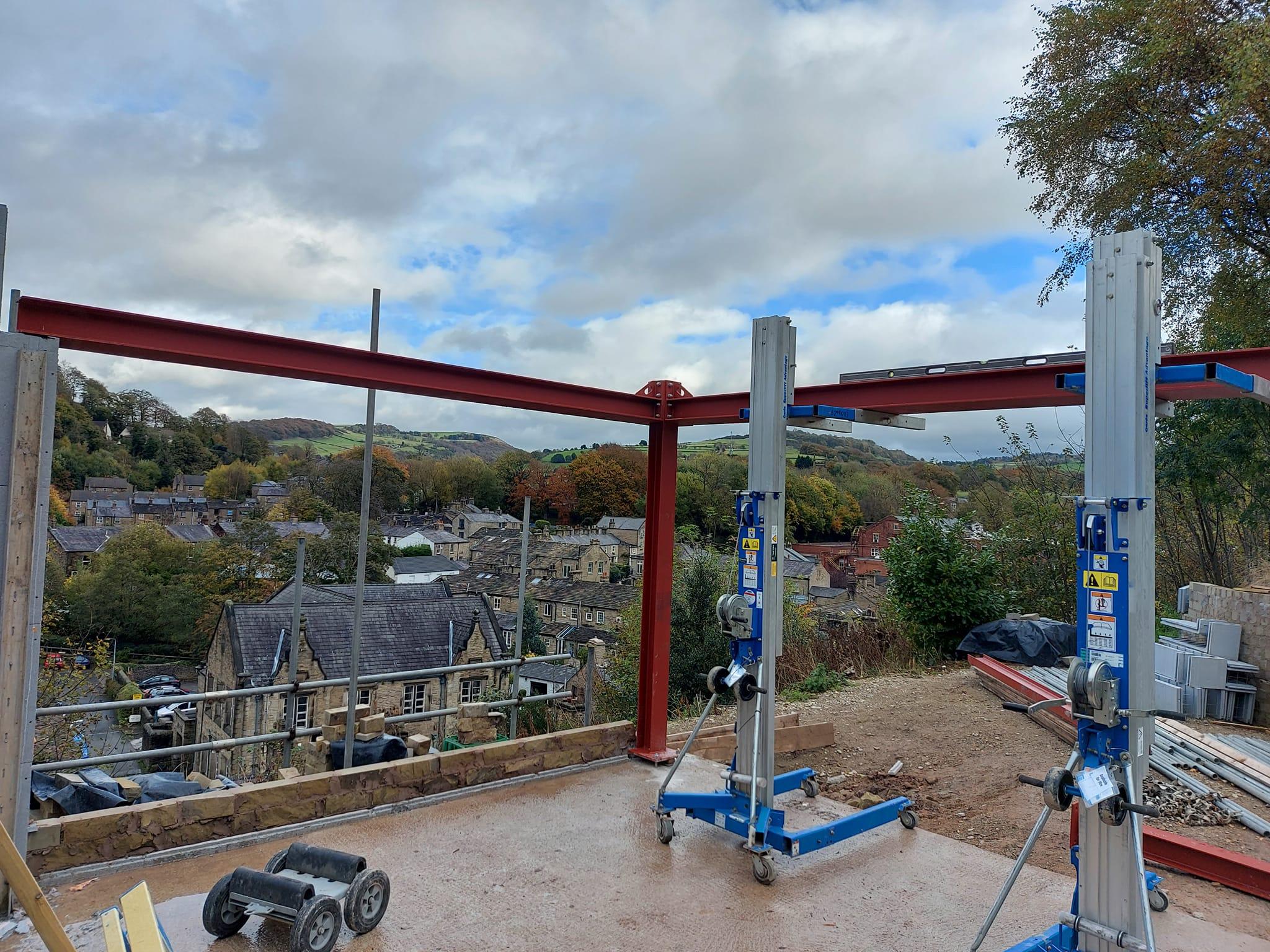

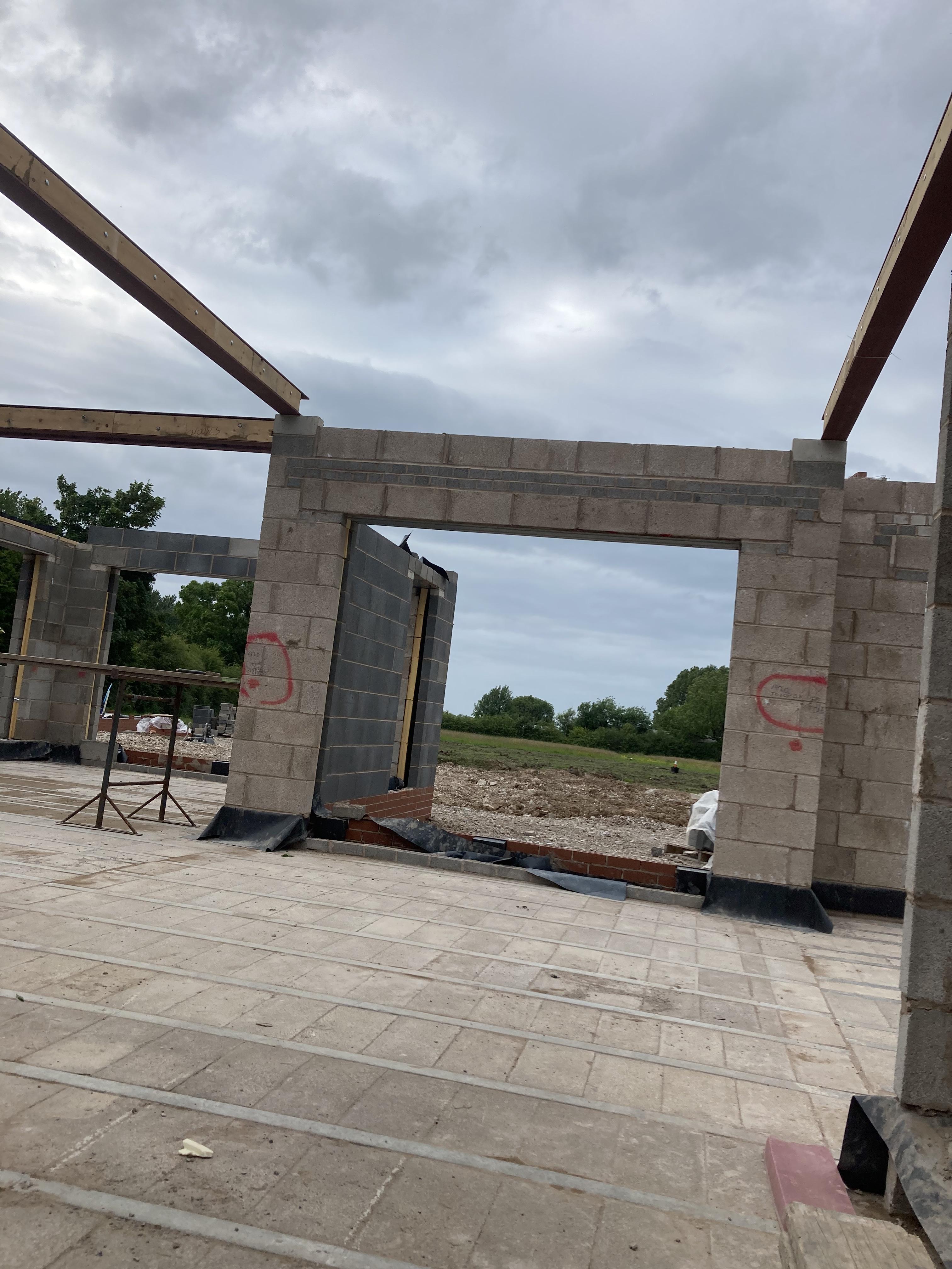

nod Posted June 11, 2022 Posted June 11, 2022 Today i had the steels delivered In the past I’ve manhandled them with a few mates This time due to the height (3000) and advancing years I hired a Genie 55 quid well spent with the help of the two steel guys we placed the steels on trestles under where they where going This allowed me to bolt them together and bolt Timbers in Unlikely previous times Once all the Timbers where bolted in It was a one man job to lift and drop them in position 4
Mr Punter Posted June 11, 2022 Posted June 11, 2022 I am certainly no expert, but if you are spanning joists between left and right steels it can sometimes be easier and just as good notch them in and rest them on the steels and noggin between. Block and beam gives a nice platform to work on with the genie. With trestles, I recently bought some galvanised ones with feet that can rotate for stacking. Pissed off with others rusting to bits and shinning me when I move them. Time will tell. Your ground floor footprint looks generous. Very nice site. What size house?
nod Posted June 11, 2022 Author Posted June 11, 2022 I agree But unfortunately we are using Posi so can’t notch
Happy Valley Posted June 12, 2022 Posted June 12, 2022 Looking good. Luckily we have a friend with a telehandler who lifted our ground floor steels into place. We hired two genie lifts for our steels at the back of the house as can't get the telehandler up due to site restrictions. Luckily we were working off a concrete raft.

Gus Potter Posted June 12, 2022 Posted June 12, 2022 12 hours ago, Happy Valley said: Looking good. Luckily we have a friend with a telehandler who lifted our ground floor steels into place. We hired two genie lifts for our steels at the back of the house as can't get the telehandler up due to site restrictions. Luckily we were working off a concrete raft. That gusset plate at the top of the column with the oval hole looks interesting. I was wondering if someone has been looking at lifting and handling hence it may be a lifting point. But putting my SE hat on the strength and stiffness of that connection has been significantly reduced to the point where I would want to revisit the calculations and explore the "design journey" that connection has gone through.
