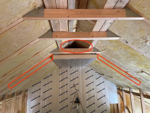

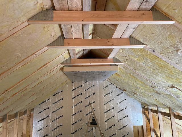

Thorfun Posted June 7, 2022 Posted June 7, 2022 hello, starting the internal PIR in our roof which has attic trusses. my plan is to simply screw the PIR to the bottom of the horizontals at the top of the attic trusses leaving a gap between the PIR and the mineral wool between the trusses. like the photo below: is that air gap going to cause an issue with my U-values? the loft space will only be used for storage so I'm not worried about the loss of head height I just think it's easier to attach to the bottom of those horizontals rather than trying to fit PIR above them in the small gap! there is 190mm of Frametherm 32 between the trusses and the PIR is 100mm. PIR will be covered in Intello Plus and taped where required to continue the airtightness layer from the rooms below.
ProDave Posted June 7, 2022 Posted June 7, 2022 Cut the PIR edges at an angle to match the roof pitch and there will be no gap? 1
Thorfun Posted June 7, 2022 Author Posted June 7, 2022 1 minute ago, ProDave said: Cut the PIR edges at an angle to match the roof pitch and there will be no gap? I will be doing that as shown by the rectangles in red below. my question is to the gap above the horizontals as circled in red below?
ProDave Posted June 7, 2022 Posted June 7, 2022 If the frametherm goes right to the apex I don't see an issue. Put any cables in e.g. for lights before you close it all up. 1
Thorfun Posted June 7, 2022 Author Posted June 7, 2022 11 minutes ago, ProDave said: If the frametherm goes right to the apex I don't see an issue. Put any cables in e.g. for lights before you close it all up. yep, the frametherm goes to the apex. re: cables, I was just going to fit a service cavity under the PIR and airtightness layer as in the rest of the house for lights/sockets etc. will again result in a lower ceiling height but as it's just going to be storage I'm not worried about that. we'll end up with about 2.1m ceiling height once boarded so it's not that bad anyway.
Temp Posted June 7, 2022 Posted June 7, 2022 (edited) 1 hour ago, Thorfun said: I will be doing that as shown by the rectangles in red below. my question is to the gap above the horizontals as circled in red below? Got any left over Frametherm to put on top of the PIR before you put it in place? Edited June 7, 2022 by Temp
Thorfun Posted June 7, 2022 Author Posted June 7, 2022 4 minutes ago, Temp said: Got any left over Frametherm to put on top of the PIR before you put it in place? might have some offcuts left but not enough to fill that void along the length of the roof! what are you thinking/worried/concerned about with the air gap?
crispy_wafer Posted June 7, 2022 Posted June 7, 2022 I'd think if the gap in the area indicated is unventilated then I could not see why there'd be a problem, if ventilated or outside air can bypass the wool then that would affect your U values. I've just had a butchers at your blog - Well done, good going! 1
Thorfun Posted June 7, 2022 Author Posted June 7, 2022 2 minutes ago, crispy_wafer said: I'd think if the gap in the area indicated is unventilated then I could not see why there'd be a problem, if ventilated or outside air can bypass the wool then that would affect your U values. I've just had a butchers at your blog - Well done, good going! well.....air could bypass the wool as there is a breathable membrane above it and below the slates. I remember a post a little while back where this was discussed in a wall and the suggestion was to break up the air gap. so I might simply chuck all of the offcuts of mineral wool I have above the PIR to reduce the airflow within that 'cavity' to reduce the impact on the U-values. thanks for the comment about our blog. we're getting there! it's just a little slow when you're having to do a lot of the work yourselves.
Temp Posted June 7, 2022 Posted June 7, 2022 4 hours ago, Thorfun said: might have some offcuts left but not enough to fill that void along the length of the roof! what are you thinking/worried/concerned about with the air gap? Not worried but hate to see a gap that could be filled with insulation wasted. 1
Iceverge Posted June 8, 2022 Posted June 8, 2022 Jam it full of offcuts, better than going in the skip. It'd be a good place to hide any secret documents... 1
Thorfun Posted June 8, 2022 Author Posted June 8, 2022 14 minutes ago, Iceverge said: Jam it full of offcuts, better than going in the skip. that is exactly the conclusion we came to last night! will need a big long pokey stick to get them to the other end of a 2.4m sheet of PIR though.
