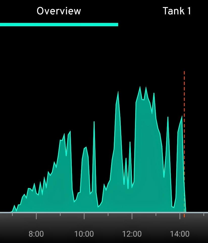

ToughButterCup Posted June 4, 2022 Share Posted June 4, 2022 On 02/06/2022 at 16:13, willbish said: ... Does anyone know if my UniQ eHW 12 will accept little bits of power from a PV diverter? .... 1.4kWh from mine so far today. Via Eddi. Link to comment Share on other sites More sharing options...
SteamyTea Posted June 4, 2022 Share Posted June 4, 2022 1 minute ago, ToughButterCup said: 1.4kWh from mine so far today. Via Eddi. Was that in little bits, or contiguous. Don't know about your bit of the country, but down here it was clear skies all day. Link to comment Share on other sites More sharing options...
ToughButterCup Posted June 4, 2022 Share Posted June 4, 2022 Link to comment Share on other sites More sharing options...
