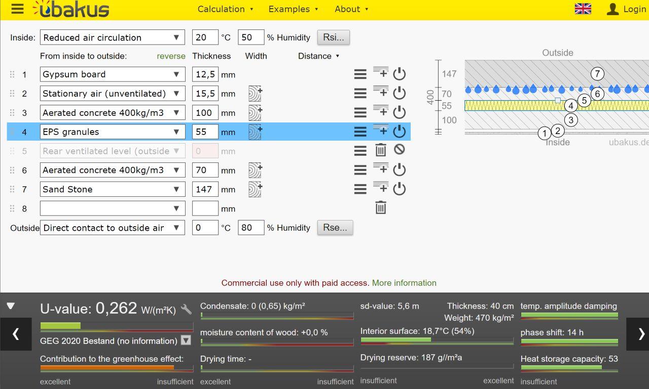

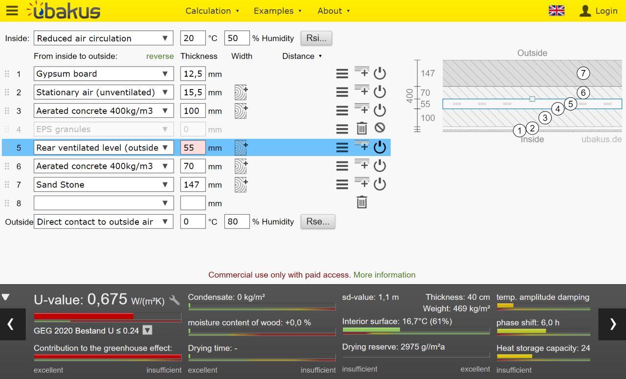

So, we've been "measured up" for Evobead (AKA Climabead) EPS in the cavities. Given the build date of our house (1997) the surveyor wouldn't believe me that our cavities were empty until he got out his SDS drill and borescope. I've run the build-up through Ubakus and it seems filling the 55mm cavity would take us from 0.675 W/(m2K) down to 0.262 W/(m2K)
93665769_Screenshot2022-07-0110_37_41.thumb.jpeg.de3040a4b5f435b2592129f6cb58ec55.jpeg
2120638247_Screenshot2022-07-0110_37_29.thumb.jpeg.277761c2f28be54c1eef5f2f128f8075.jpeg
Not brilliant but a whole lot better. 0.413 W/(m2K) saving over 160m2 and 20C difference amounts to 1.3kW less heat input needed during the coldest sort of days we get here. Working out an annual saving is a bit more difficult.
I guess around half of this for 6 months might be a ballpark ~ 2800 kWh or £170 ish.
I bet the cost makes this more than a 10 year payback.
