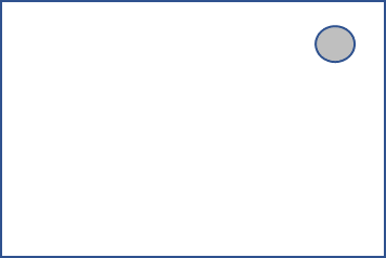

MortarThePoint Posted May 28, 2022 Posted May 28, 2022 I'm building the partitions of a bathroom and it's 1200mm wide for a 1200mm x 800mm shower tray. I'll be tiling onto the top of the tray (as shown below), but if I make the room 1200mm will the shower tray definitely fit or is there a tolerance that could catch me out. I'm hoping the tolerance is +0 / -Xmm so not allowed to be oversized, but hope isn't good enough. Does anyone know. I can easily wiggle an extra 3mm out of the plasterbard (1.5mm gap at each end) but wouldn't want to go much further.

MortarThePoint Posted May 28, 2022 Author Posted May 28, 2022 (edited) 37 minutes ago, PeterW said: what size ..? And depth ..? Any particular style ..? 1200mm x 800mm reasonably low. Not too fussy about style but needs yo be white or very light grey, but the waste needs to be in the middle of the short end or in the corner shown below. Something like : https://www.screwfix.com/p/mira-flight-low-rectangular-shower-tray-white-1200-x-800-x-40mm/1906x Edited May 28, 2022 by MortarThePoint

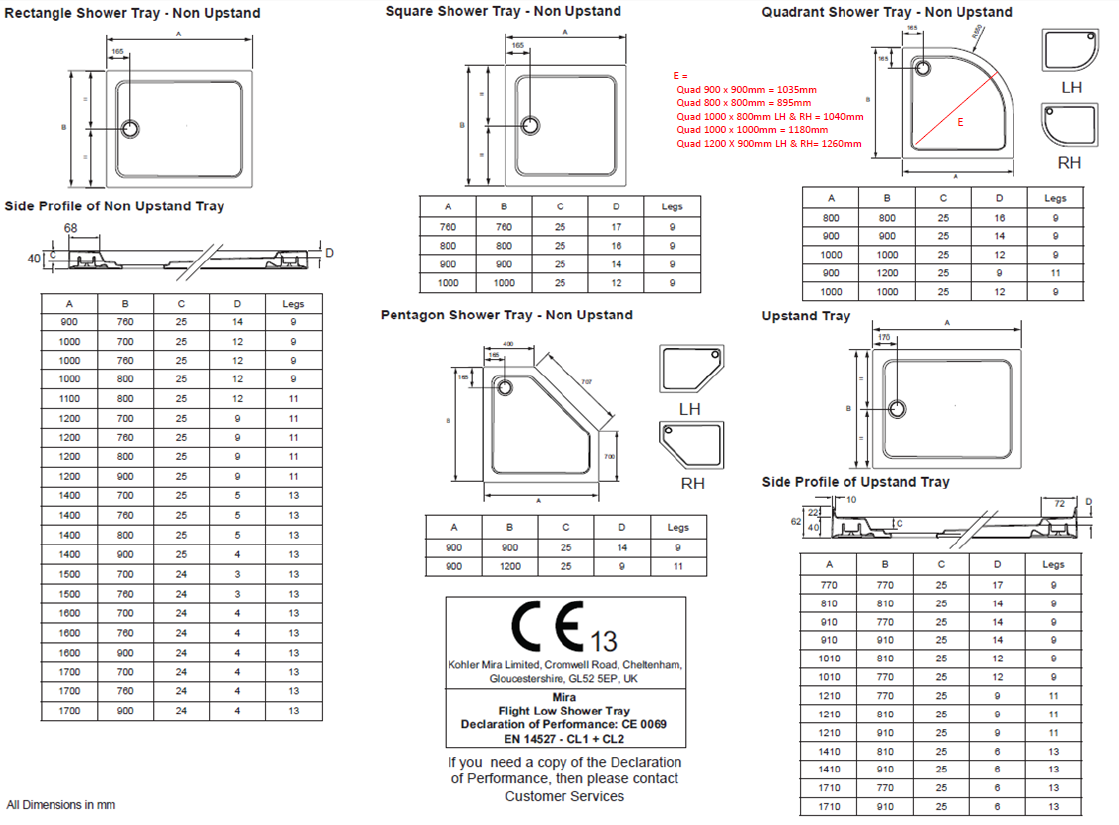

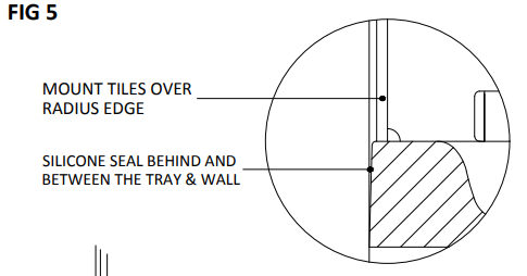

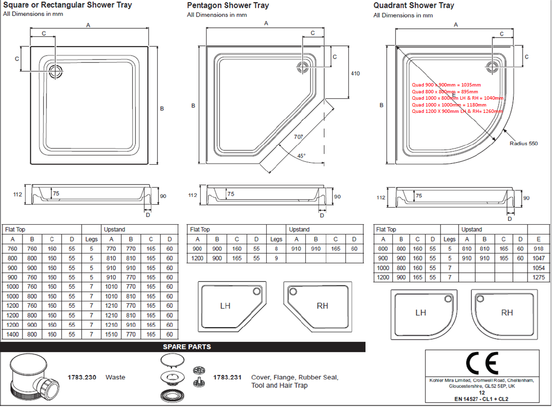

MortarThePoint Posted May 30, 2022 Author Posted May 30, 2022 (edited) On 28/05/2022 at 13:51, Conor said: Get the tray. Ours was nearly 10mm longer and wider than stated. Just went to City plumbing and they said would be spot on but was slightly over 1210mm. That was the with up stand type (see pic below), which may be slightly larger. The guys in the store were genuinely surprised when they saw what I measured. This was a 4 sided up stand Mira Flight 1200mm x 800mm. Edited May 30, 2022 by MortarThePoint
MortarThePoint Posted May 30, 2022 Author Posted May 30, 2022 Attached are the dimensions sheets that Mira emailed me, converted to images
