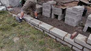

lstevensuk Posted June 5, 2022 Share Posted June 5, 2022 (edited) @Gus Potter @saveasteading Would anyone mind doing quick sketch of the blocks laid flat? I think understand the bonding but wanted to make sure.. also just about to order trench blocks. Edited June 5, 2022 by lstevensuk Link to comment Share on other sites More sharing options...
saveasteading Posted June 5, 2022 Share Posted June 5, 2022 Link to comment Share on other sites More sharing options...
Brickie Posted June 6, 2022 Share Posted June 6, 2022 Personally,I double them up (so two courses flat laid with the joints in line & then the next two laid half bond & so on.) The blocks compressive strength is standing upright-laid down it hardly takes any force with a hammer to crack them. That’s my reasoning,anyway. Link to comment Share on other sites More sharing options...
lstevensuk Posted June 6, 2022 Share Posted June 6, 2022 Oh ok thanks @saveasteading I think I missed the point that these are 300mm wide blocks? Link to comment Share on other sites More sharing options...
