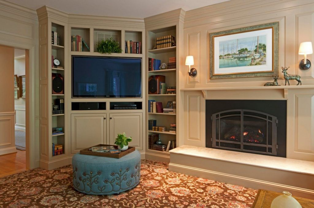

We are thinking of having our TV set up in the corner of our lounge, within a custom built storage unit, something like this, but with the tv lower down as I think this is too high:
I’m looking at combining it with a Sonos Arc sound bar which has Dolby Atmos. I presume the Soundbar therefore needs clearance above it, so that sound can be fired upwards towards the ceiling. Can I get away with placing the soundbar above the TV? Ceiling is 295cm high, so a 55” tv placed so that the top of it is about 125cm from the floor, leaves 170cm of space above for the sound bar. I know they are ideally meant to be at ear level, but can I put it higher, at say 160cm from the floor, this would be quite a bit higher than ear level when seated.
This might defeat the purpose of having a corner storage unit that SWMBO is insisting on to store a lot of the kids’ crap. Perhaps a solution is to have a shelf projecting forward out of the storage unit on which the soundbar sits so that the upwards firing  sound is not impeded by the storage space above the tv.
 Thoughts much appreciated!

Yes, that's a good point, I like it. Where should the soundbar go though, above or below the TV. Dolby guidance on this is a bit confusing. On one hand it says: "For optimum playback performance with dramatic overhead effects, mount the Dolby Atmos enabled sound bar at, or slightly above, a seated listener’s ear level." On the other hand, the very same article has a diagram showing the soundbar placed significantly lower than this: https://professional.dolby.com/siteassets/tv/home/dolby-atmos/dolby-atmos_sound-bar-setup-guide.pdf
To maximise storage under the TV (one of SWMBO's chief concerns) we would prefer to have the soundbar above the tv, but I query whether this will in any way mess up the soundscape.

I wouldn't let the Atmos side of things influence your layout too much. The effect is relatively subtle, and with upwards-firing speakers even more so to the point where there's every chance you might not even notice it.
Regarding height, I'm not sure where Dolby are expecting your TV to be (which should be at eye level when seated) if the soundbar is to be placed at ear level!

With Atmos you're either in or out. Pointless going half-cocked tbh. These need to be via dedicated speakers to get any actual effect, and I'm about to start installing cables in a clients build ( dedicated cinema room ) to do just this. Atmos effect will be delivered via a pair of flush Kef ceiling speakers, small enough to be as inconspicuous as possible as they do very little.
Sound bar should be lower, and take up so little room it shouldn't affect SWMBO's requirement for space below a correctly positioned TV as there would still be room above it?
