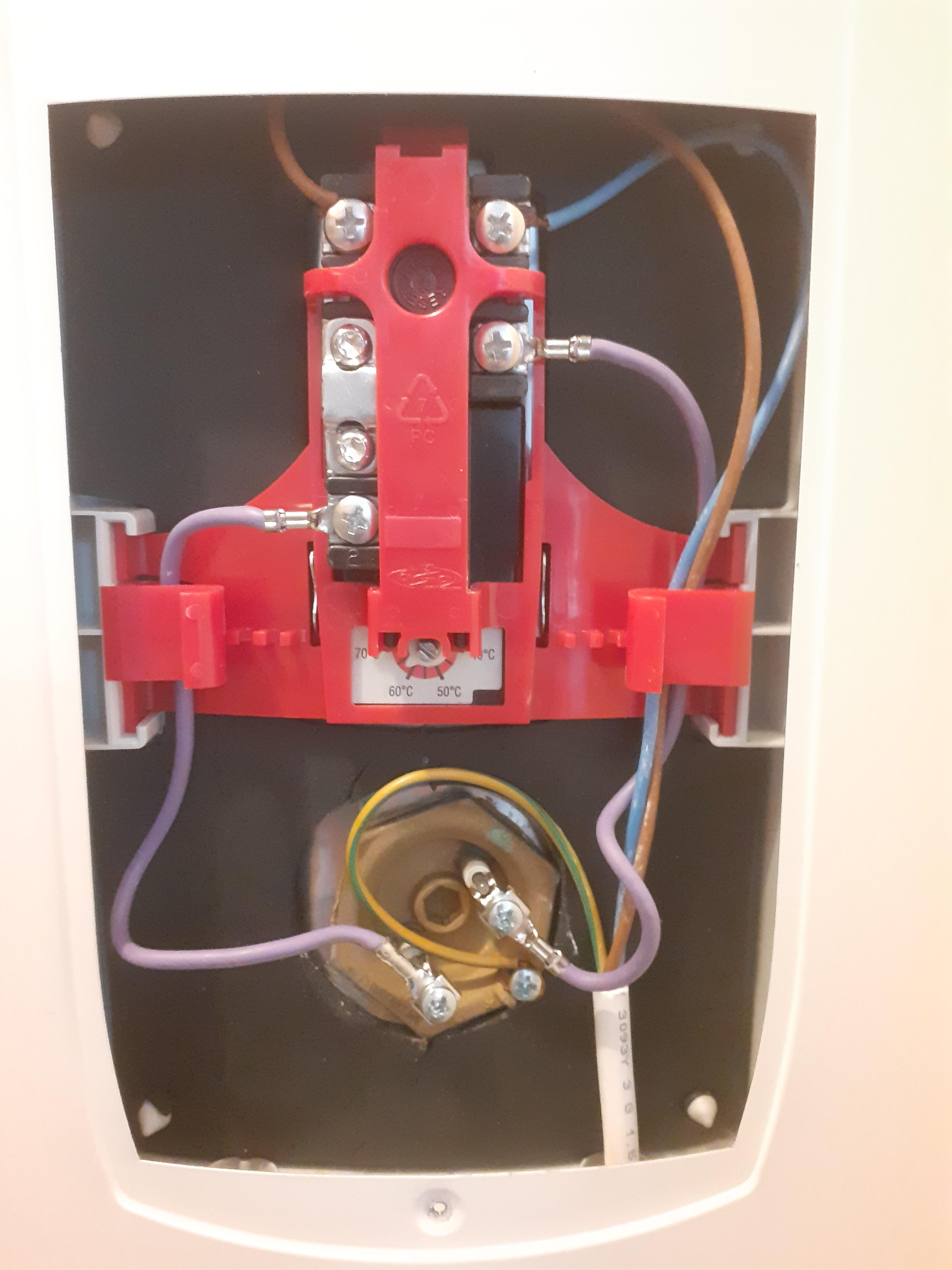

jamieled Posted May 19, 2022 Share Posted May 19, 2022 This will probably end in me calling a plumber anyway but I though it might be worth giving it a go here first. I have a relatively new OSO unvented cylinder with two x 3kw immersions. The top immersion is connected to a wall switch and wired to the CU which allows you to boost for 0.5, 1, 2 hrs. The bottom element is connected to a myenergi eddi which diverts from our PV and controls a programme boost to top up. We normally just use the bottom immersion. Today it seems to have stopped working. I first noticed when the eddi was exporting all our PV which is unusual. It seems to think the bottom thermostat is at temperature but the tank water is tepid at best. I'm guessing a broken element or thermostat - anyone like to hazard a guess? The OSO tanks/elements seem to have safety cut outs and reset buttons but they don't seem to do anything suggesting that is not the problem. The top immersion doesn't seem to work either - when I try and boost it from the switch it looks like it's on but it's not drawing power from the grid. To be honest I can't remember when (if)I've ever used it so it might have gone phut a while back. But the fact they're both apparently not working seems an unlikely coincidence to me. Link to comment Share on other sites More sharing options...

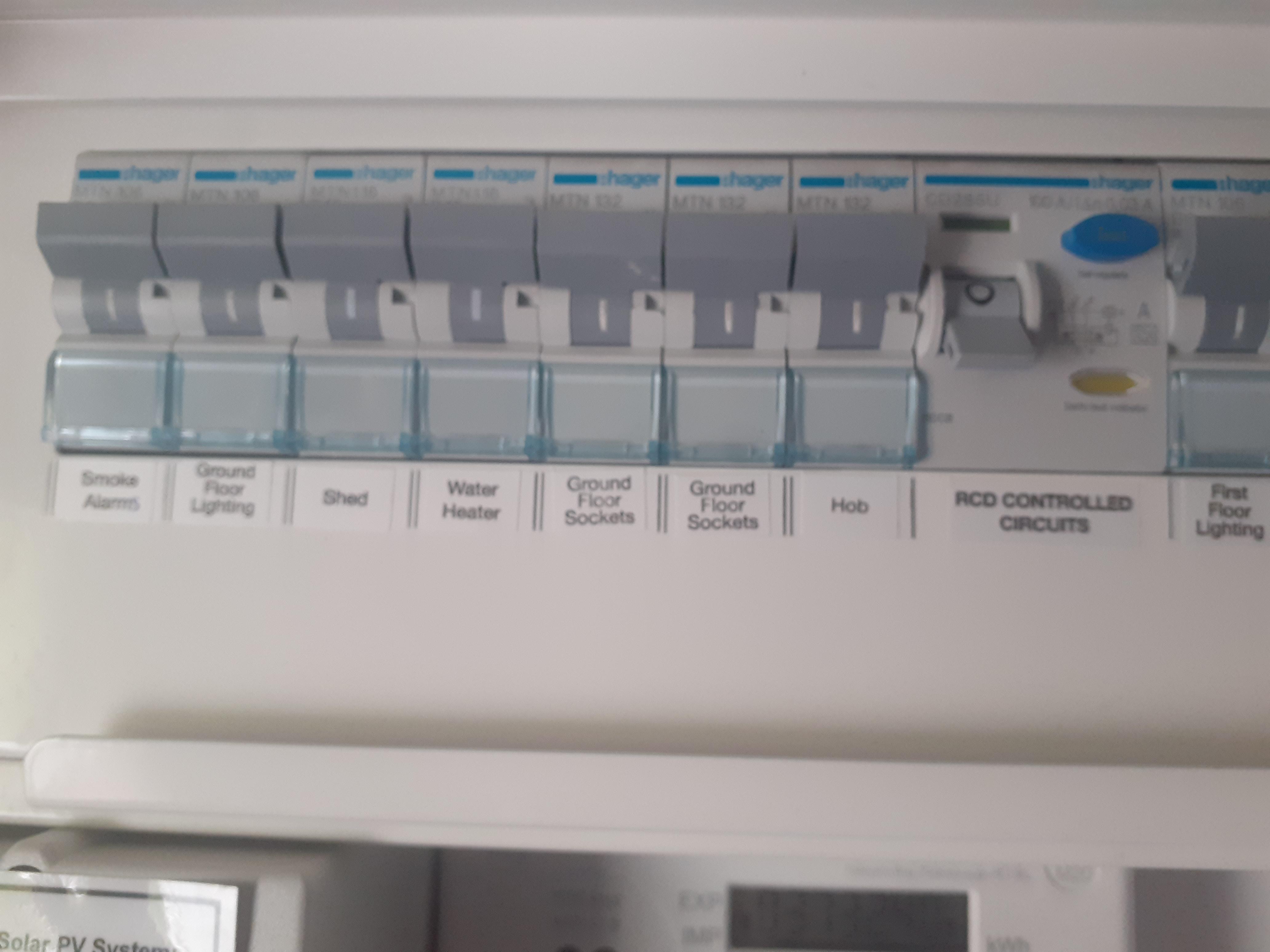

Marvin Posted May 20, 2022 Share Posted May 20, 2022 (edited) Have the fuses to the immersion heaters tripped? What type of fuses are they? MCB, RCBO? How long ago was the immersion installed? Edited May 20, 2022 by Marvin Link to comment Share on other sites More sharing options...
jamieled Posted May 20, 2022 Author Share Posted May 20, 2022 Pretty sure it'd rcbo but it's not something I know much about. New house, new CU about 1.5 years old. Same with tank/immersions. Nothings tripped. Link to comment Share on other sites More sharing options...

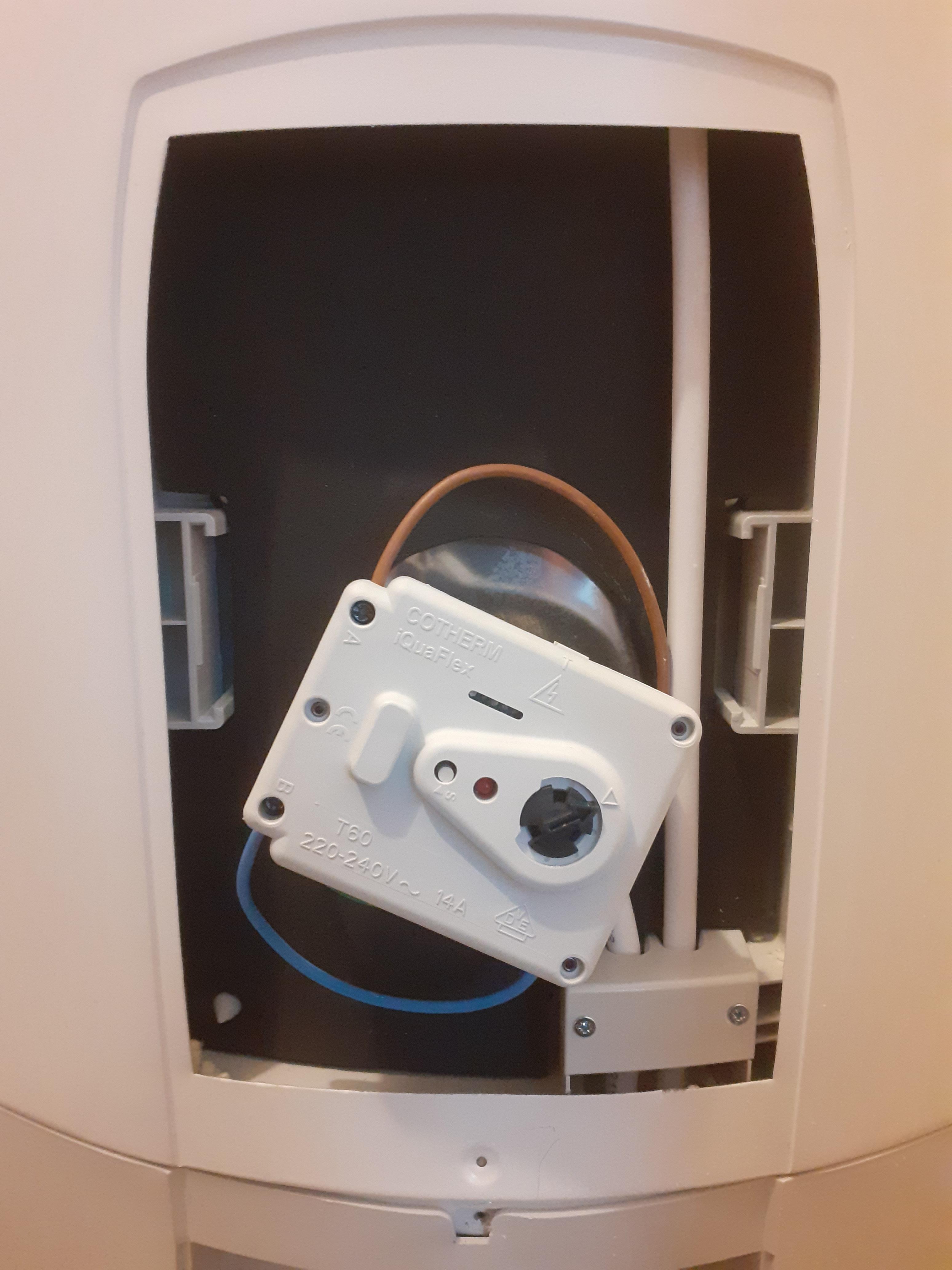

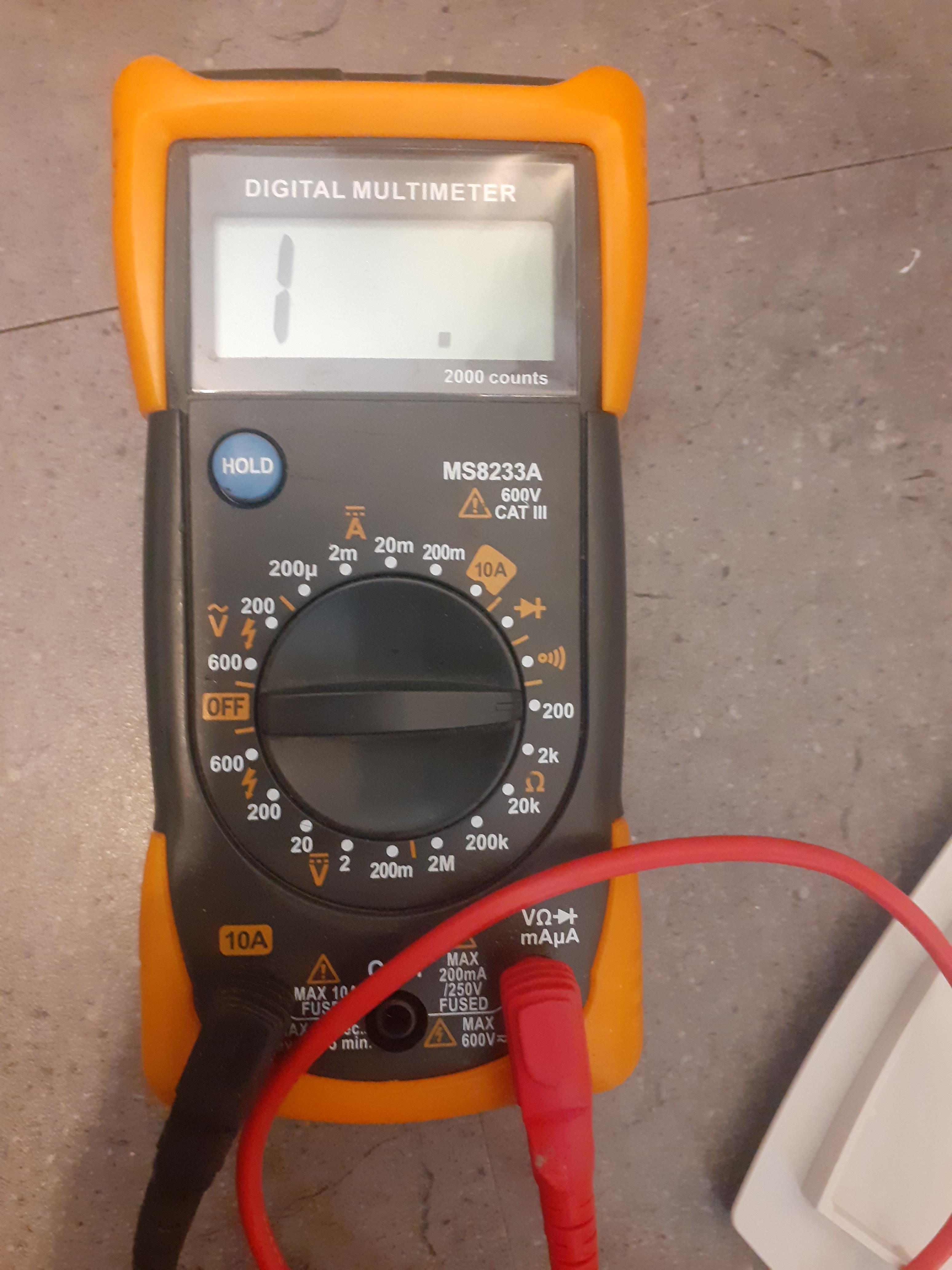

ProDave Posted May 20, 2022 Share Posted May 20, 2022 38 minutes ago, jamieled said: Yep, Have a multimeter. Turn the power off, there is usually a double pole isolating switch where the flex from the immersion meets the wall. Then with the multimeter on ohms range measure resistance between brown and blue where the flex joins onto each heater and post the result. Post a photo as well so we can see what thermostat you have on the heater. Link to comment Share on other sites More sharing options...
jamieled Posted May 20, 2022 Author Share Posted May 20, 2022 Both immersions gave a reading of about 18. Top: bottom: Link to comment Share on other sites More sharing options...
dpmiller Posted May 20, 2022 Share Posted May 20, 2022 Both elements are fine then. Link to comment Share on other sites More sharing options...

jamieled Posted May 20, 2022 Author Share Posted May 20, 2022 Electrician it is then. Is this likely to be related? Press the test button on the CU and it shows a yellow window which I believe is an earth fault? Link to comment Share on other sites More sharing options...
ProDave Posted May 20, 2022 Share Posted May 20, 2022 When you did the resistance measrements, was that at the 2 terminals actually on each of the heaters, or between the blue and brown of the incoming flex which will probably have landed at one of the thermostats? If the latter then the fault is not at the tank. Try and think of something common to both heaters, it would be unusual to have 2 faults together. It's not related to the RCD assuming the RCD turns on again okay? Link to comment Share on other sites More sharing options...
jamieled Posted May 20, 2022 Author Share Posted May 20, 2022 Thanks @ProDave. For the top immersion I can test on both the element and the incoming L and N attached to the thermostat. 18 ohms on the element and I get this on the incoming L and N: Bottom element just 18. Can't access the L and N as the ends are terminated inside the grey thermostat box. Link to comment Share on other sites More sharing options...
ProDave Posted May 20, 2022 Share Posted May 20, 2022 That is showing open circuit so the top thermostat is open. That red item in the first picture I think is the thermostat. Is that a black button at the top between those 4 terminals? If you press it does it go click? Is there any mention in the manual of how to reset the over heat safety thermostat? Link to comment Share on other sites More sharing options...
jamieled Posted May 20, 2022 Author Share Posted May 20, 2022 Yes, that is the reset button for the top thermostat. It doesn't do anything - the manual suggests there should be an audible click when resetting if the safety cutout has been activated. Link to comment Share on other sites More sharing options...

jamieled Posted May 21, 2022 Author Share Posted May 21, 2022 Embarrassing update no.1. The top immersion was not wired into the boost switch on the wall (the live cable end was terminated into a block inside the switch). I think this is from a miscommunication when we had a bit of damage from a line fault a few months ago-plumber replaced the damaged immersion element but the switch was never reconnected). Bottom thermostat is broken, but at least we have some working hot water now. Link to comment Share on other sites More sharing options...
ProDave Posted May 21, 2022 Share Posted May 21, 2022 You tried the reset button on the bottom thermostat? Odd that one cylinder uses 2 completely different forms of thermostat for the 2 heating elements. Link to comment Share on other sites More sharing options...
jamieled Posted May 21, 2022 Author Share Posted May 21, 2022 Yep, got the electrician to double check in case I was being dippy. The bottom thermostat is supposed to be some sort of 'smart' thermostat - changing the temp of the water as your usage changes but frankly I've never been able to notice it do anything other than a standard immersion with a fixed temperature. Link to comment Share on other sites More sharing options...
