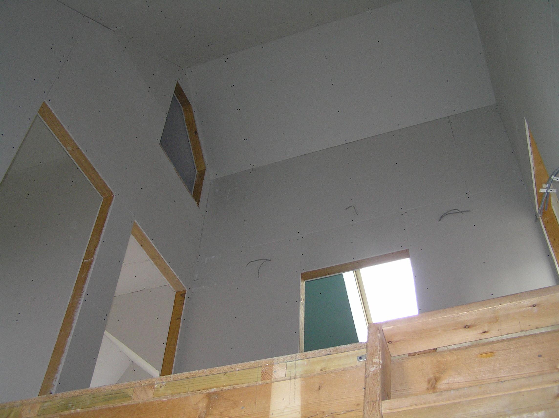

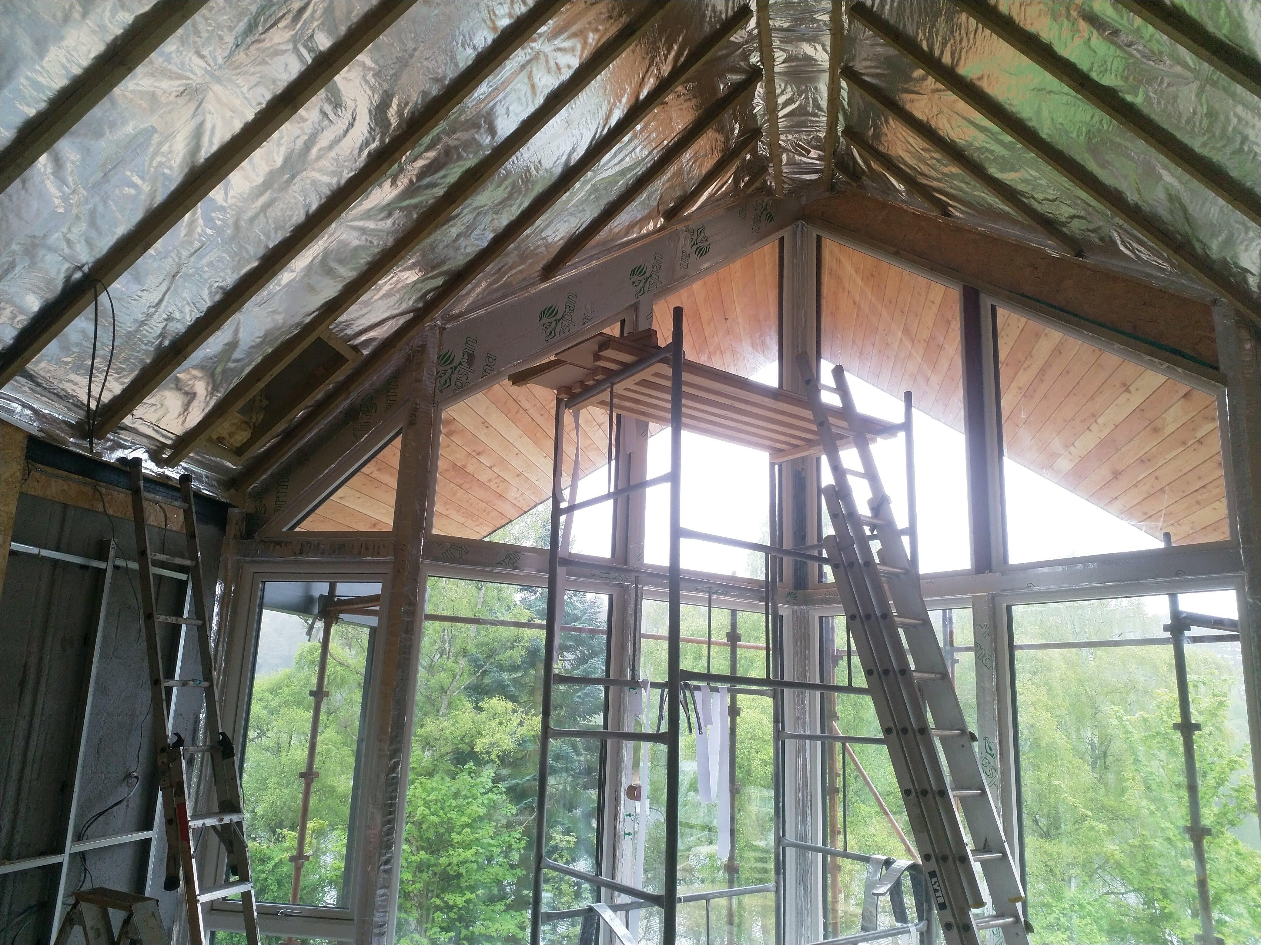

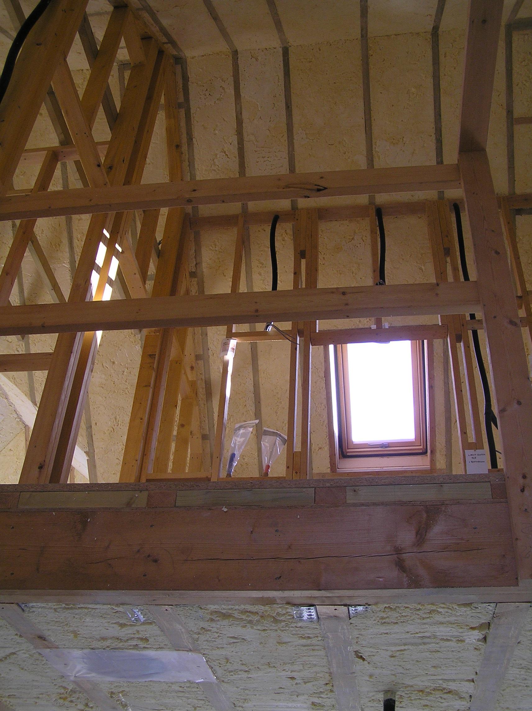

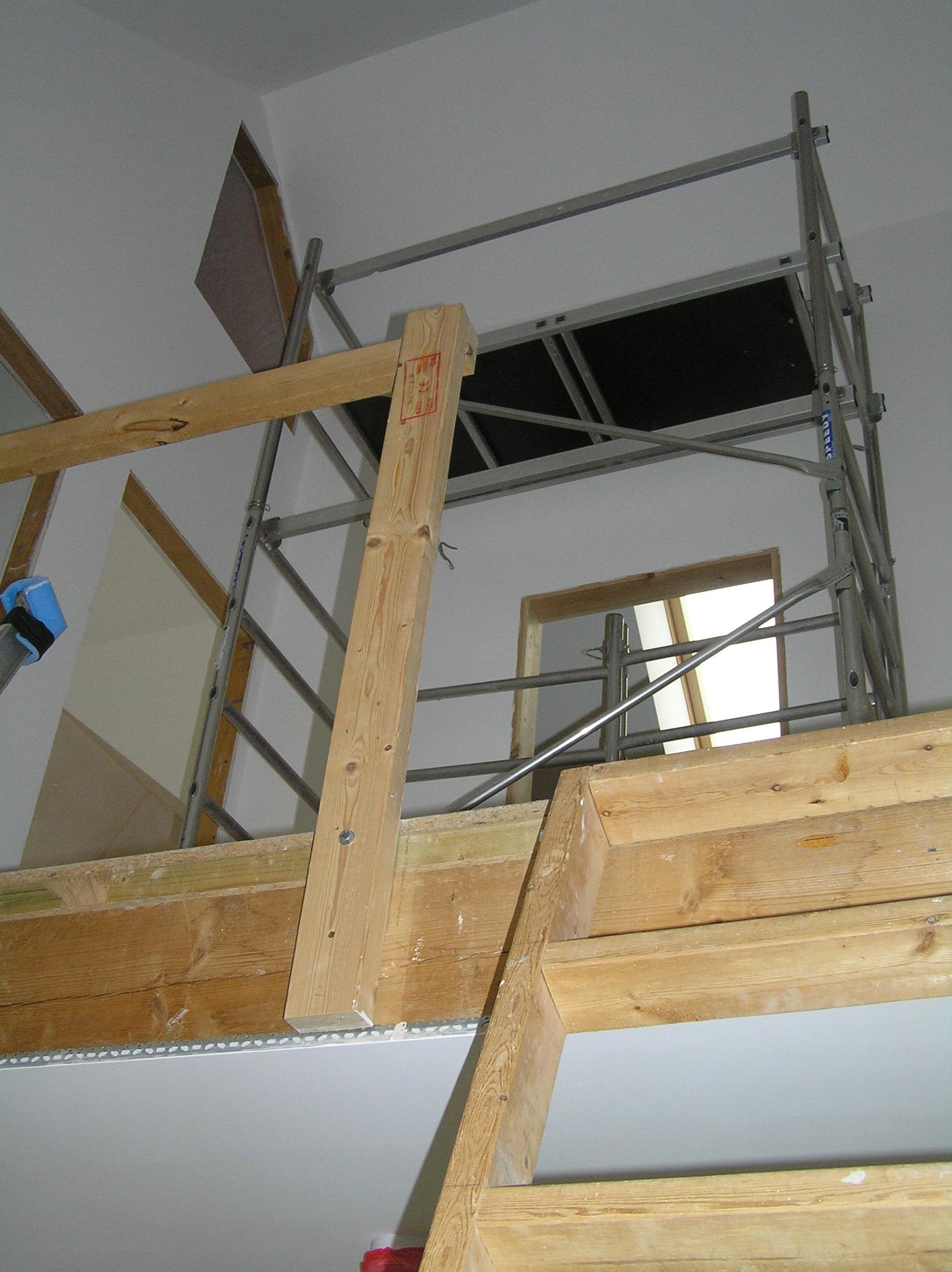

Very much like our roof single boarded with 12.5mm plasterboard, no cracks.
The only thing I did different was before fixing the battens to create the service void, I lined the entire roof and all the walls of the house with air tight membrane.
Only just started fitting the service void battens then in that photo

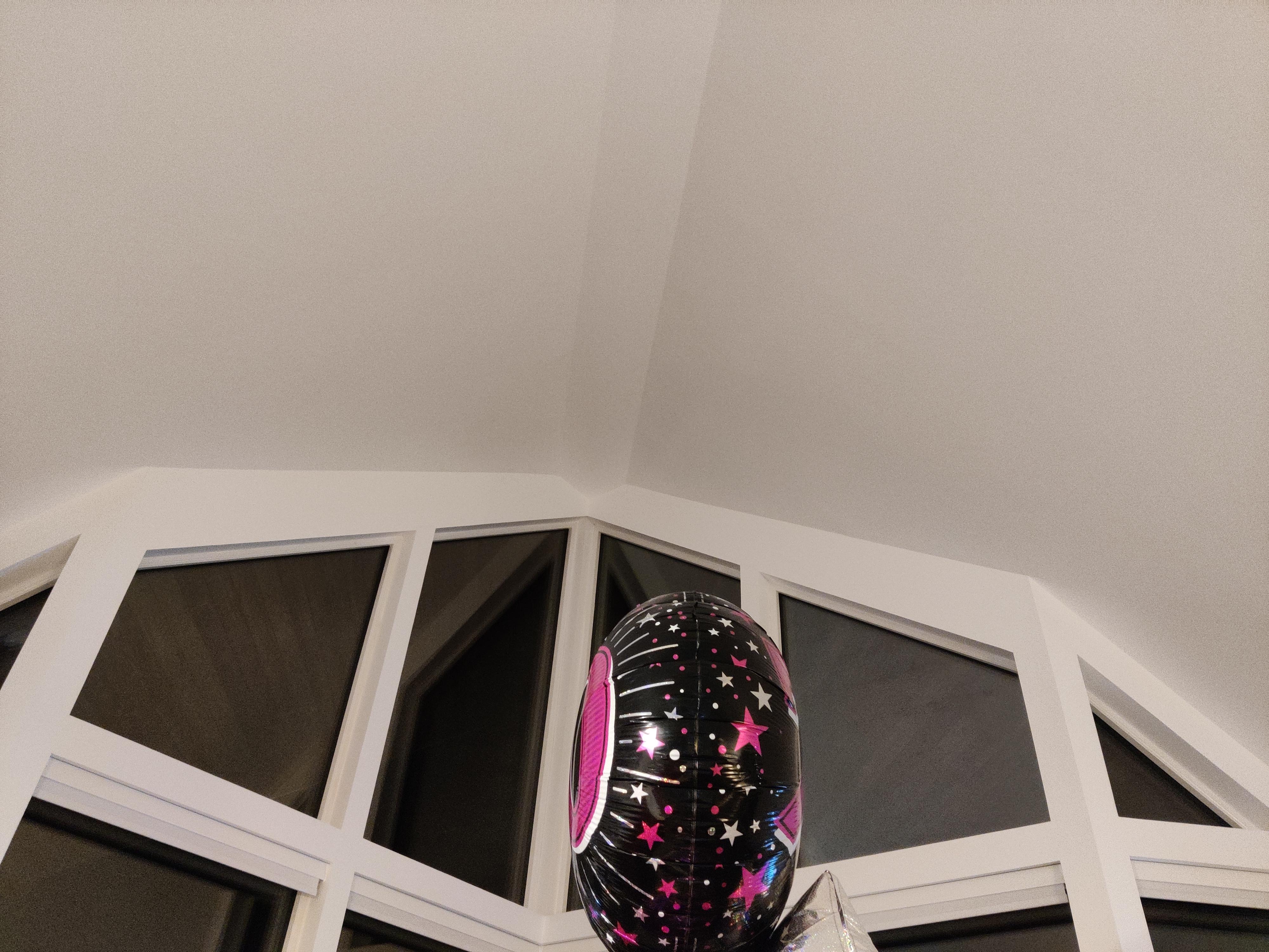

Similar to ours we used taper edge plasterboard, which taped and jointed, not skimmed.  9 months since jointing and taping no cracks.IMG_20210308_112222.thumb.jpg.bb79668f596557d9595039c63191dd10.jpgIMG_20210401_163843.thumb.jpg.1066eddc076c6d1fc071929c16ecd363.jpgIMG_20210524_162456.thumb.jpg.ee0b3abab14b44ae19923ee516ae3f55.jpg1643840889813898564191705513951.thumb.jpg.7fac7c2710b201e5912f318f59502e92.jpg

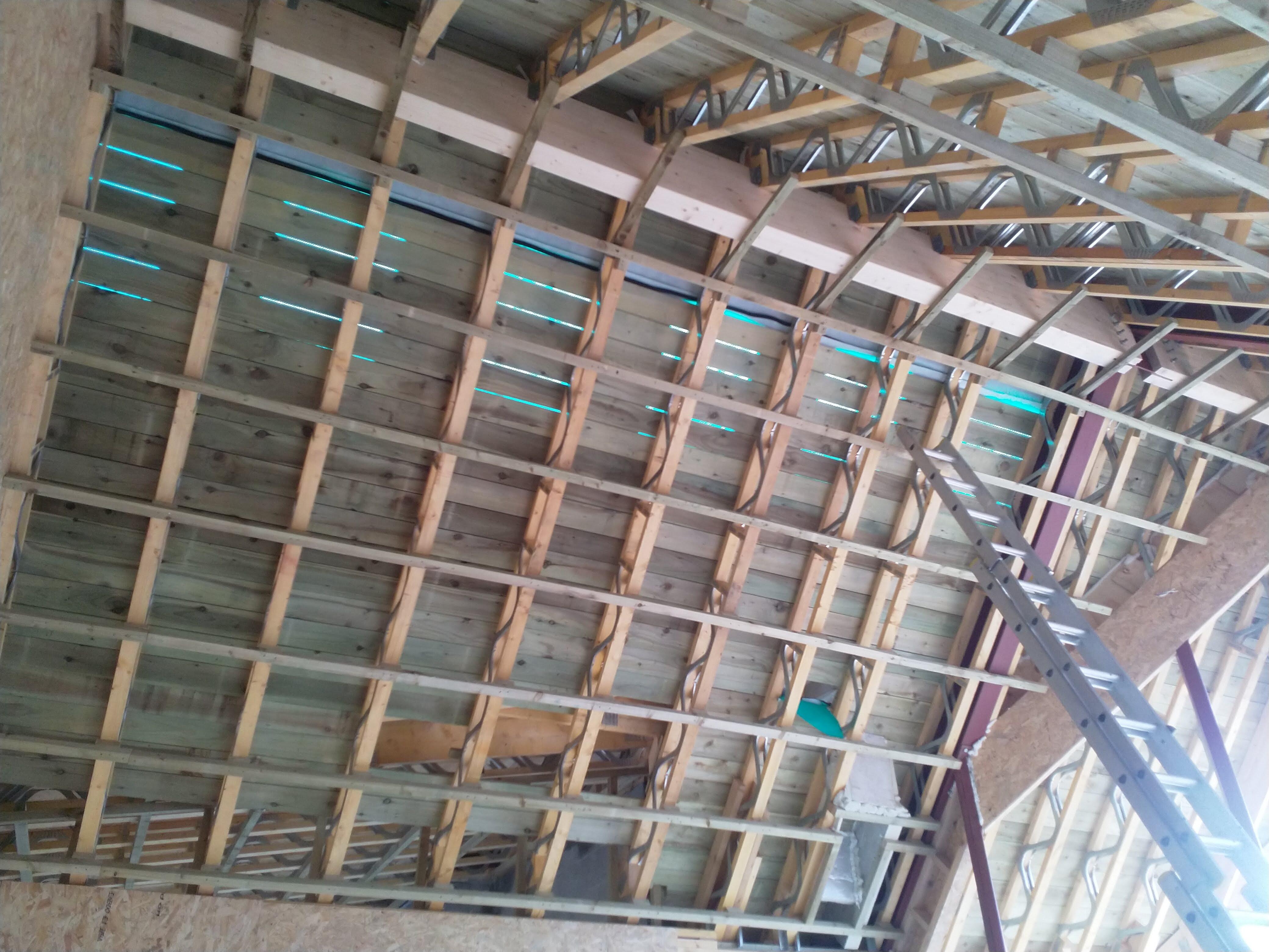

We just used battens.
The battens are vertical, but mainly because I had counter battens at the rafters to increase insulation thickness and kill off repeat bridges.
