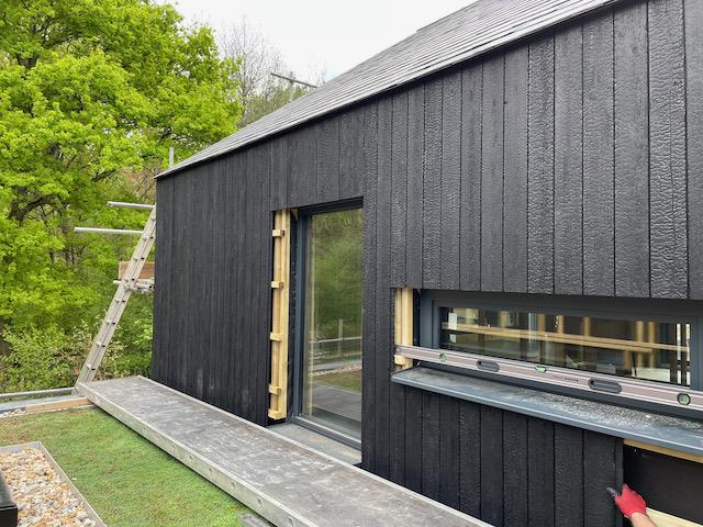

we were going to do this but as I've so far used nearly 3km of 2"x2" battens that would've been a s**t load of paint! in the end we decided to have a tongue and groove type profile for our charred cladding so that you can't see through it but also get a feeling of a shadow gap.
although we also used a black membrane as we were originally going to have an open cladding.
our build isn't ICF but as @Russell griffiths says you can put anything on top of ICF it shouldn't make a difference.

We got a quote for charred wood from Nakamoto Forestry, was a bit eye watering TBH so we will be reusing the boards the barn was clad with originally and will try burning them ourselves. What could possibly go wrong?!

we ordered through Permachar but it arrived direct from Lithuania from a company called Degmeda. problem is it's Siberian Larch so that is in short supply at the moment.
