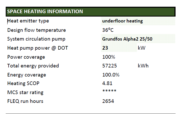

Risemead Posted May 13, 2022 Author Share Posted May 13, 2022 1 hour ago, IanR said: Hi and welcome. How about reducing the energy/heat losses of the building so that you don't need such a large (two boilers?) heating system. Are you saying you have calculated a heat pump to be 75% more day-to-day running costs than a fossil fuel boiler? or are you saying 25% less? Day-to-day running costs should be around the same. This is the quote I had for heat pump: Total electricity consumption 13277 kWh / yr Estimated Heat Pump fuel cost £3,757 Estimated fuel cost for boiler £5,043 per year Link to comment Share on other sites More sharing options...

Risemead Posted May 13, 2022 Author Share Posted May 13, 2022 56 minutes ago, nod said: We also looked at GSHP and dismissed for similar reasons We also dismissed PV for the same reasons Plus it looks awful ASHP will always be more expensive to run than gas But 75% more is way out We have a gas boiler and UFH on our first build Running costs are low Certainly for heating I would be looking more towards boosting insulation levels Total electricity consumption 13277 kWh / yr Estimated Heat Pump fuel cost £3,757 Estimated fuel cost for boiler £5,043 per year Link to comment Share on other sites More sharing options...

IanR Posted May 13, 2022 Share Posted May 13, 2022 (edited) 13 minutes ago, Risemead said: Total electricity consumption 13277 kWh / yr Is that space heating and water? For a GSHP they may have used a SCOP of 4.5, which would mean a roughly 60,000kWh annual energy requirement for heat and hot water. Unless you are providing hot water for 10, or have included a swimming pool, you could easily get that figure down to sub 20,000kWh annual energy requirement. 12 minutes ago, Risemead said: and the installation cost was around £25k GSHP install cost do not make the small efficiency increase over ASHP worth it. An ASHP install cost should be in the region of £5K to £10K more than the equivalent gas install, and you can get £5K back in a BUS grant. Edited May 13, 2022 by IanR Link to comment Share on other sites More sharing options...

IanR Posted May 13, 2022 Share Posted May 13, 2022 (edited) 55 minutes ago, Risemead said: please let me know if you have anyone who can quote me, It's not about who is quoting you. It's about the property's space heating requirement being 57,225 kWh. On your property, with cost effective measures, you could get this down to around 8,500kWh. Whether it's heated by gas or electricity, the property needs the same amount of heat energy inputted to maintain the required temperature. A 90% efficient gas boiler(s) will meet that requirement with 63,583kWh of gas, or an 481% efficient GSHP will meet it with 11,897kWh of electricity.. @ 7.37p per kWh of Gas and 28.34p per kWh Electricity, the heat pump will be cheaper to run day-to-day, but if you design, engineer and build better and get the 57,225 kWh energy requirement down to 8,500kWh both options would be much cheaper to run and install. I believe there is around a £2,750 per year cost save by improving the energy efficiency of your house. The parts of the build that improve energy efficiency should have a 50-60 year life, but even if you only considered a 25 year life then that's a £68,750 budget for energy efficiency measures. Edited May 13, 2022 by IanR 2 Link to comment Share on other sites More sharing options...
