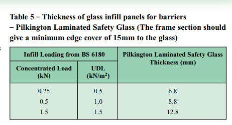

I googled to see if 6.8mm laminated met 0.74 kN/m. Found only this..
https://www.pilkington.com/~/media/Pilkington/Site Content/UK/Reference/BRGlassMechanicalStrengthPDF.ashx
“The table has been based on maximum glass area of 3.4m2.” E.g. a 6.8mm laminated pane, 3.2m2 in size can take over 0.25kN concentrated load. That was my interpretation.

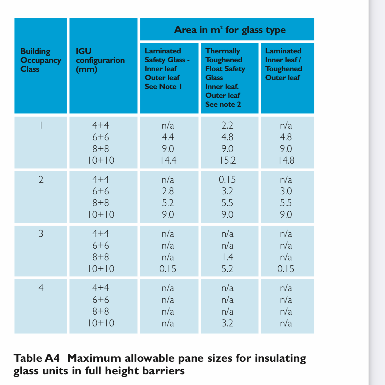

On page 7 of the FH Brundle doc there is table for DGU units.
https://www.fhbrundle.co.uk/files/pdf/co1/Technical/Glass Loading Data Sheet 7.2.pdf
It is pretty clear to me that a 2.0m2 DGU with 6.8mm laminated pane and 4mm toughened pane would pass the 0.74kN test. How you convince the BCO is a different matter. Not to mention how astragal bars effect the calculations, SHMBO has our windows in full prison bar look, so each pane is essentially reinforced.

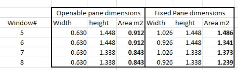

All the windows in question are first or second floor. In total, we have four such windows, and one of them is my son's bedroom, although directly outside it is a pitched roof over our ground floor, rather than a straight drop to the ground. He is only 2 but already built like a 3 year old and likes to charge around like a mini bull, so I'm glad the BCO is making a fuss. The areas of the individual panes are as follows:
So the panes vary in sizes from 0.84m2 at the small end to 1.49m2 at the large end.
I don't really understand the table that @Nick Laslett has posted, but if a residential property (a conversion, not a new build) counts as class 2, then the only figure on that part of the table which is below my window sizes is 0.15m2 (which doesn't make much sense because who could fall out through such a tiny opening and my windows are all significantly smaller than the other areas in that part of the table. However, that table shows 4+4 and 6+6, whereas I'm going to be some sort of weighted average of the two being 6.8 + 4. I wonder if this is going to be another lawsuit?
Right. I had a similair issue. In my case it was no no such tables for triple-glazing in your case your glass make-up isn't listed.  I agree, if you just use this table then you need 6+6, but the reality is that your units are almost certainly fine, it's just a paperwork issues.

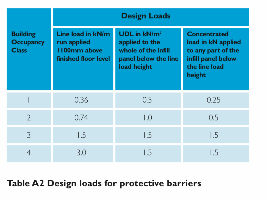

What is you cill height for the largest 1.026x1.448m windows?  This is important as the line and area loads need to be calcuated 1.1m from floor level.
I haven’t got a tape measure to hand (just moved in yesterday - not sure which box it is in!), but it is about 66cm I would estimate for that window.

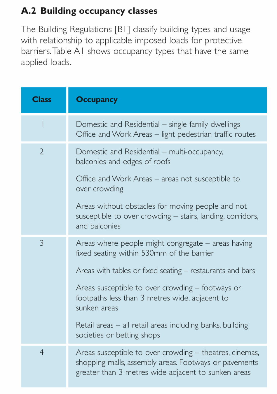

Most of your house is Occupancy class 1. Protective barriers in this class only need to pass 0.36kN load. Occupancy Class 2, covers balconies, landing, stairs & corridors. Protective barriers in this class need to pass 0.74kN load. I’m not sure if any residential dwelling windows should be in Occupancy Class 2. Document K, section K4 refers to glass in windows with chills below 800mm needing to pass Class 3 of BS EN 12600, most toughened and laminated glass satisfies this requirement.
I thought this web page explained it well.
https://www.bereco.co.uk/blog/navigating-complying-uk-building-regulations-windows-doors-v1-new-homes
Edited by Nick Laslett
Landing, stairs and corridors are Class 1.   Balconies, julliete balconies and "edges of roofs" are Class 2.  Our BCO and window supplier were both consistent is saying that low-level first-floor windows (with no roof flat roof outside) fell into Class 2 and not Class 1.
That table you copied isn't particulalry clear, take a look at this for example, which adds more colour: https://techhub.uk.saint-gobain-building-glass.com/sites/default/files/document-files/Guards %26 Barriers 2A - Applied Loads - 17-09-2018.pdf
