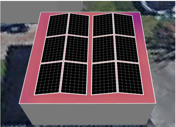

Ronski Posted May 11, 2022 Posted May 11, 2022 I'm still getting quotes, as I'd prefer an installed system, but that depends on how much the quotes come in at. One of the quotes I'm waiting on by Convert Energy seems very thorough, but he's said there is a mandatory 300mm setback between the panels and the limits of the building envelope. So rather than south facing he's going to quote on east/west, which means the panels can be fitted closer together, and thus use larger panels. So the actual estimated annual energy is actually slightly more than south facing with smaller panels 330 v 405w, the 405w would produce more south facing but won't allow for the 300mm around the outside. These are the mounts I found, but couldn't find any prices online, they do different ones for different roof materials and cold roof/warm roof etc.. https://www.nicholsonsts.com/products/rooftrak https://source.thenbs.com/category/uniclass/roof-anchors-for-solar-modules/wyCiF7pKPZkGMc1XvA1ejY/search-results/products?f=Category&v_1=Roof anchors for solar modules&score=0 Technically I'd argue that by definition a flat roof does not have a ridge line, I think you need to be within 200mm height to count as permitted development, put a parapet along the side that won't cause shading, and suddenly you have more height. If you put the panels at too shallow of an angle they won't self clean, and dirt and debris will build up, unfortunately I've no idea what that angle is.
MrTWales Posted May 11, 2022 Author Posted May 11, 2022 I hope you are right about the ridgeline point. I fired off an email to the council planning permission email yesterday but I'm not sure I'll get a reply. Not sure why you need 30cm from the edge. There must be a reason though. I guess it's not that much but it would be a miracle if you could use all the space with limited panel size options as you say. Is the east/west thing as they want to fit rows along the long edge to minimise the gaps? In my case I'd want to line the panels along the longer edge so hopefully that helps, but I'm not finding it easy to even get quotes at the moment.
Ronski Posted May 11, 2022 Posted May 11, 2022 The east west thing is to get bigger panels on, with the panels all facing south, you need spacing to stop one row shadowing the next, with east/ west think of a flattened upside down W, so you don't need space between the panels so they fit better in the limited space. I actually like the appearance better as well, and another benefit is its easier to fit bird protection to stop those pesky pigeons nesting under there. I think there's two possible reasons for the 300mm gap, one is access, the other could be related to wind, but the panels on my main roof are about 200mm from the edge, so I don't think everyone adheres to it. I've had a hard time getting quotes as well, emails just deleted, silly prices, systems that don't do what I've asked them to quote for etc.
MrTWales Posted May 11, 2022 Author Posted May 11, 2022 Just measured and, allowing for 30cm from the roof edges (not the wall edges as the roof extends a bit), I've got 6 meters by 5 meters. It seems like I could have 4 long rows of 3 panels potentially, which would be a decent size. No doubt there are a million reason why it won't happen though ... SIGH.
MrTWales Posted May 11, 2022 Author Posted May 11, 2022 Thanks - love the diagram. Did they say how much space you need between panels? Can you tell me how big your roof is and what overall (theoretical) power the panels would amount to? You have 12 panels there which is what I was coming up with, but I'm just assuming that the gap doesn't have to be huge and I was looking at 169cm x 105cm panels. In theory, 12 of those panels is 4.5kw/h (though less for the angles etc). 4 minutes ago, Ronski said: The east west thing is to get bigger panels on, with the panels all facing south, you need spacing to stop one row shadowing the next, with east/ west think of a flattened upside down W, so you don't need space between the panels so they fit better in the limited space. I actually like the appearance better as well, and another benefit is its easier to fit bird protection to stop those pesky pigeons nesting under there. I think there's two possible reasons for the 300mm gap, one is access, the other could be related to wind, but the panels on my main roof are about 200mm from the edge, so I don't think everyone adheres to it. I've had a hard time getting quotes as well, emails just deleted, silly prices, systems that don't do what I've asked them to quote for etc.

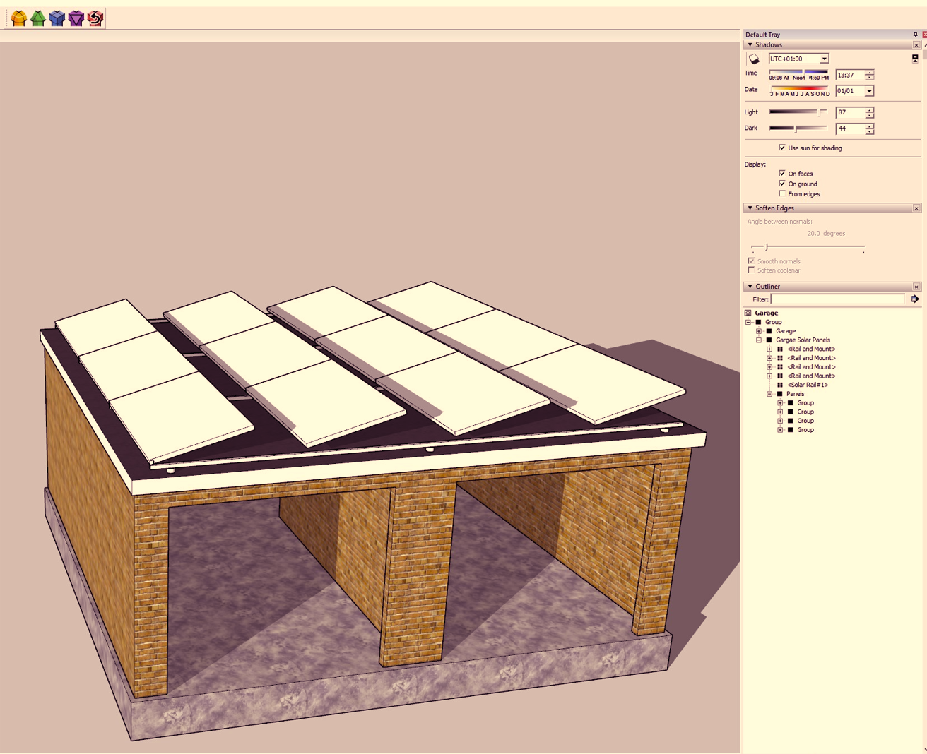

Ronski Posted May 11, 2022 Posted May 11, 2022 I have a thread here which detail some of what you ask If the panels are all facing the same direction then panels shading panels will be an issue on your roof, it is on mine, mainly in the winter months though when the sun is low, even with the panels at a shallow angle. I modelled the garage/panels in Sketchup, and can then see how the shading is: The above is at 13:30 on the 1 January, the shading only gets worse as the day goes on, and in winter you need every bit of sun you can capture, days are short, the suns low, and not very powerful. The panels are at 15 degree's, and they are 1722 x 1134.
