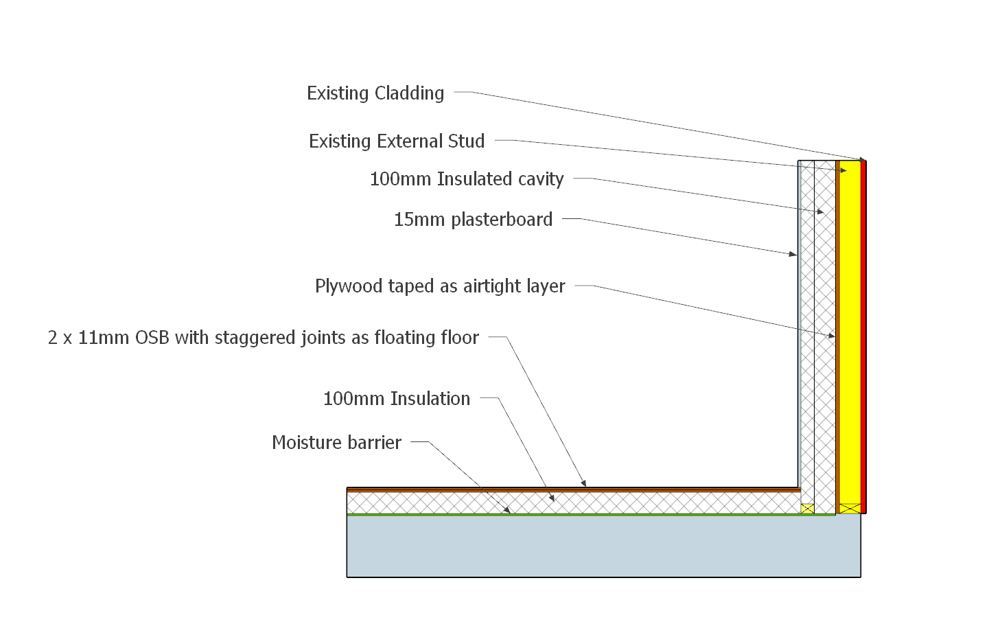

Iceverge Posted May 17, 2022 Share Posted May 17, 2022 40 minutes ago, AnnieG said: I am looking at converting a large shed into an office. It is cedar lap on 2x4 struts and seems very solid. I’d like to use sheep wool insulation, but was assuming I would have to line the inside first. I’d be very happy if that was not the case! So if I understand you correctly, you have the outer wooden shell, then insulation and osb forming the walls on the inside? Nothing more? Pics always help. What level of use do you expect to get from it? Will it be used 40hrs per week or 30 mins every couple of days? Sheep wool is a nice product but if you just shove it between the studs as is (assuming no membrane externally) , it'll get wet and infested with creepy crawlies. Also your timber frame and cladding will rot and decay without proper ventilation. Post some pics and a solution will be forthcoming!! Link to comment Share on other sites More sharing options...
SimonD Posted May 18, 2022 Share Posted May 18, 2022 23 hours ago, AnnieG said: So if I understand you correctly, you have the outer wooden shell, then insulation and osb forming the walls on the inside? Nothing more? Yep, that's correct. It's obviously not the recommended buildup and due to various building delays has been in use for a lot longer than imagined and planned. My upcycled garden office has just a slightly different filling of insulation in that the studs weren't deep enough to accommodate 100mm of insulation so I installed two layers of 50mm, one between the studs and the other within counter battens to the inside, then the osb. It gets used, fully heated for upwards of 60 hours per week, has never had a problem with condensation and my wife says it's comfortable all seasons. I've used the garden office as a bit of a test to see if it does attract bugs and stuff, including leaving a gap created by damaged cladding where I can see the insulation. It's still there, intact and no sign of any bug activity anywhere and no damp. One spring there were some little birds that pulled some out from this gap, which I later found in a nest in the bushes, must have been very comfy for them. I used Thermafleece which isn't a pure wool as it uses a percentage of recycled polyester. Very happy with how it has performed. In the house I have almost the same buildup but it adds a breather membrane and ventilation space behind the cladding which is really how it should be done. Link to comment Share on other sites More sharing options...

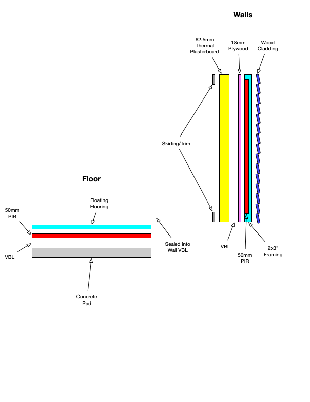

Adthrawn Posted May 26, 2022 Author Share Posted May 26, 2022 I've been back and forth on what to do, but thinking of something like this: [external cladding] -- [2x3" frame]+[50mm PIR inside frame] -- [18mm plywood] -- [vapour barrier] -- [62.5mm PIR insulated plasterboard] I want to avoid removing the existing 18mm plywood internal walls, as the frame was built with it in panels, and has been overlapped, so in corners I'll have to cut the plywood in order to remove it. Instead, I'll just be removing the external cladding, pulling the old membrane out and removing the old insulation. I'll check the inside face of plywood and the frame as well. The old membrane is definitely in the wrong place, so that really has to go. I then plan to fit 50mm PIR into the frame, pushed against the internal plywood skin - and PU expanding foam in gaps. That'll give me a 20mm air gap between the cladding and the PIR. I'm hoping the exposed frame is enough to allow moisture in the frame and plywood to dry. At the top of each frame void, I'm planning on cutting a ventilation vent, with something like a 50-60mm vent. I don't think I need a bottom vent, as the overlap of the cladding isn't amazing anyway so should air out. If there are noggins, need to figure out how to allow ventilation around them. Over the internal plywood skin, I'll fit a membrane - and will seal that with the membrane I'll lay on the concrete pad (I've made assumption it's not insulated). I'll then put 50mm PIR onto the floor, and will fit 50mm insulated plasterboard (it's 62.5mm finished thickness) over the plywood. Now, my next concern is if the plasterboard needs to be kept away from the vb/vb away from the plywood layer? The drawings I've seen show the plasterboard on the vb, which is fine - but rather than having OSB etc on the outside of the frame, I've got plywood on the inside of the frame. I don't know if I'm trapping the plywood to the degree it'll never be dry... Or if the exposed timber frame will be sufficient to allow the plywood to dry out. Frustratingly, the manufacturers provide very contradictory information - Kingspan's site says one thing in the PDF, their calculator shows completely different installation, and then advice is differing again. Link to comment Share on other sites More sharing options...
Adthrawn Posted May 26, 2022 Author Share Posted May 26, 2022 I've drawn up the plan of attack... Link to comment Share on other sites More sharing options...
Nickfromwales Posted May 26, 2022 Share Posted May 26, 2022 2 hours ago, Adthrawn said: I've drawn up the plan of attack... Better than my shed 😭. I wish I’d insulated. Tbh, I’ve only feather-edged one 1/4 so I may pull that off and just stuff the 4x2 frame with rock wool. Either that or pour vermiculite into the voids and just remove the top couple of planks. Anyone know if vermiculite has any reasons to not use it? Do vermin like the stuff etc? Link to comment Share on other sites More sharing options...
Adthrawn Posted May 27, 2022 Author Share Posted May 27, 2022 14 hours ago, Nickfromwales said: Better than my shed 😭. I wish I’d insulated. Tbh, I’ve only feather-edged one 1/4 so I may pull that off and just stuff the 4x2 frame with rock wool. Either that or pour vermiculite into the voids and just remove the top couple of planks. Anyone know if vermiculite has any reasons to not use it? Do vermin like the stuff etc? From what I’ve read up, ventilation in the insulated void is key. I think a rock wool is your best bet. You could always internally insulate as well, and put a vapour barrier over it (or just seal the edges of PIR with silver tape). Link to comment Share on other sites More sharing options...

Iceverge Posted May 27, 2022 Share Posted May 27, 2022 Following the example of the States I don't think there's anything wrong with an air barrier external to the insulation provided the wall can dry to the inside and you do a top job on airtightness. In fact I think @IanR has an external airtightness layer, albeit with a breathable board outside. If the existing structure is ok I would avoid dismantling it, especially with kids and limited time. Building has a habit of taking 3 times longer than you expect. I would install the final windows and doors in the structure as is. Make your own blower door fan and make the external plywood totally sealed with tape at all the joints and to the floor. This isn't hard and is ideally suited to the DIY'er. Given it's your own project you're lightly to get a top result too. Then build a stand alone stud wall (63mm CLS minimum) stood off the ply internally by say 100mm. (can be increased/decreased) This will create a handy void for all your services. Fill this with mineral wool/ rockwool insulation and the gap between the studs. Finally plasterboard internally. You may need vapour retarder plasterboard/ foil backed to keep the vapour in check. To really add polish use blown cellulose in the void. Pretty cheap and very easy to do in bits as it's all internal. Equally importantly, given your busy life at any point in the progress you can close the door and walk away as all the work is internal. As for the floor, Insulation board (as much as you can fit) and then a floating floor or 2 layers of staggered OSB. If you have the head height you could use a pumped screed with UFH. Link to comment Share on other sites More sharing options...

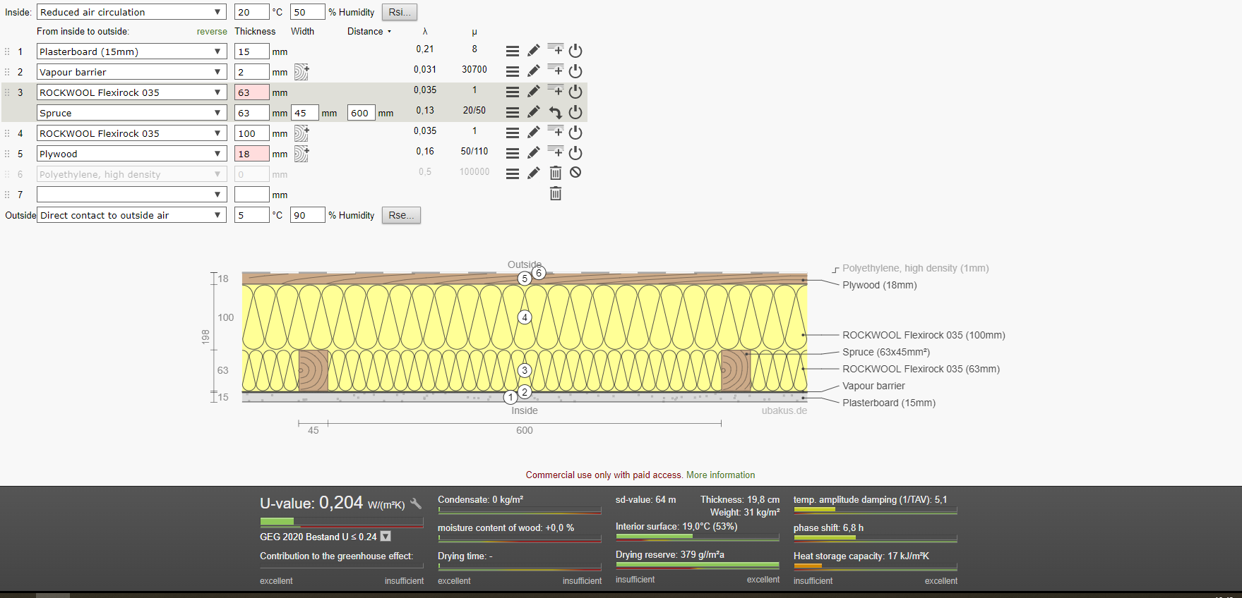

Adthrawn Posted May 28, 2022 Author Share Posted May 28, 2022 On 27/05/2022 at 18:46, Iceverge said: Following the example of the States I don't think there's anything wrong with an air barrier external to the insulation provided the wall can dry to the inside and you do a top job on airtightness. In fact I think @IanR has an external airtightness layer, albeit with a breathable board outside. If the existing structure is ok I would avoid dismantling it, especially with kids and limited time. Building has a habit of taking 3 times longer than you expect. I would install the final windows and doors in the structure as is. Make your own blower door fan and make the external plywood totally sealed with tape at all the joints and to the floor. This isn't hard and is ideally suited to the DIY'er. Given it's your own project you're lightly to get a top result too. Then build a stand alone stud wall (63mm CLS minimum) stood off the ply internally by say 100mm. (can be increased/decreased) This will create a handy void for all your services. Fill this with mineral wool/ rockwool insulation and the gap between the studs. Finally plasterboard internally. You may need vapour retarder plasterboard/ foil backed to keep the vapour in check. To really add polish use blown cellulose in the void. Pretty cheap and very easy to do in bits as it's all internal. Equally importantly, given your busy life at any point in the progress you can close the door and walk away as all the work is internal. As for the floor, Insulation board (as much as you can fit) and then a floating floor or 2 layers of staggered OSB. If you have the head height you could use a pumped screed with UFH. Thanks for that! The building is definitely trapping moisture inside - I don’t think the polythene sheet is helping matters. Ventilation will help of course. I’ve ordered both the PIR and thermal plasterboard (plus vapour barrier). Will be using the 50mm on floor too. Taking the cladding off, affords me the opportunity to check the structure. Ivy has gotten under the frame in a few places, plus there may be some damp patches too. As I’ll need to take the metal roof trim off as well, it’s also going to give me a chance to refit that and improve water tightness all round. I’m also fitting a large bifold door, so will have rework the front wall anyway! I know we’re putting quite a bit of money into it, but it’s going to be our workspace for the next 5-7 years easily and we’ll have some specialist printers in there that need to be kept warm… Link to comment Share on other sites More sharing options...
Adthrawn Posted May 29, 2022 Author Share Posted May 29, 2022 (edited) On 27/05/2022 at 18:46, Iceverge said: Following the example of the States I don't think there's anything wrong with an air barrier external to the insulation provided the wall can dry to the inside and you do a top job on airtightness. In fact I think @IanR has an external airtightness layer, albeit with a breathable board outside. If the existing structure is ok I would avoid dismantling it, especially with kids and limited time. Building has a habit of taking 3 times longer than you expect. I would install the final windows and doors in the structure as is. Make your own blower door fan and make the external plywood totally sealed with tape at all the joints and to the floor. This isn't hard and is ideally suited to the DIY'er. Given it's your own project you're lightly to get a top result too. Then build a stand alone stud wall (63mm CLS minimum) stood off the ply internally by say 100mm. (can be increased/decreased) This will create a handy void for all your services. Fill this with mineral wool/ rockwool insulation and the gap between the studs. Finally plasterboard internally. You may need vapour retarder plasterboard/ foil backed to keep the vapour in check. To really add polish use blown cellulose in the void. Pretty cheap and very easy to do in bits as it's all internal. Equally importantly, given your busy life at any point in the progress you can close the door and walk away as all the work is internal. As for the floor, Insulation board (as much as you can fit) and then a floating floor or 2 layers of staggered OSB. If you have the head height you could use a pumped screed with UFH. What software are you using for calcs as well? I’m trying to figure out the layers, and where the vapour barrier should go, and if it’s okay to sandwich the existing plywood, a barrier and then thermal plasterboard together - or if there needs to be an air gap for the plywood. My principle aim is to reduce/mitigate damp AND massively boost the thermal properties of the building. I could put a 63mm gap between the plywood and vapour barrier with studs. Also addressing your comments about the existing external barrier - I wanted to remove it (mostly as it seems to be a potential cause for any damp there is now), but also my thought was to fit ventilation for the exterior void. I might fit a breather membrane in to stop water ingress. The cladding is not perfect, so water ingress is possible. I’m very confused now, and back to square one having thought I’d figured this out! Materials on the way too 🥴 Edited May 29, 2022 by Adthrawn Link to comment Share on other sites More sharing options...

SteamyTea Posted May 29, 2022 Share Posted May 29, 2022 Have you considered heating/cooling and humidity control for when it is finished? This may change your wall buildups. Air2Air heat pump combined with a basic MVHR unit may be all you need. Basically make the inside airtight, then control that. Link to comment Share on other sites More sharing options...
Adthrawn Posted May 29, 2022 Author Share Posted May 29, 2022 5 hours ago, Iceverge said: Can you cancel the materials?! PIR is expensive and not suitable for anything other than floor insulation in my opinion. Yeah, I can cancel them tomorrow. I do plan to use some for the floor, so will keep that. The tricky bit is the current wall build up. Starting with cladding/poly/void/plywood, I’m not sure now what to do. Not sure if I can loose 160mm internally by building out, but could be the best option now. Either way, a big concern is outfitting internally to find the external shell has a damp issue etc. or all of the internal materials get damaged. Link to comment Share on other sites More sharing options...
Adthrawn Posted May 29, 2022 Author Share Posted May 29, 2022 5 hours ago, SteamyTea said: Have you considered heating/cooling and humidity control for when it is finished? This may change your wall buildups. Air2Air heat pump combined with a basic MVHR unit may be all you need. Basically make the inside airtight, then control that. It’s definitely something I’ll be fitting, but not quite sure what form it’ll be yet. To what degree would that change the wall buildups? Link to comment Share on other sites More sharing options...
Iceverge Posted May 29, 2022 Share Posted May 29, 2022 9 minutes ago, Adthrawn said: Not sure if I can loose 160mm internally by building out, but could be the best option now. How much can you spare? 160mm was just a suggestion. More is better but any is better than none. You could remove one or two external cladding boards and have a look to see the inside. If its ok I'd leave well enough alone. If there's significantly moisture ingress you'll need to solve that long before think I about insulation. Maybe you could post a few pics of the wall as it is, internally and externally. Plenty of sets of knowing eyes here. Make sure to capture the floor wall junction and the roof/wall junction both internally and externally. Link to comment Share on other sites More sharing options...
