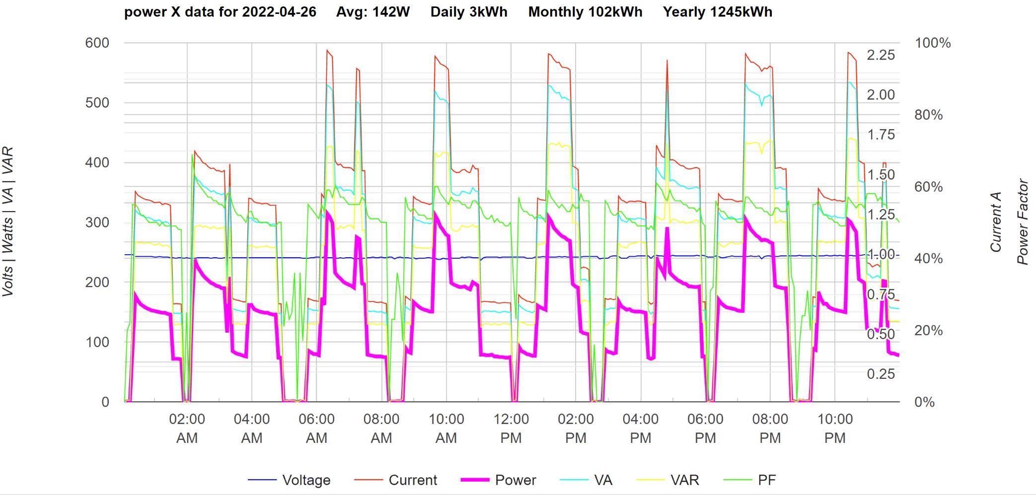

Radian Posted May 1, 2022 Author Share Posted May 1, 2022 (edited) Fridge/freezers are certainly good candidates for solar PV as their consumption peaks on the hotter days. They can even be slightly delayed/advanced to 'bank' a certain amount of energy before the Ice cream gets too mushy/hard. The gains would probably be fairly marginal from this approach though. Over a 24 hour period my fridge/freezers typically consume 3kWh (units) costing roughly £300pa at present rates: (amusing how all the three units fall into sympathetic resonance despite being in separate kitchen cabinets) While I couldn't justify the expense of replacing them with inverter refrigerators, my current units are fairly close to the 2.4kWh target I've set here so yes, an "islanded" 240VAC inverter could work out. Edited May 1, 2022 by Radian Link to comment Share on other sites More sharing options...
SteamyTea Posted May 1, 2022 Share Posted May 1, 2022 2 minutes ago, Radian said: Over a 24 hour period my fridge/freezers typically consume 3kWh (units) costing roughly £300pa at present rates: Have you thought about putting some EWI on the appropriate bits. Link to comment Share on other sites More sharing options...
Radian Posted May 1, 2022 Author Share Posted May 1, 2022 1 hour ago, SteamyTea said: Have you thought about putting some EWI on the appropriate bits. I suspect the biggest inefficiency is with heat transfer between the external condenser loops and the inside of the fridge. No easy way of increasing the insulation there I'm afraid. It would be fantastic if you could relocate the condenser somewhere useful e.g. laid flat on the floor under the kitchen cabinets, with a fan to provide a kick-panel heater in the winter. Link to comment Share on other sites More sharing options...

Radian Posted May 1, 2022 Author Share Posted May 1, 2022 1 hour ago, markocosic said: Who on earth designed these energy efficiency ratings? Clearly an idiot. If I were to replace my 25 year old fridge and two freezers with up-to-date units it would potentially reduce their annual electricity consumption by about 66% saving around £200 each year. Substantial, but at current like-for-like replacement costs that's only going to break even after 10 years or so. Better, I think, to see them until the end of their natural life - or mine - whichever comes first. 👻 Link to comment Share on other sites More sharing options...
