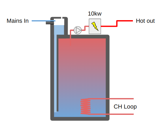

dpmiller Posted August 7, 2023 Share Posted August 7, 2023 Yep, the Heatstream is just a TS. I was aiming for one prior to Harlequin pulling them off retail sale, and had our TS configured in a similar fashion. The Heatstream looks busy on top because it's got the mixing valve and a filling loop all up there. It's manual-fill-to-overflowing, with an air gap above, and a nifty wee float indicator for the level. Plus a possible 3rd coil for an additional heat source. Bear in mind, all you that poo-poo the lack of stored volume of the HS or other thermal store, that here in NI a small cylinder with a Willis is absolutely the norm and people are used to the concept of charging and re-charging a cylinder with heat. A 6-9kW HP can do much more than a 3kW Willis Copper Industries also approximated the idea in their Maxi-Pod tank Link to comment Share on other sites More sharing options...

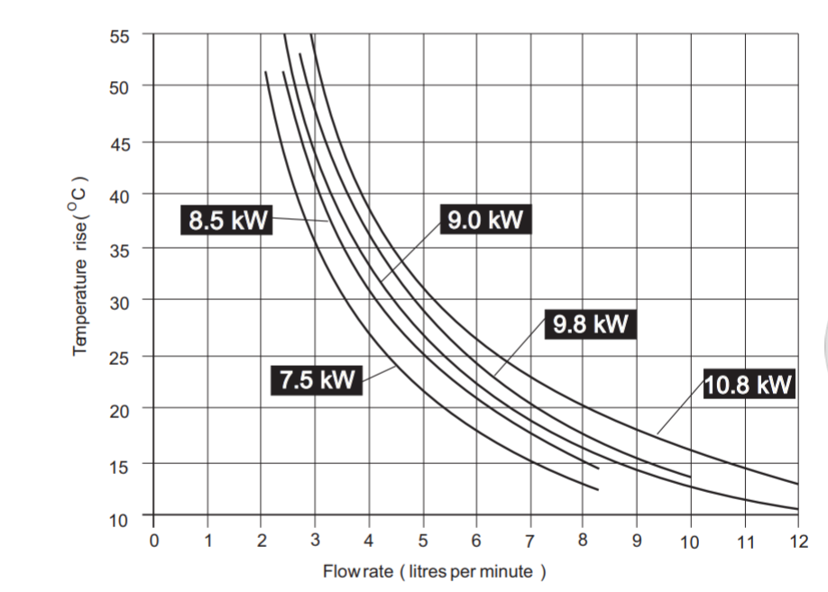

Beelbeebub Posted August 7, 2023 Share Posted August 7, 2023 The thing about Willis heaters (and any immersion heater) is they produce high temp water, so the effective volume of the cylinder is way higher when it delivers water at 45C. With direct electric there is no penalty for providing high temperature. 3kwh is 3kwh regardless of it being lots of 40C water or less 80C water at 100% efficiency. Electric tanks always store water at +65C So your 120l vented tank at 65C gives way more like 160l or 180l of 45C bath water. You can do that with a HP, but at a penalty. So storing at 45C is the lowest you can go, and your 120l cylinder that was ok on electric is a bit too small on a HP. (Except after the legionella cycle!) Link to comment Share on other sites More sharing options...
JamesPa Posted August 7, 2023 Share Posted August 7, 2023 (edited) 39 minutes ago, dpmiller said: Bear in mind, all you that poo-poo the lack of stored volume of the HS or other thermal store, that here in NI a small cylinder with a Willis is absolutely the norm and people are used to the concept of charging and re-charging a cylinder with heat. A 6-9kW HP can do much more than a 3kW Willis That's really interesting. I had begun to ponder some while ago whether differences in dhw practice might contribute materially to the UK VS EU disparity in heat pump deployment (obviously government vacillation and electricity/gas price ratios are the major contributors). You are now telling us that there is a potentially significant NI Vs England disparity. It seems 'we' 'expect' ideal DHW provision sufficient to allow two long haired teenage daughters and sundry other members of the family to shower each morning in quick succession for 10 minutes each. That's a level of luxury we have no right to expect, and regulations for all shouldn't be based on it. 'Teenage girls (or boys) block fixing climate change' is a headline I don't expect to see, but there may be a grain of truth in it nevertheless! Seriously though, is it possible that our dhw expectations are unreasonable relative to practices in other European countries/regions? Basically I am now concluding that the 5K subsidy is paying for MCS (about 1.2K according to one price list I have seen), a frequently unnecessary (with R32/290 heat pumps) DHW 'upgrade' and, sadly, in too many cases, price gouging, leaving a negative amount for the consumer. Until this changes heat pumps will remain niche and climate change will get worse. Edited August 7, 2023 by JamesPa Link to comment Share on other sites More sharing options...
JohnMo Posted August 7, 2023 Share Posted August 7, 2023 The Willis site is an interesting read, and the whole concept of heating water. You want a shower in half you flick the switch, willis heater add heat from the top down and you heat just water in the cylinder. We seem ok with with dumping 1.5kWh into the house in heat loss every day of the year to have a hot cylinder 24-7 on demand. Would suspect, the Willis heater used as designed would be very economical to run. Link to comment Share on other sites More sharing options...

Beelbeebub Posted August 7, 2023 Share Posted August 7, 2023 How about, storing water in a pressurised TS (basically a buffer vessel) at whatever the CH flow temp is, or maybe a touch above. Anything from mid 20's. This can also act as the buffer to avoid cycling and the defrost volumiser. Then via a simple coil you preheat the hot water circuit to whatever temp the buffer/TS can manage before sending it on to the instantaneous heater unit. If incoming mains is 15C and you want your shower at 45C that's a 30C rise or 3.5-5lpm But if you manage to preheat the water to 25C it's only 20C and you can achive 5-8lpm. If your buffer/volumiser is at 35C, then even you're talking 8lpm even for a weedy 7.5kw shower Link to comment Share on other sites More sharing options...
dpmiller Posted August 7, 2023 Share Posted August 7, 2023 then add a drain HE too Link to comment Share on other sites More sharing options...
