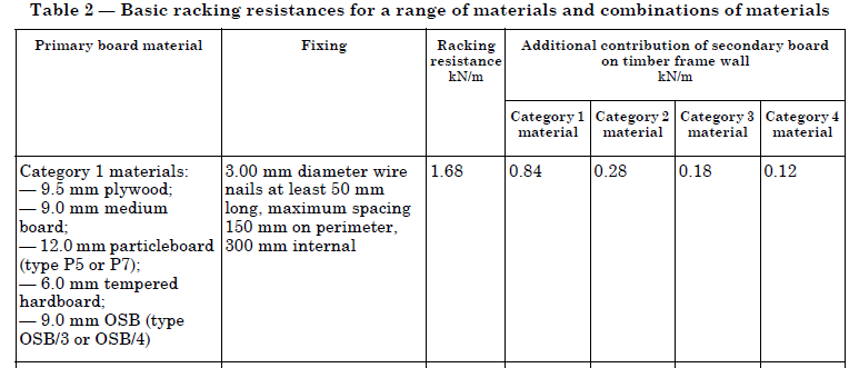

Gus Potter Posted May 4, 2022 Posted May 4, 2022 Hi Mike. On 04/05/2022 at 21:36, MikeSharp01 said: Other than thinking that a properly constructed Larsen truss is practical and therefore structurally OK I cannot comment further on them. Expand On 01/05/2022 at 06:53, MikeSharp01 said: Filling in with solid insulation between Larsen Truss or I-Beams is a pain Expand Depends what side of the fence you sit on if so inclined. It could be properly designed SE wise but no use whatsoever to folk on BH in terms of buildability / labour cost. Your bang on with it being difficult to fit solid insulation between I sections for example. Now your 50mm nail spacing on your racking walls? That I have not seen before but every day is a school day. It's interesting for me to see such close nail spacing. For example the racking forces are probably quite large.. so this will result in a fair bit of panel overturning effect, lots of uplift forces = plenty tying down straps and associated fixings. Also I'm curious as to how you SE has been interpreting the codes and taking account of what we call second order effects.. just nosey.

MikeSharp01 Posted May 5, 2022 Posted May 5, 2022 On 04/05/2022 at 22:01, Gus Potter said: Also I'm curious as to how you SE has been interpreting the codes and taking account of what we call second order effects.. just nosey. Expand Cannot say really - I just made it as exactly as I could to his (it was a him) specification. He did explain that the racking strength was fine longitudinally (Basically North-South) but limited cross wise so he wanted the cross walls to be really stiff and nailed as stated. We do have a reasonable amount of hold down straps into the passive slab to the upright I-Joists, the sole plate is also held down separately while each I-joist is also fixed to the sole plate with Strong-Tie angle brackets and screws. I will have a look at his calcs and see what the uplift forces might be - not much I suspect given the adjacent dwellings. We do have the 150 spacing on the longitudinal and roof boards. All boards are 15mm OSB 3.

Simplysimon Posted May 5, 2022 Posted May 5, 2022 On 04/05/2022 at 22:01, Gus Potter said: Your bang on with it being difficult to fit solid insulation between I sections for example. Expand perhaps, however, if you fit a stud at each end to your head and sole plate, then fit insulation prior to fitting a stud and work you way along it will be a lot easier. On 04/05/2022 at 22:41, Gus Potter said: I have copied, some info below. You can see in coulmn 2 the starting point for nail spacing internally and around the perimeter of the boards. Expand the nailing centres, does this take into account d4 glueing sheets to both sides of the stud and therefore the increased racking strength?
